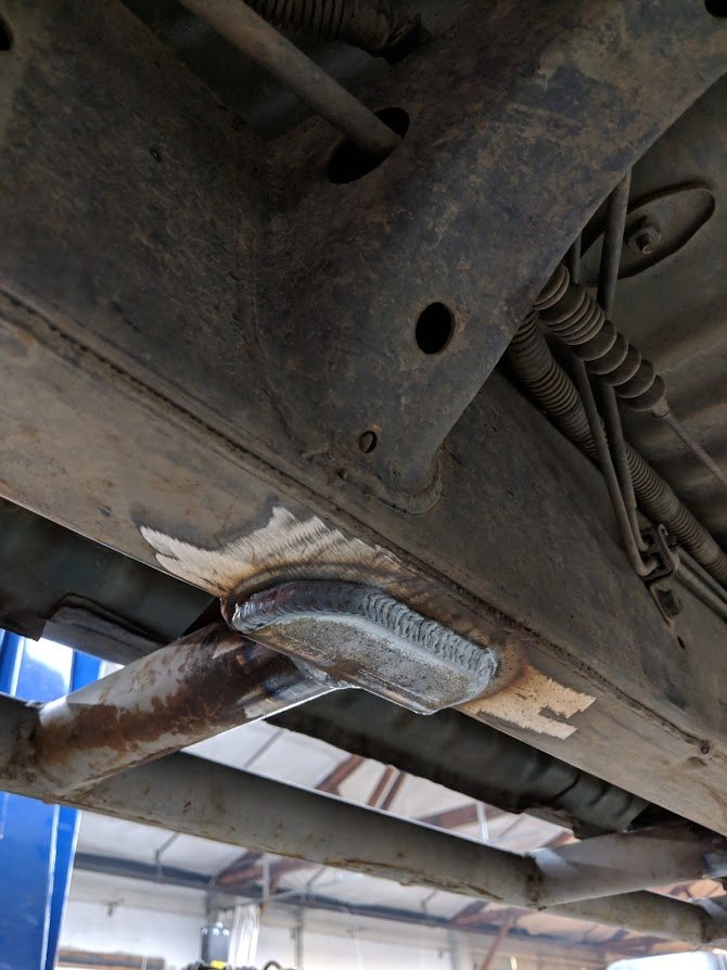

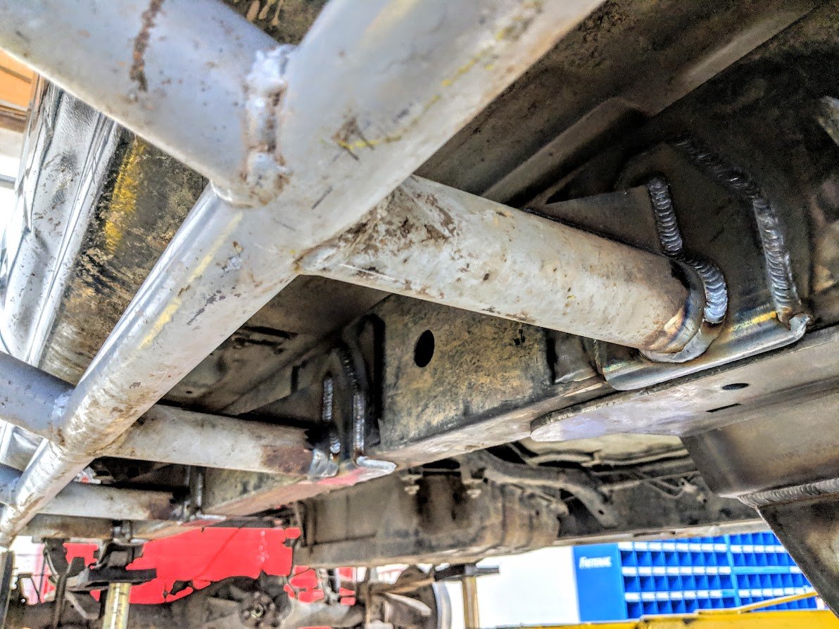

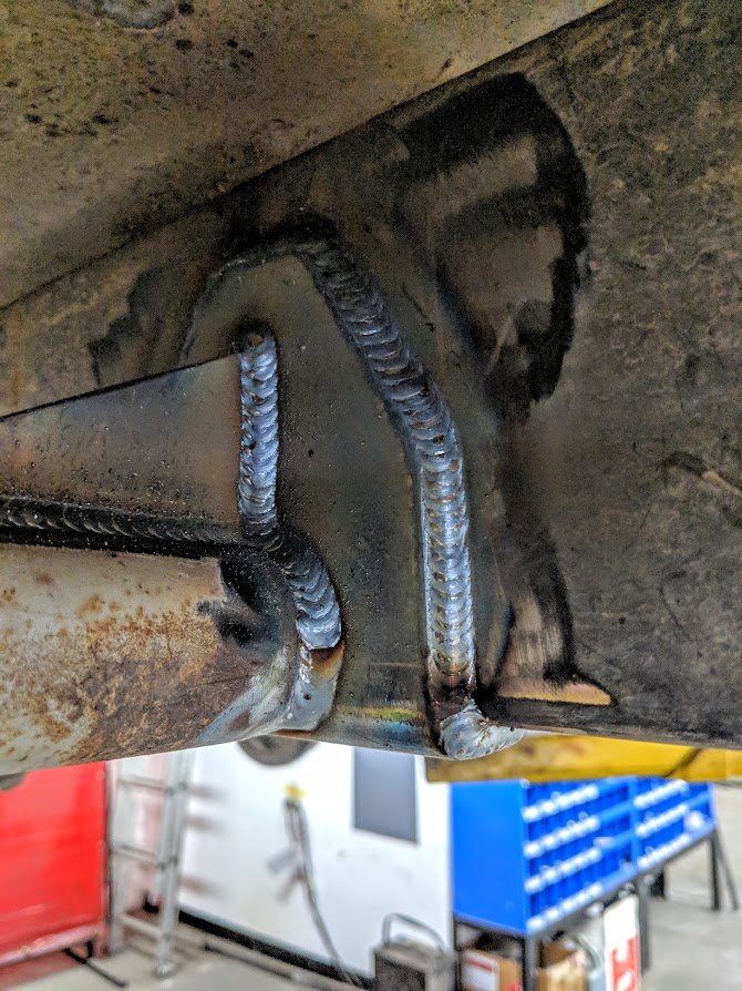

    You don't need the plug welds. I just installed a set of allpro sliders for a member and tehse were the first ive ever encountered with plug welds. I plugged them and welded the outside. Normally on my sliders its just a bent piece of 1/4" to wrap the frame. I do a 2" leg underneath and 4" along the sides. The 4" side I taper along the top so that its easier to weld around the whole plate as you'll find out a square plate is hard to get to the top unless the truck has a BL. Fitup will also be key to how well and easy the install goes. any gaps and the welds turn to poo. I like to weld the whole plate to elimate water getting and standing behind it. Ive developed a pattern that works for me when welding them on to not overheat any given area too much. I do one single pass and move to a different section of frame either same side or opposite side and basically just bounce corners
    These were re work. The guy had these welded to the truck with no plates or even gussets. so I fabbed his plates and chopped it all off and started over. he will replace the frame before these welds give out

    Those are some beautiful welds!

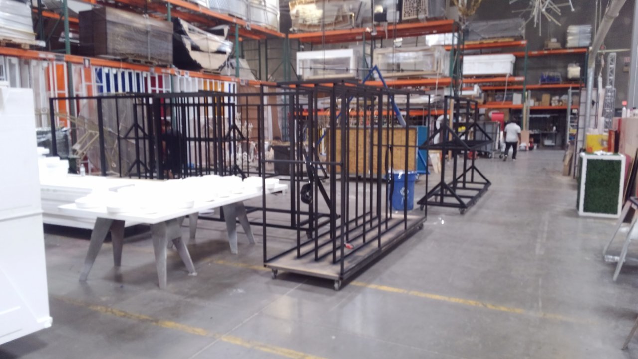

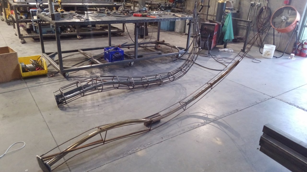

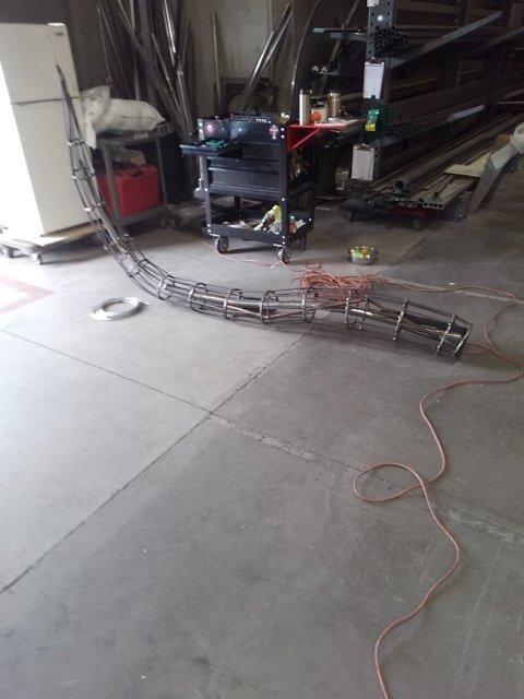

    Had to beef up / rebuild someone's version of art. Tusks from a wooly mammoth statue/art what ever. I guess it was at EDC and fell down. The tusks are 15' off the ground I am told.
    What was brought to me was simply something that looked like it was done by a drunk child and unsafe to be over people's heads in public. I had 18 hours into 2 of these things. Today I received a giant spool of 3/16 wire rope that will now get wrapped around the entire thing. I guess it is headed to San Francisco, then burning man.
    Some call it art, but when it ends up in my shop, I call your problem now mine.
    Cheers

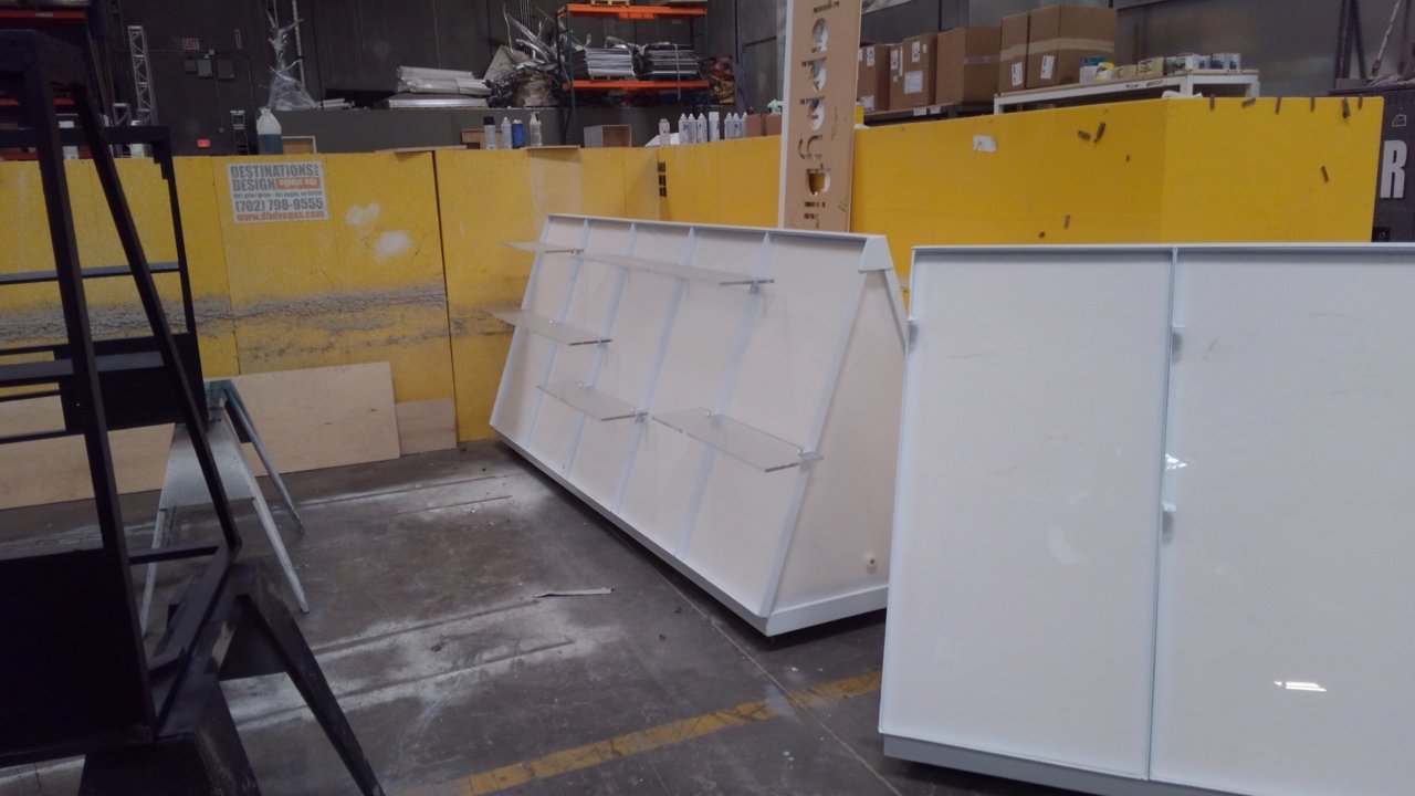

    The new gig does not pay well. $12.00 less per hour then I was making. But I like the people and the jobs are all different and plenty. I have been clicking 20 hours OT a week and could work more if I wanted . This past week I have been building lots if carts for the MGM hotel.
    Next week I have 3 Mobil bars for the pool at the Venetion, and I have a big pergala for the palms pool area.
    The company has a chef that cooks lunch everyday, that's nice, and they cover 2/3rds if my insurance. Lots if Arty type people. It's a hospitality type business. Everyone is nice .
    The welder they gave me is a older Lincoln 215, don't really like it, but it is what I was givin. There is a syncrowave 250dx, but no aluminum jobs have come down yet, so I have not played with it yet.

    I will post a pic of the tusks wrapped in the cable when they are done. That job has been put aside till next week.

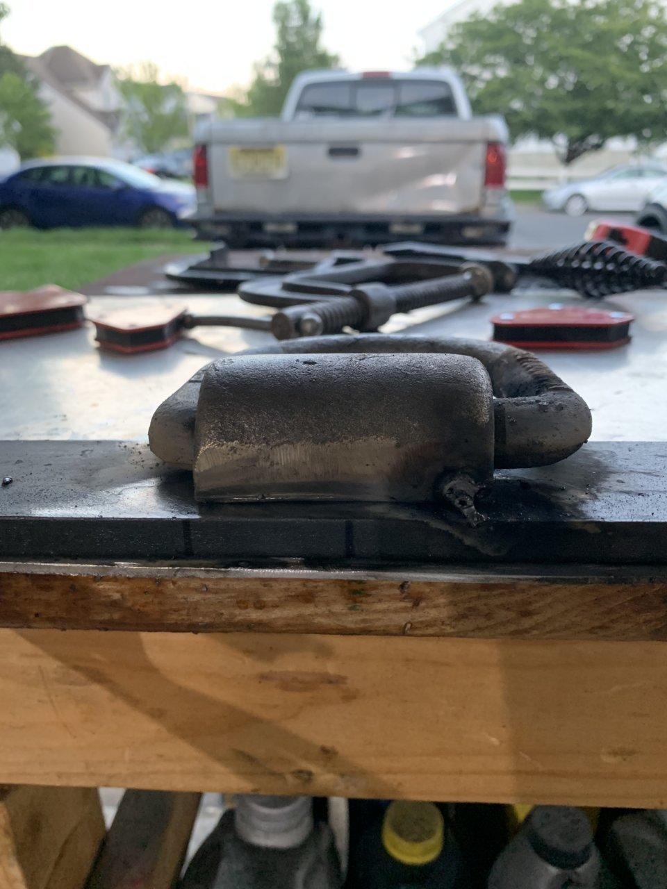

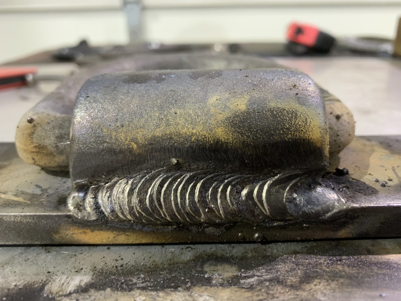

    Welded some 5/8 d ring onto 3/8 plate. Still no 7018 in the garage so I used 1/8 6011. Went nice and slow and it filled up nicely.
    Starting and stopping is hard to make pretty still. The other side wasn’t as pretty and I tried to use it as a 7014 test and it just came out ugly af.

  15. May 25, 2019 at 1:18 PM
    weldertaco
    weldertaco Mr.13%bodyfat
    Dec 16, 2014
    #144371
    13,299
    texas
    TrailRunner
    4wd to 2wd conversion
    Ight so ima stop you here.
    Do not weld something that will be used as a pull point with XX10 Rods. You’re asking for trouble.
    If these are just for coolers or something to be strapped down then rock on. But I would 10000% recommend just buying 5Lbs of 7018 and using those to weld on anything structural that will be tested.
    Will 60 work? Sure. But it’s risky. Especially with a new welder welding them considering 60 can look slick but crack like nothing.

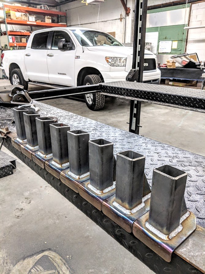

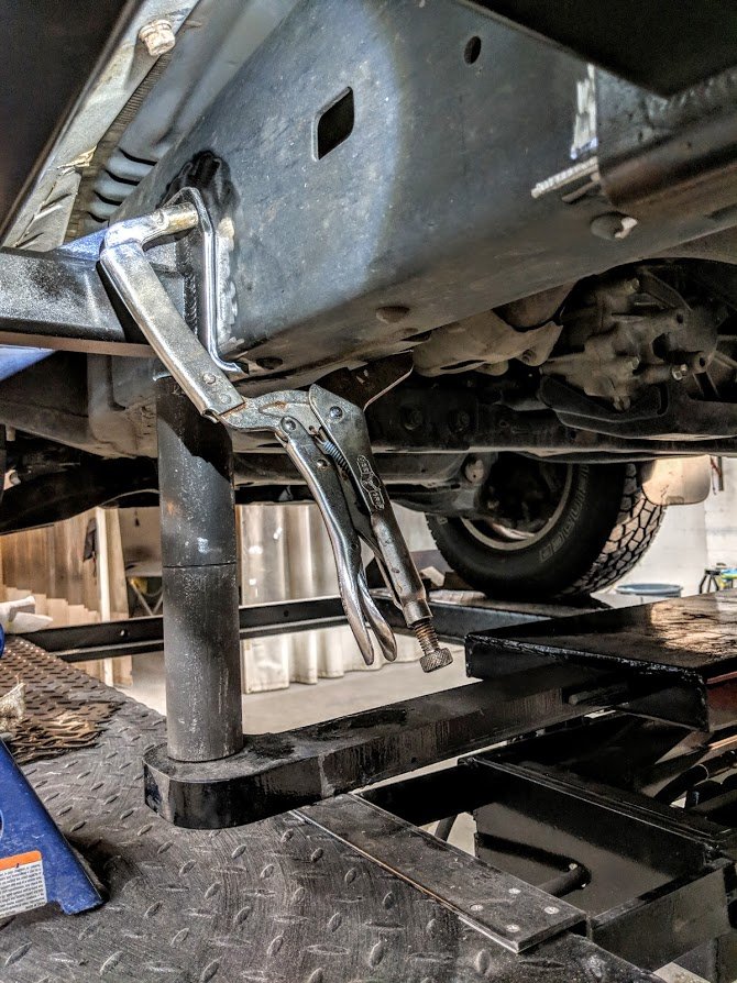

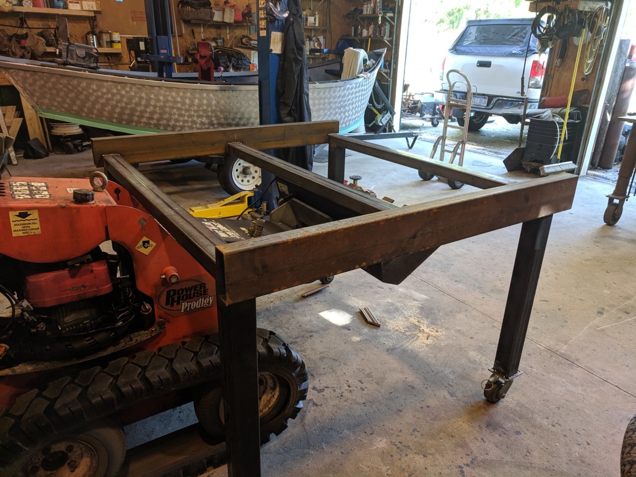

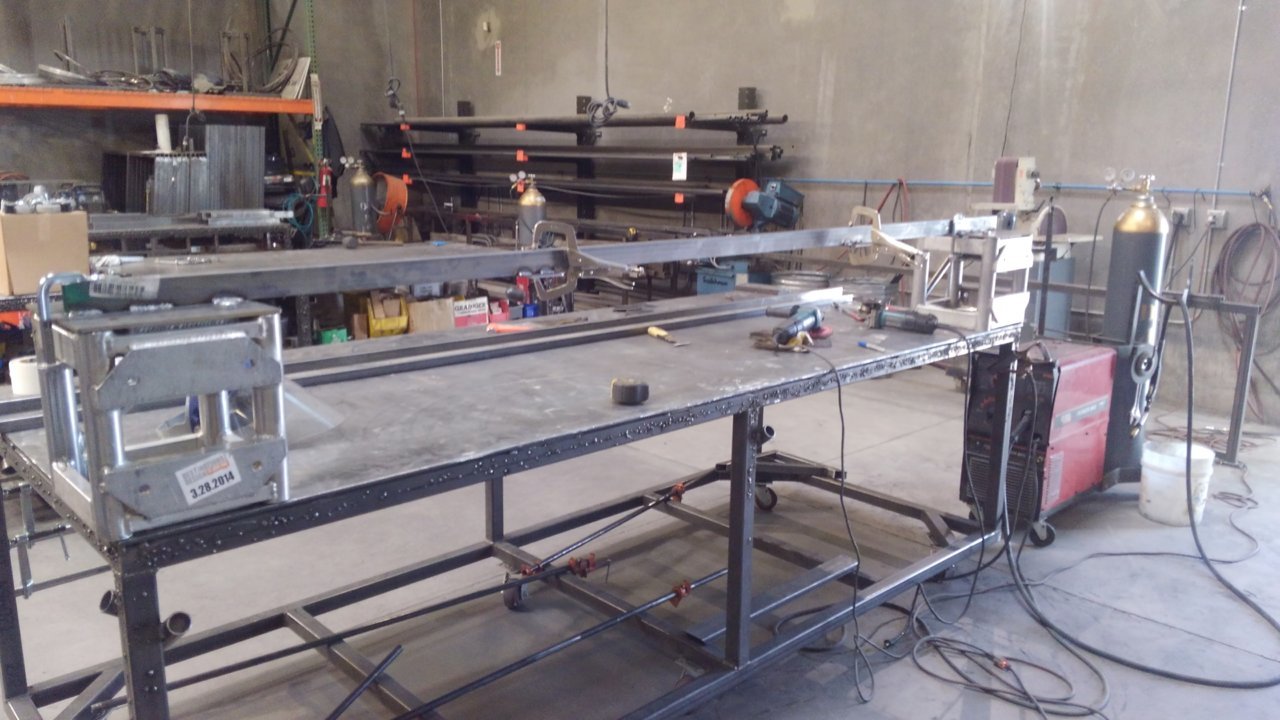

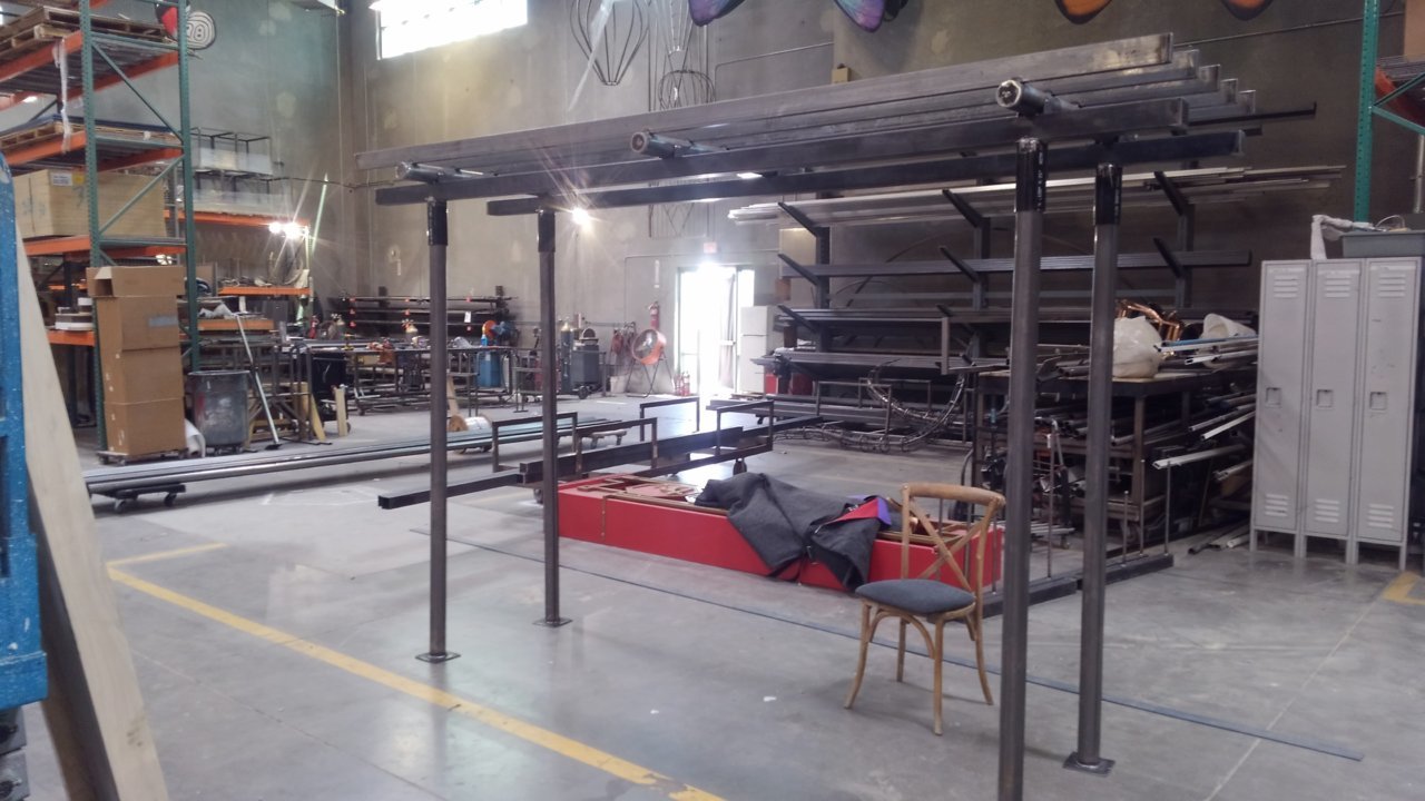

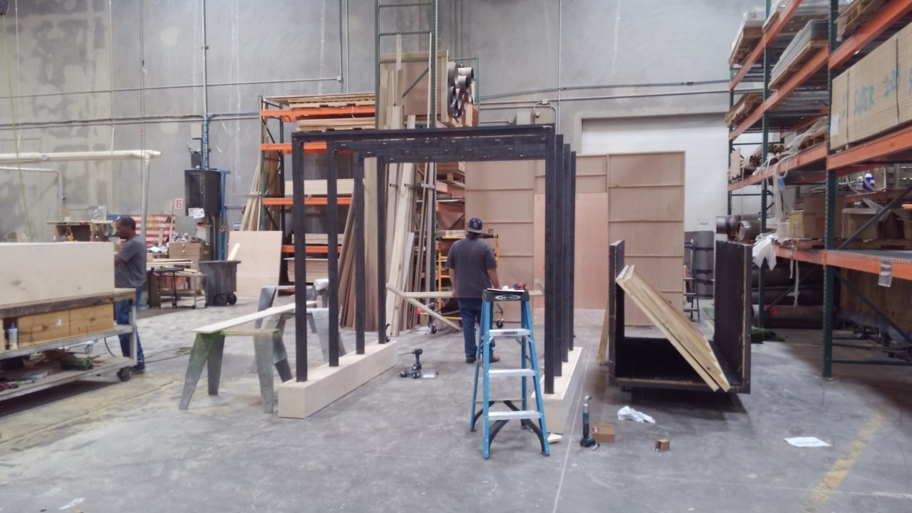

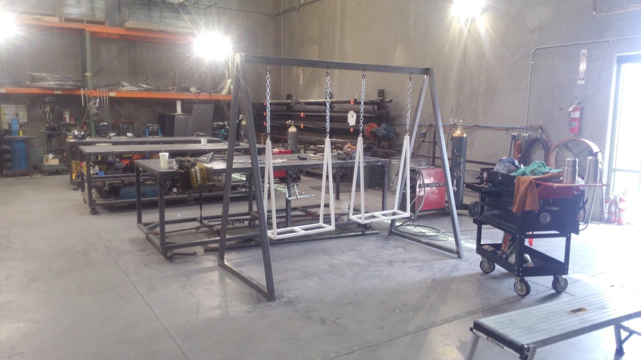

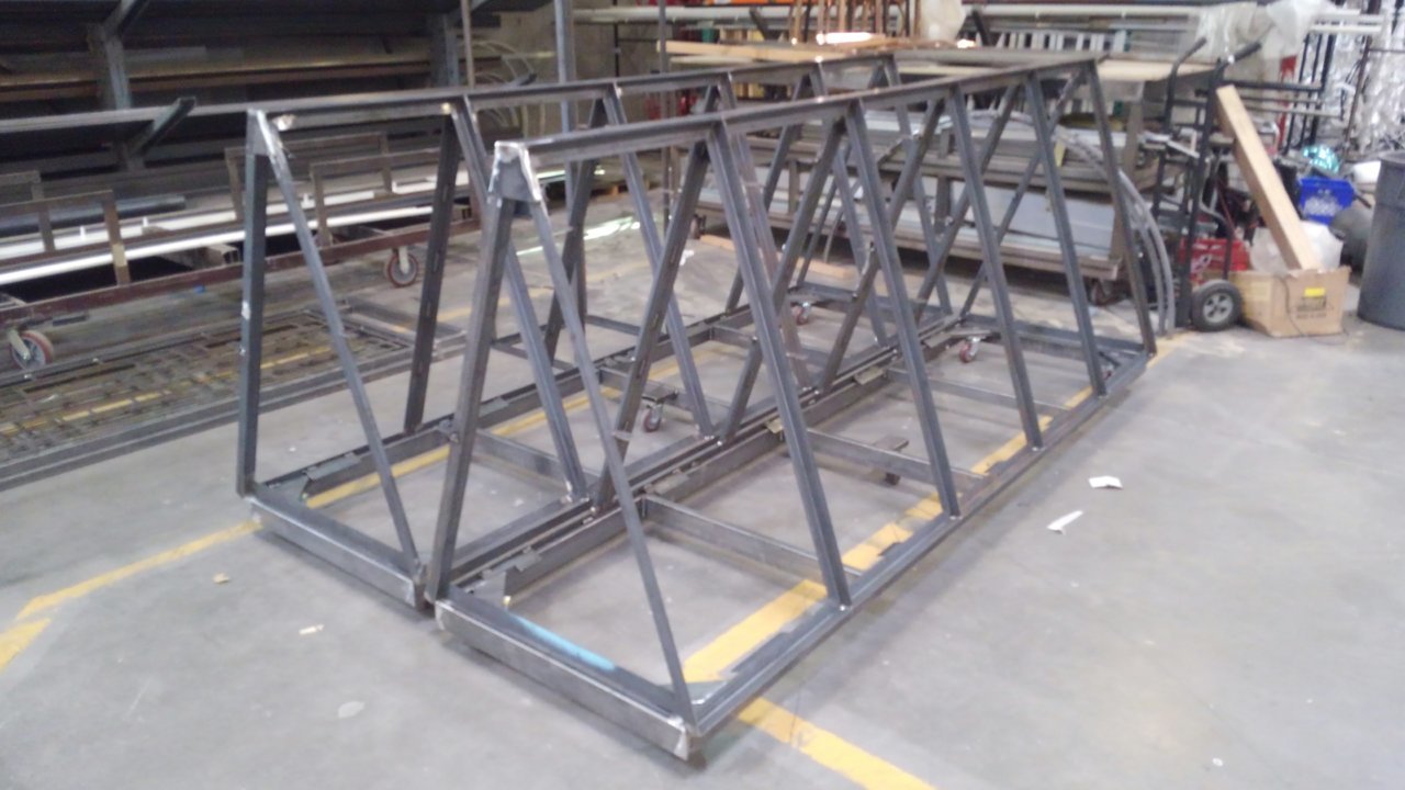

    This was what took up my time this week.KIMG0826.jpg KIMG0828.jpg KIMG0827.jpg KIMG0829.jpg IMG_20190522_094439.jpg
