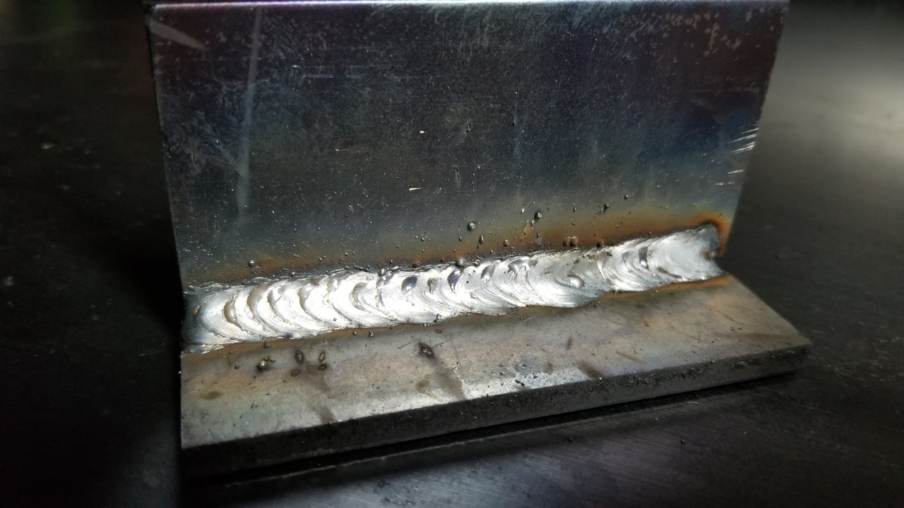

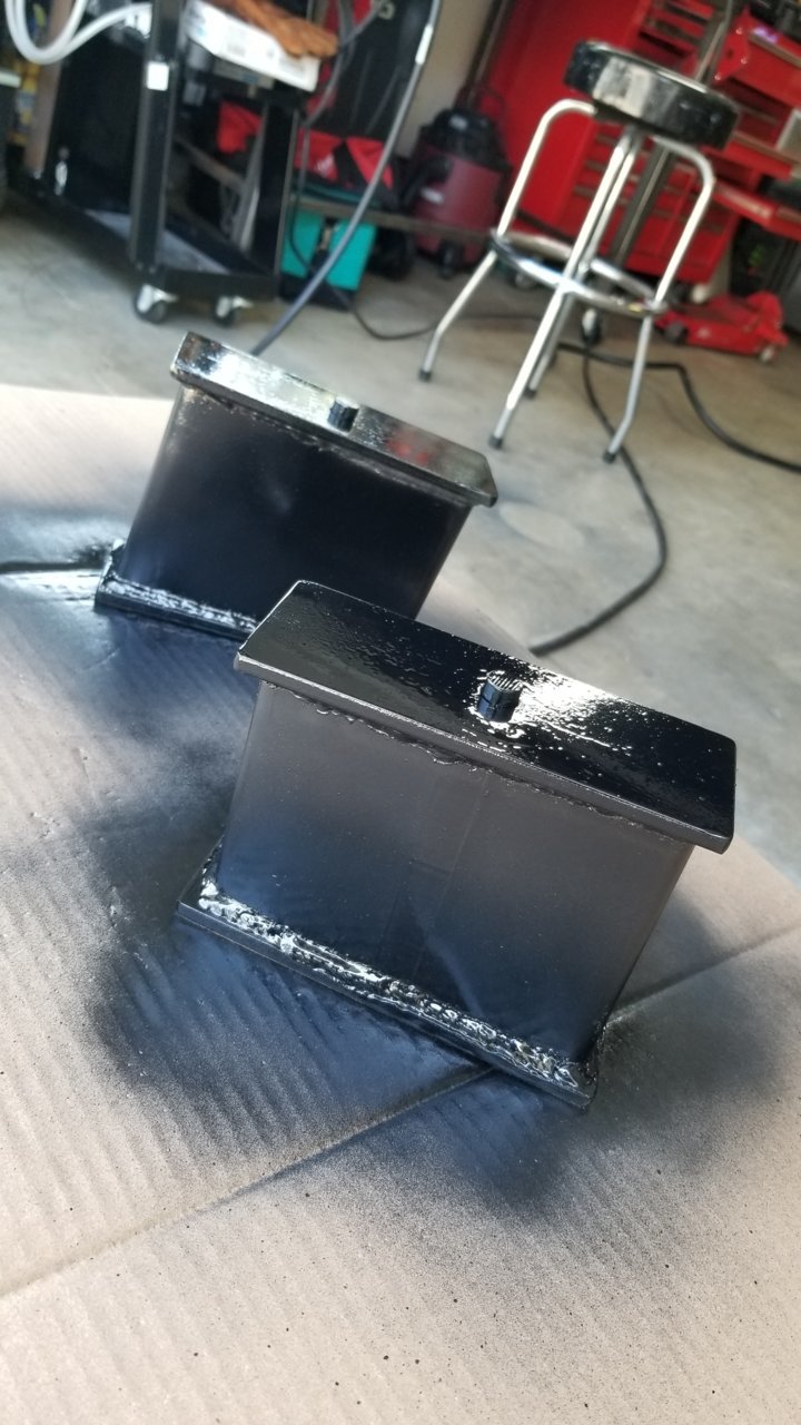

    Practice weld on some 1/8 to 1/4 plate. Same sizes as the blocks I'm gonna make tomorrow.

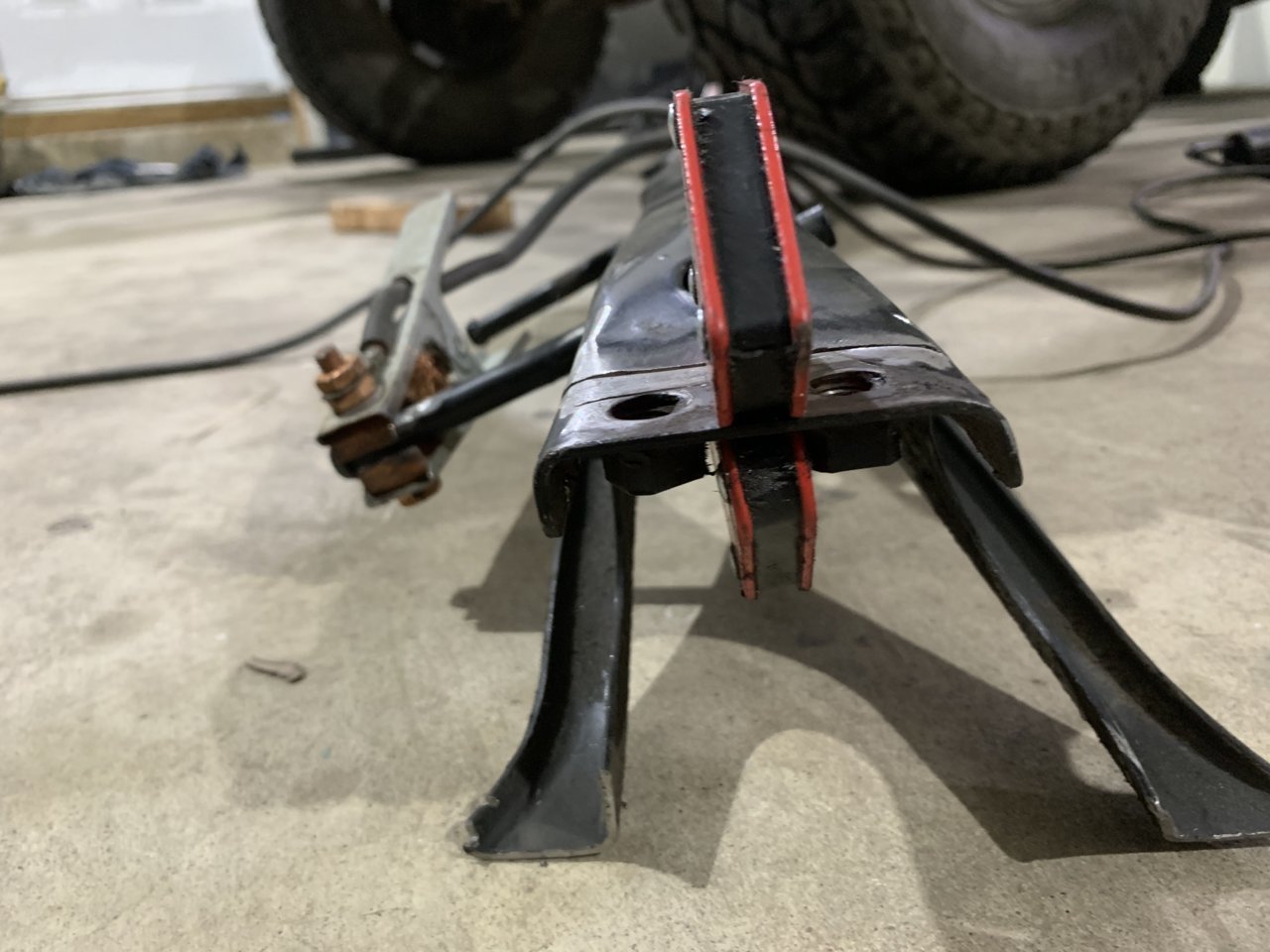

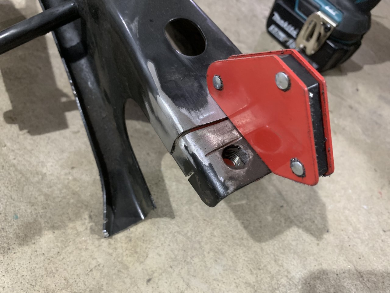

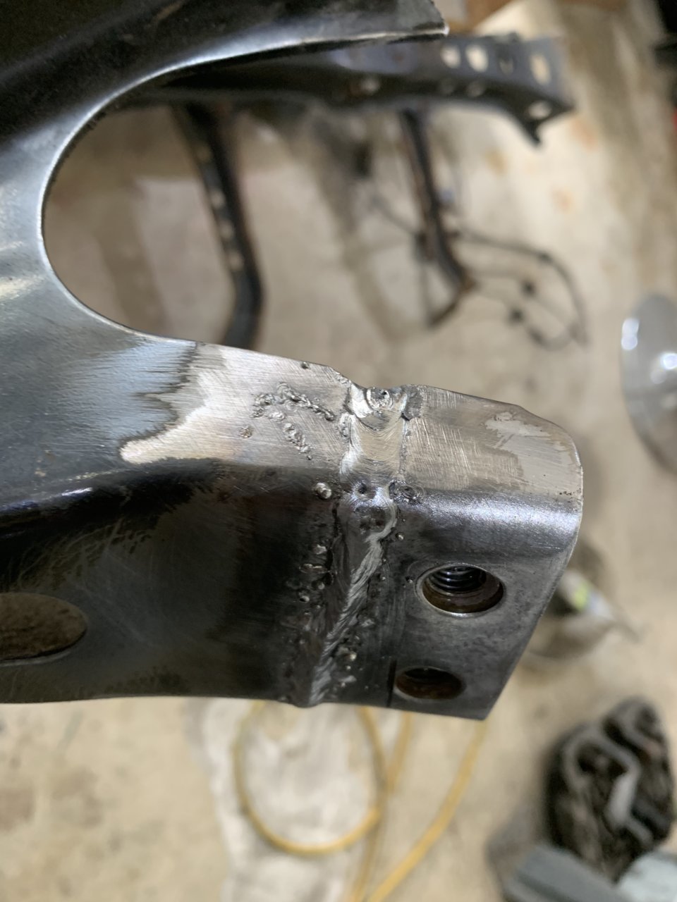

    Drop bracket lift and booger welds

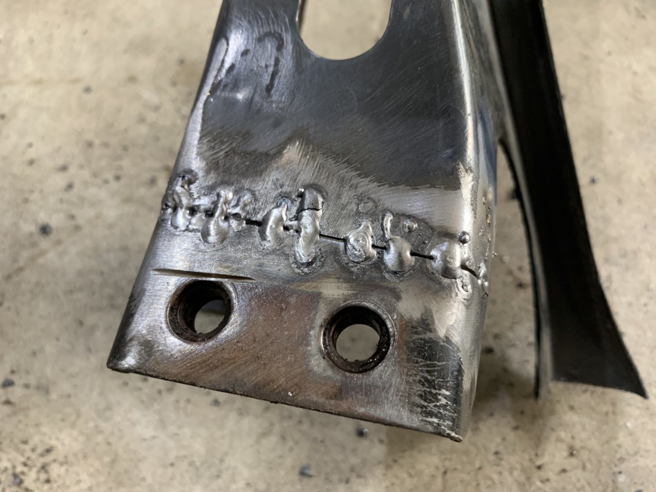

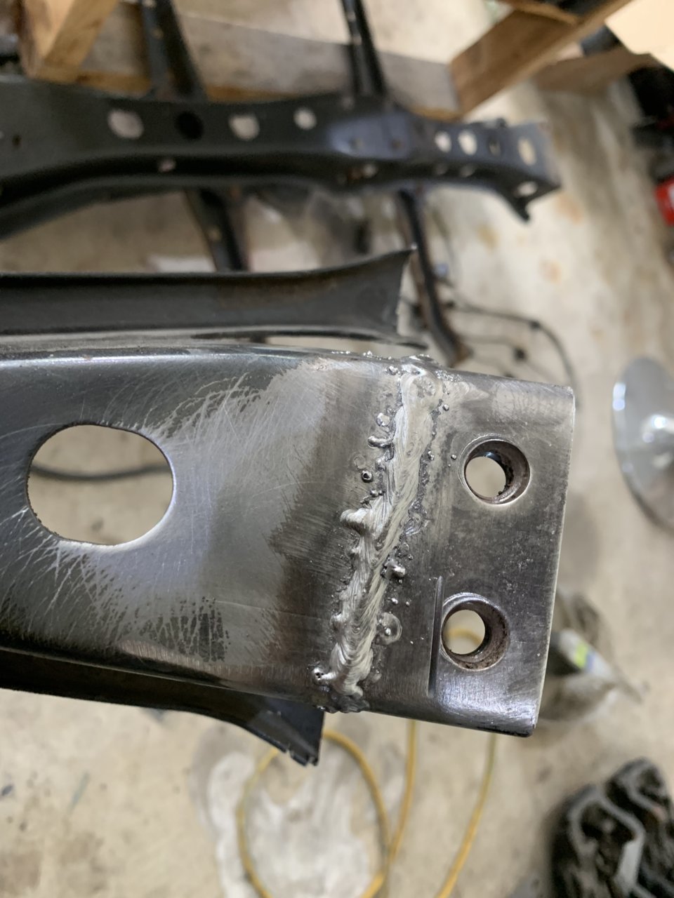

    Welded the thinnest stuff I ever did with stick so far. Not sure if this method is a good way to do it or not, but I basically did stitches over the gaps on both sides before I went over the entire gap.
    It was a fun challenge. Can you guys believe how thin the metal is on the frame crossmembers? :eek:

    Looks great! Once the paint and under coating gets applied, no one will notice...even us welders.
    It's a quality weld. Move on and never think about it again.

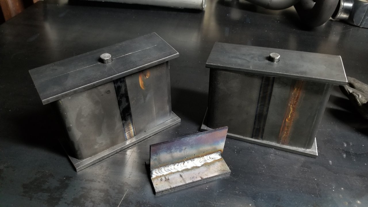

    Blocks are done!

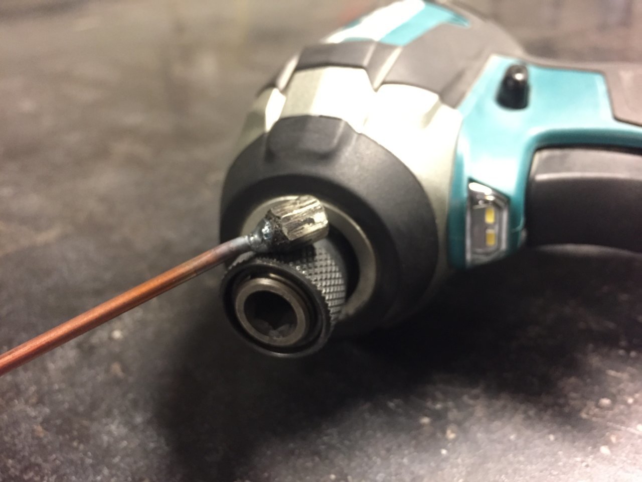

    Removed a snapped and stuck 1/4” bit from a tool. Cannot beat tig for this kind of stuff.

    Absolutely mother effin genius! I’m gonna try that tomorrow on my Dewalt impact! Thanks

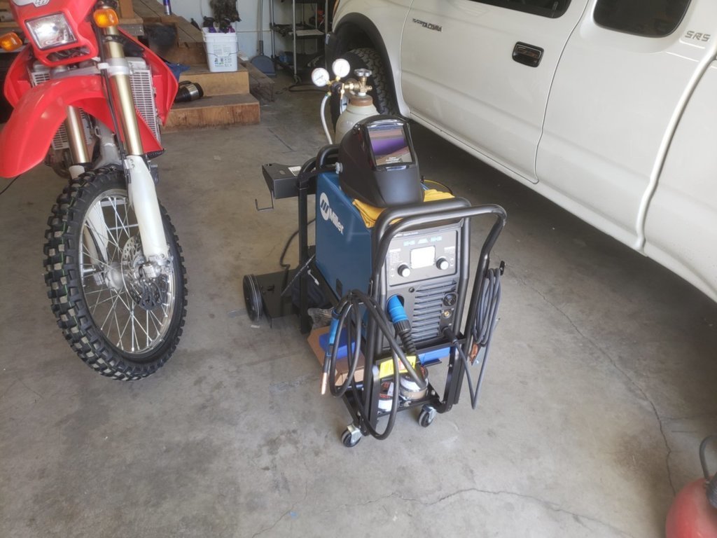

    Does anyone have a welder that does it all? IE a Lincoln electric le31mp

    I recently picked up a Miller Multimatic 220 (GMAW/FCAW/GTAW/GTAW-P/SMAW). I haven't picked up an Argon cylinder for TIG, so no comment on that yet. Been pretty busy with other projects and haven't been able to use it as much as I'd like. Planning on getting it fully set up for TIG in the next week or two, will let you know how it works...

    If your only looking to do DC Tig not a bad package since everyone wants Aluminum Tig not so much
    140 amp machine with a spool gun for aluminum allows 3/16"
    As this is a new product I am sure some bugs will need to be worked out.

    I also have the Miller 220. Worth every penny. I’ve tried all the process beside stick and they are do as advertised. Also very user friendly. Highly recommend this machine.

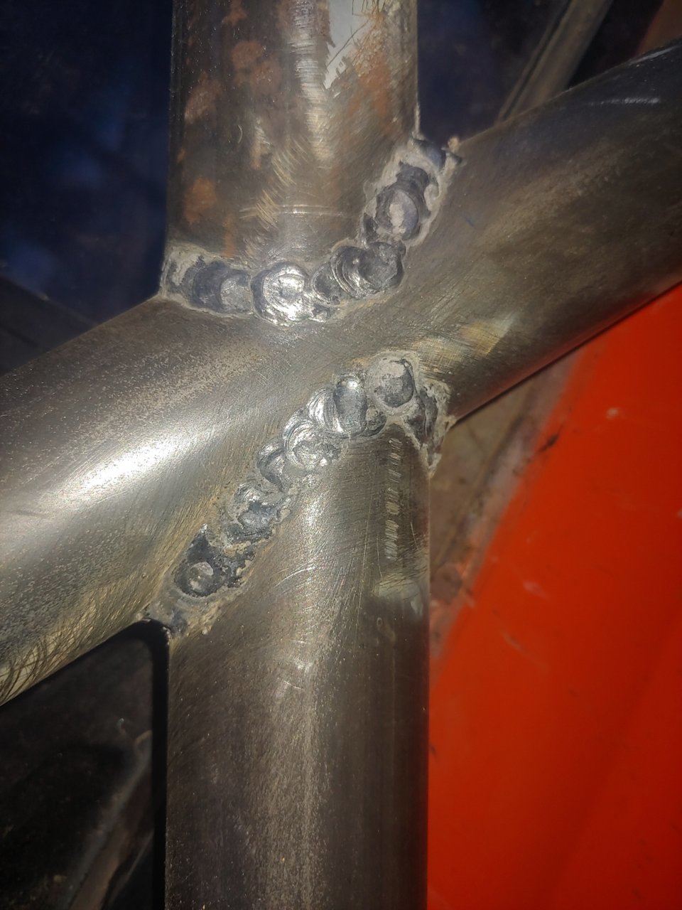

    First time welding tube together. Where the figment was good the welds look pretty good. Quickly learning that the welding is the easy part of all this haha7AA22BA9-78E3-4ED8-A72B-249151D1C2B3.jpg
