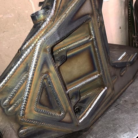

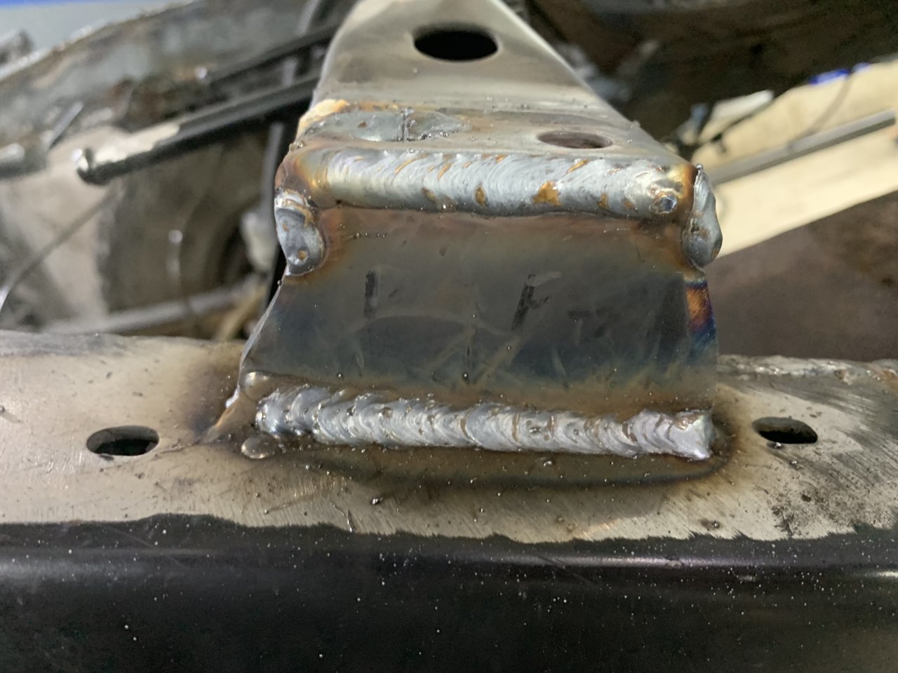

    Just finished welding my frame plates and my raised gas tank crossmember. I had a lot of welds, mostly gross, some nice, and I am proud of these two.

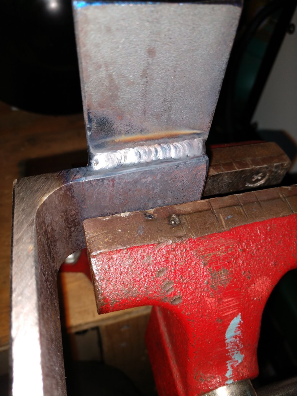

    1,356
    Json
    TMPE AZ
    05-SWB-DCSB-4X4-V6-SR5-SPORT
    NO SWAYBAR, Spacer lift with dirty4's
    IMO Mig welding is meant to be completely smooth, "Dime Stacking" is a TIG welding result. In some of my pictures you will see a partern in my welds but its for the fact I was doing production and had to move fast with lots of heat and wire to get parts done or had lots of different gaps and had to make it look good and get it burned together.. when i see "dime stacks" for mig welding it screams "i don't know what i'm doing"...

    Very interesting opinion
    Whoever welded this definitely doesn’t seem like they know what they’re doing o_O

    thats pattern welding.. not trigger pulling.. once again the "dime stacking" mig welding its pull the trigger and stop, pull the trigger and stop.. this photo you posted is fast whipping

    yes, this is what im talking about... this says "stop and go" all over it. you can tell it had been wire wheeled to shit since it had a lot of spatter

    Just so everyone is clear on this, that's not the technique I used to produce the weld in that picture.
    It is one continuous weld non-stop, drip, drip, drip, drip, drip. This is what produces the stacked dime effect, for me anyway.

    Also that's the weld as-is, zero clean up afterwards.
    The technique I use is so clean there might be couple pops (weld splatter balls) during the entire weld. It's very quiet during the weld just the hum of the machine, it's very TIG like.

    Its all personal preference. Actually, in my structural Tig class I was told that dime stacking yields a weaker weld. Laywire tig with a nice weave motion gives a much flatter, stronger weld. IMG_20190609_170047667.jpg
