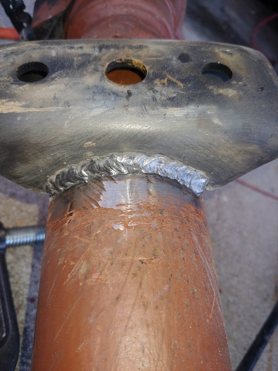

    I can't explain it as I have no idea what I'm doing, no formal training what so ever. I just stumbled on to this technique from over 10 years of trial and error practice.
    The technique works and looks great but is entirely dependent on a couple things, max temp, extremely slow wire feed, slowly pulling the weld as it drips, and the weld area absolutely has to have gravity pulling the pooling drips directly down.

    :bananadance: you got it that's exactly it! How did you know about that? Professional welder?

    typically people dont do spray arc at home, its a structural heavy duty welding process, like 21amps @ 330 wire speed and the machine sounds like complete shit and the welds do come out smooth still

    I did it with my old 115 amp mig machine. Until I switched over to a quality flux core wire. Much faster, with the same heat output.
    Also, Sprayarcing at such a slow wire speed makes it hard to weld anything thats not sitting flat on a table. I can pull a Tig bead uphill much easier than I can a mig bead, so thats ultimatley what I switched to.

    I stumbled (trial and error) on to the technique trying to weld 1/4" plate with my 120V welder. It worked so well and looks so good I just weld everything this way now :D.

    Exactly what I experience trying to use this technique. I can guide the drips along but gravity pulls them straight down. The area I'm welding has to be perfectly flat to the ground. It's refreshing having a professional explain what I'm seeing under my pure observation alone.

    Technique is a little inconsistent, but overall it looks OK. I dunno if I would burn my entire truck together with a 120 amp machine though, like it or not, there are a ton of limitations to those machines.
