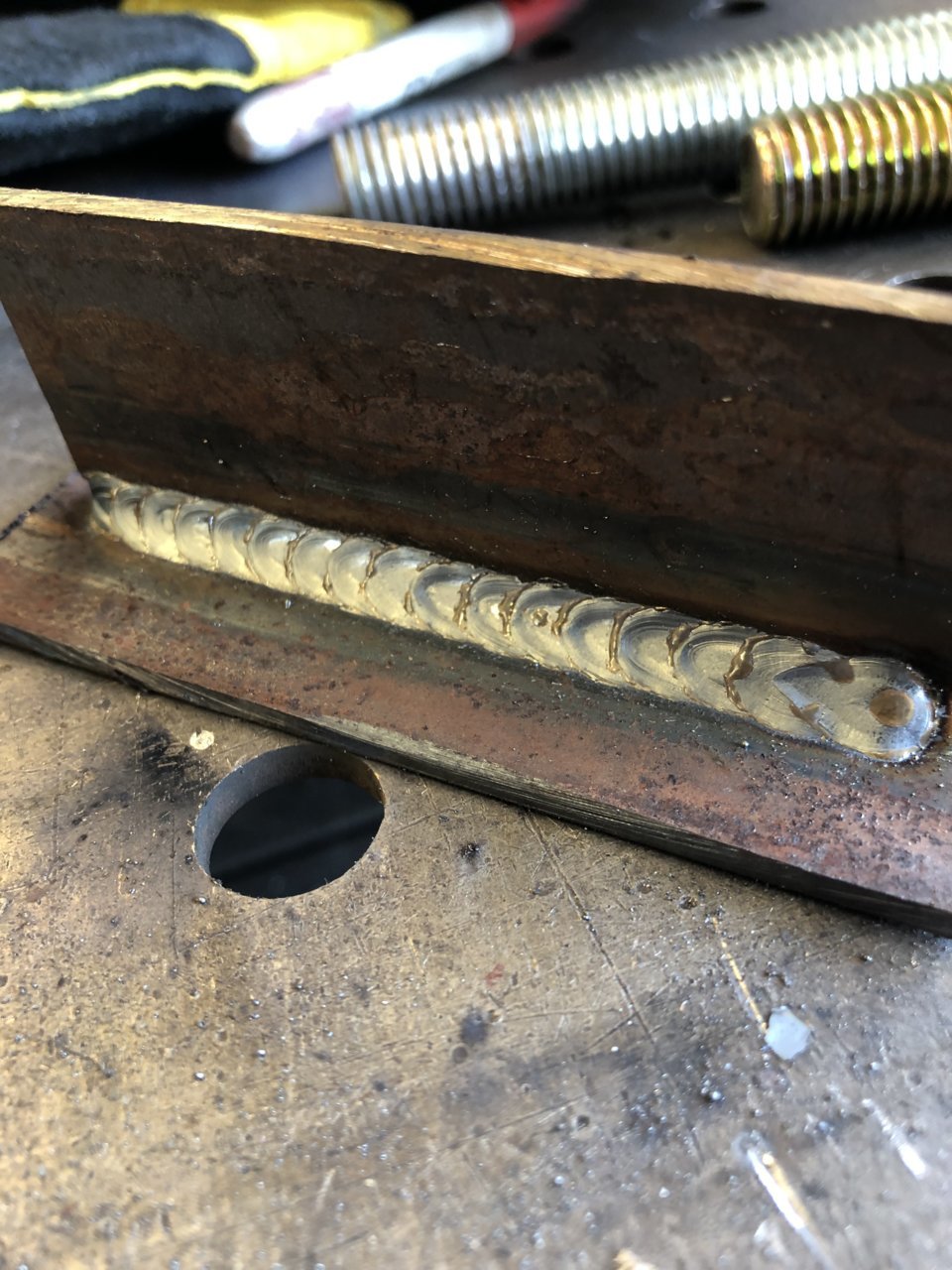

    either way melting metal is cool shit, unfortunately a lot of variables surround the process and the only real way to know how good it is, is having it tested. aesthetics isn't an acceptable inspection method as i've seen my pretty welds break.

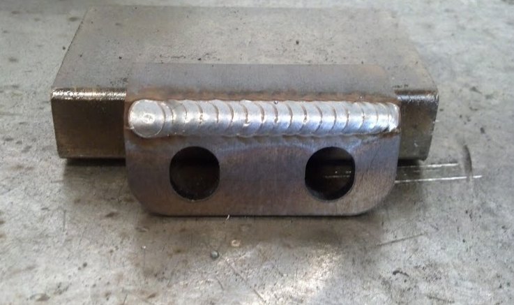

    You can stack dimes with a mig welder that doesnt involve 400 tack welds. When I weld real thick stuff I like to weld pretty hot, and carry a pretty wide bead at about a half inch across or more. Using a large cursive e pattern yields a dime like effect. Literally did this yesterday, should've grabbed pics.
    This not so great pic of my rear bumper will have to do. That was .035 wire run at 24 volts, right on the verge of a spray arc. 0525181056.jpg

    Here’s my “whip it” which is the technique I use most

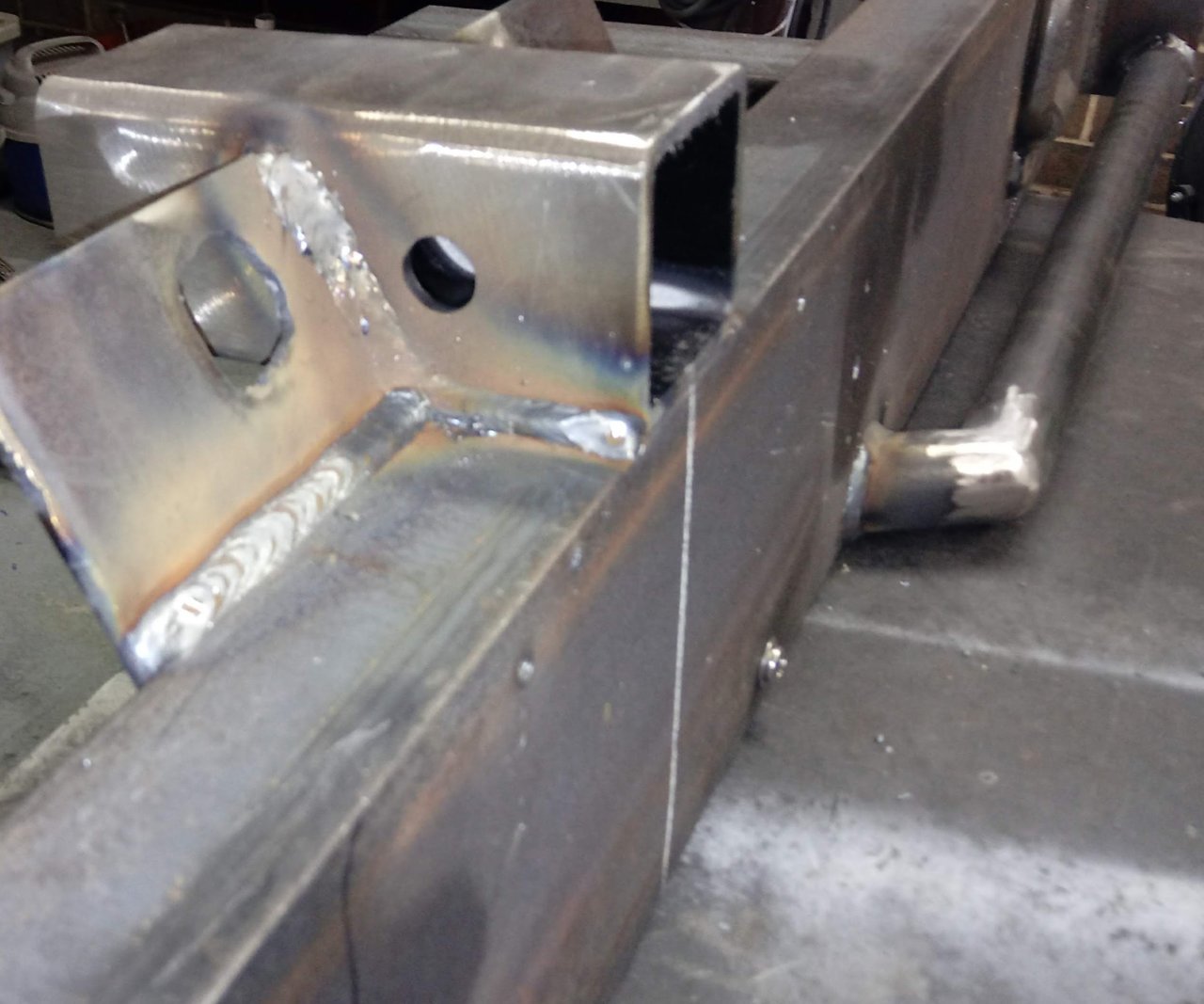

    if you cant wrap 180* around .080 1-3/4" down hill with dimes like this, you're not a true welder

    I have such a hard time with those 180 degree welds. Because of the movement and angle change throws me off and freaks me out.

    yeah, imagine welding this up, all the welds you see from this point had to be 180* wrapped & uniform (lets say one side had a large cope gap, i had to make the small cope gap side match so it'd get a bigger weld than necessary

    Yeah the gap. I need to work on my notching also. Got my tank of c25 a large cab of Pam and some l56 .030 wire gonna start practicing today. For the next part of my exo

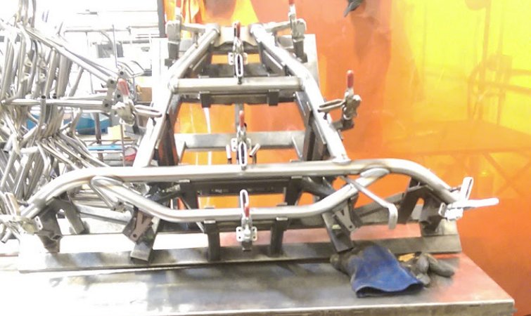

    So who got to make the jig?
  20. Jun 18, 2019 at 4:24 PM
    wheeliest
    wheeliest ///////////////////
    Feb 3, 2016
    #177066
    1,356
    Json
    TMPE AZ
    05-SWB-DCSB-4X4-V6-SR5-SPORT
    NO SWAYBAR, Spacer lift with dirty4's
    R&D dept.
