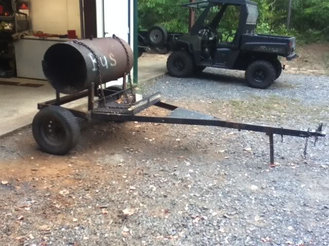

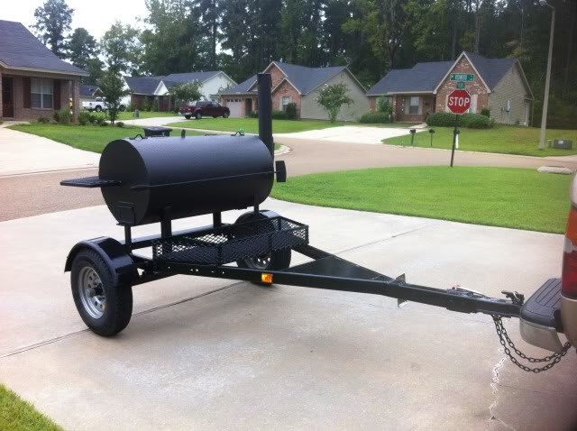

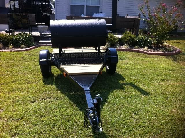

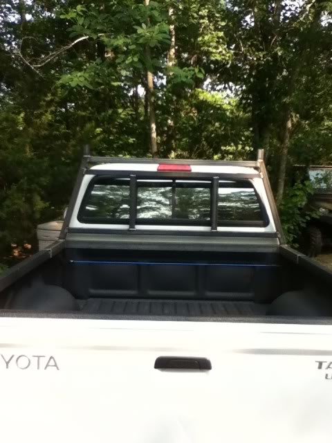

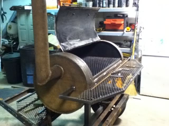

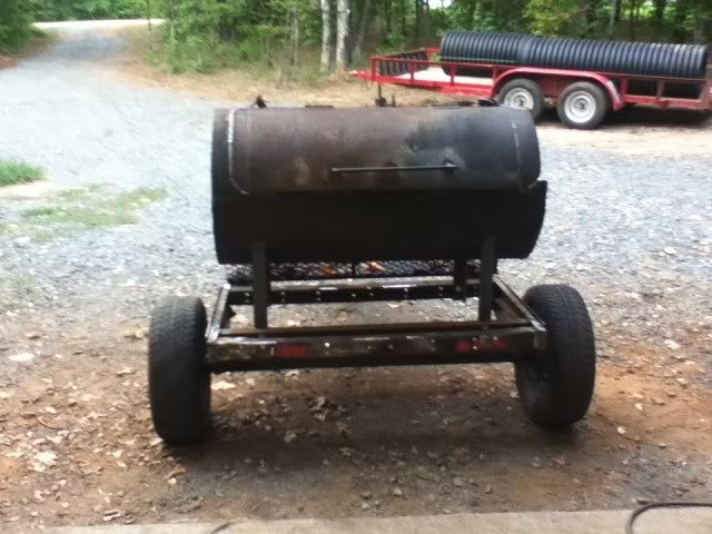

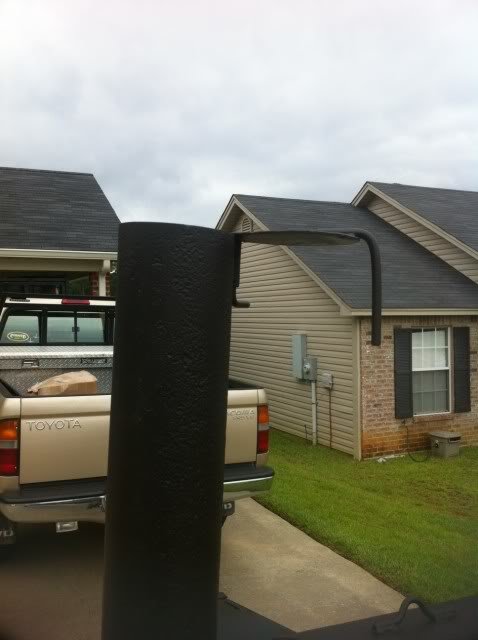

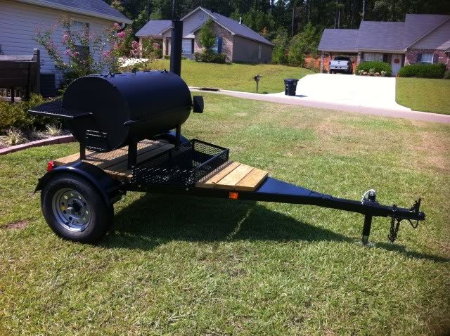

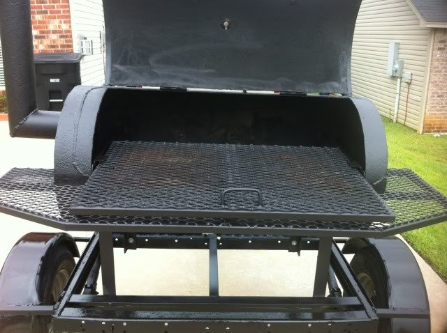

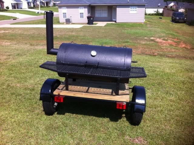

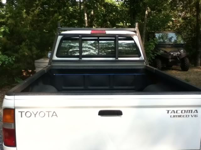

    Nothing special, built a headache rack for mine and my dads Tacomas. Also, a BBQ trailer I built I am currently trying to sell. Then another BBQ pit with a smoker.
