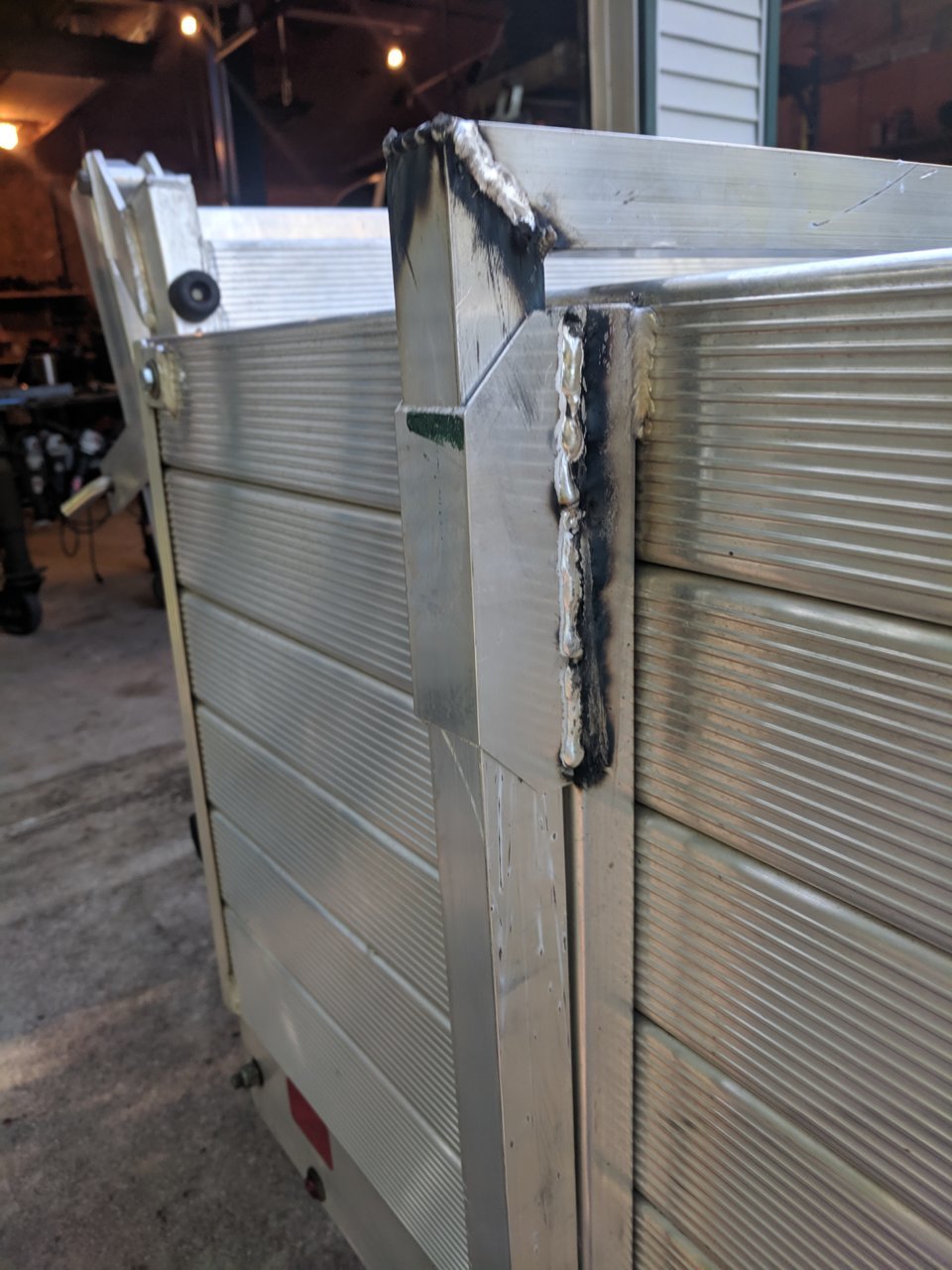

    I just got done with a quick project myself. Customer wanted cross bars for his utility trailer so he could haul kayaks.

    Let's see if I can post pics.IMG_20190629_183134.jpg IMG_20190629_183143.jpg IMG_20190629_190805.jpg IMG_20190629_192014.jpg IMG_20190629_191958.jpg

    Yes. I was in a hurry. I should have noted that.
    MM30A spool gun. Very fast and does a pretty decent job. Not as good as TIG, but I'm done and into beers so I call it a decent compromise.

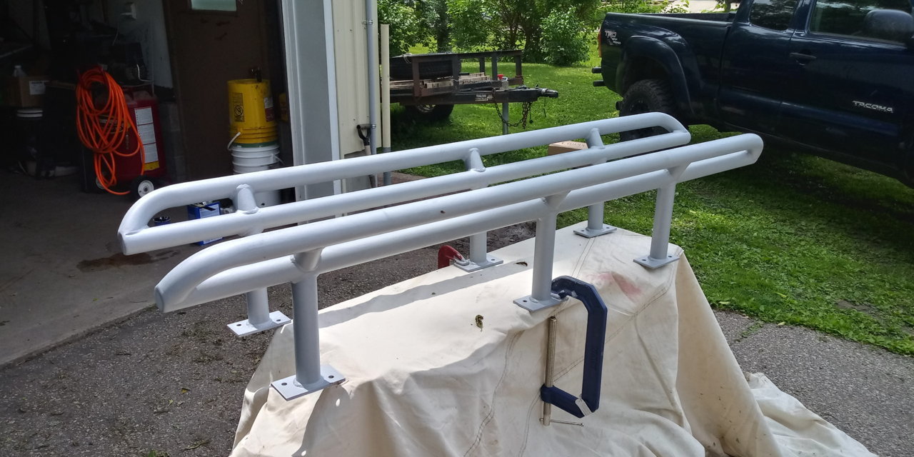

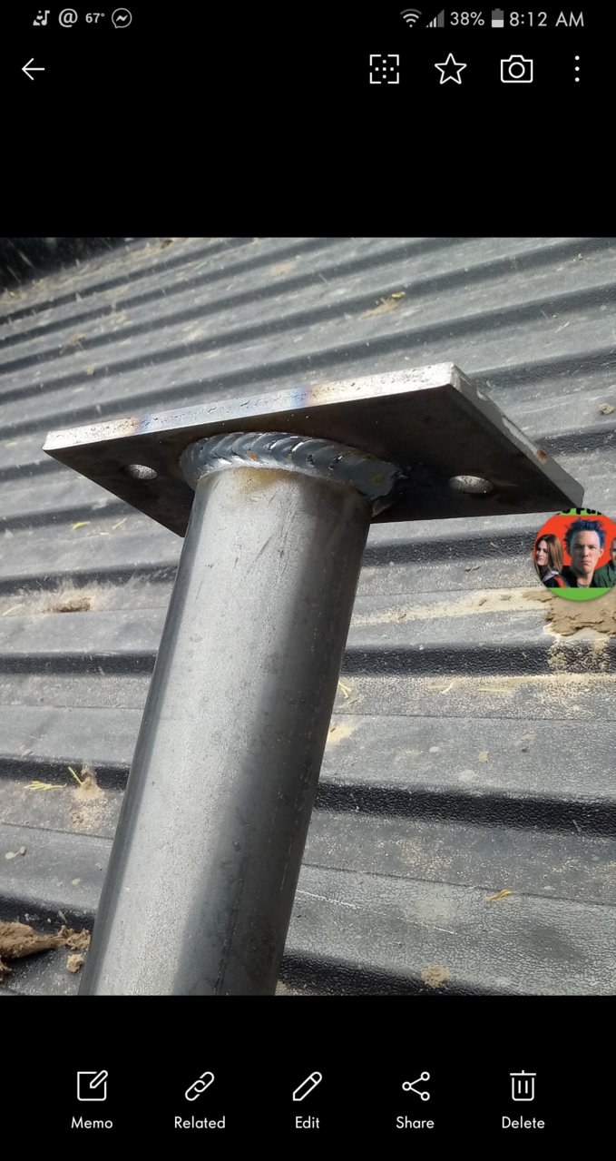

    I made some rock sliders for my truck out of 1 1/4" sch 40 railing pipe.
    Base coat primer: diamond vogel - endura zinc 703
    Top coat: sherwin williams - acrolon 218
    I dont have pics of the rest od the welds on my phone anymore but as i welded each side of the pipe joints id do then right right handed and then left, left handed.
    I will try to remember to get a pic of my left and right hamded welds this coming week.
    The ONLY thing these need still is some angle brackets bon the inside of the frame to make them able to take lift the weight of the truck.
    Im pretty happy with them regardless - its not a rock crawler.

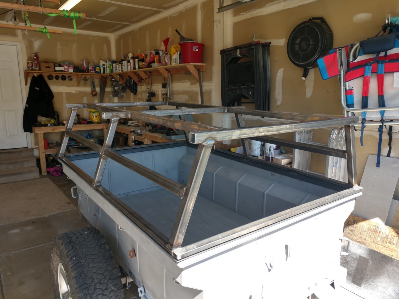

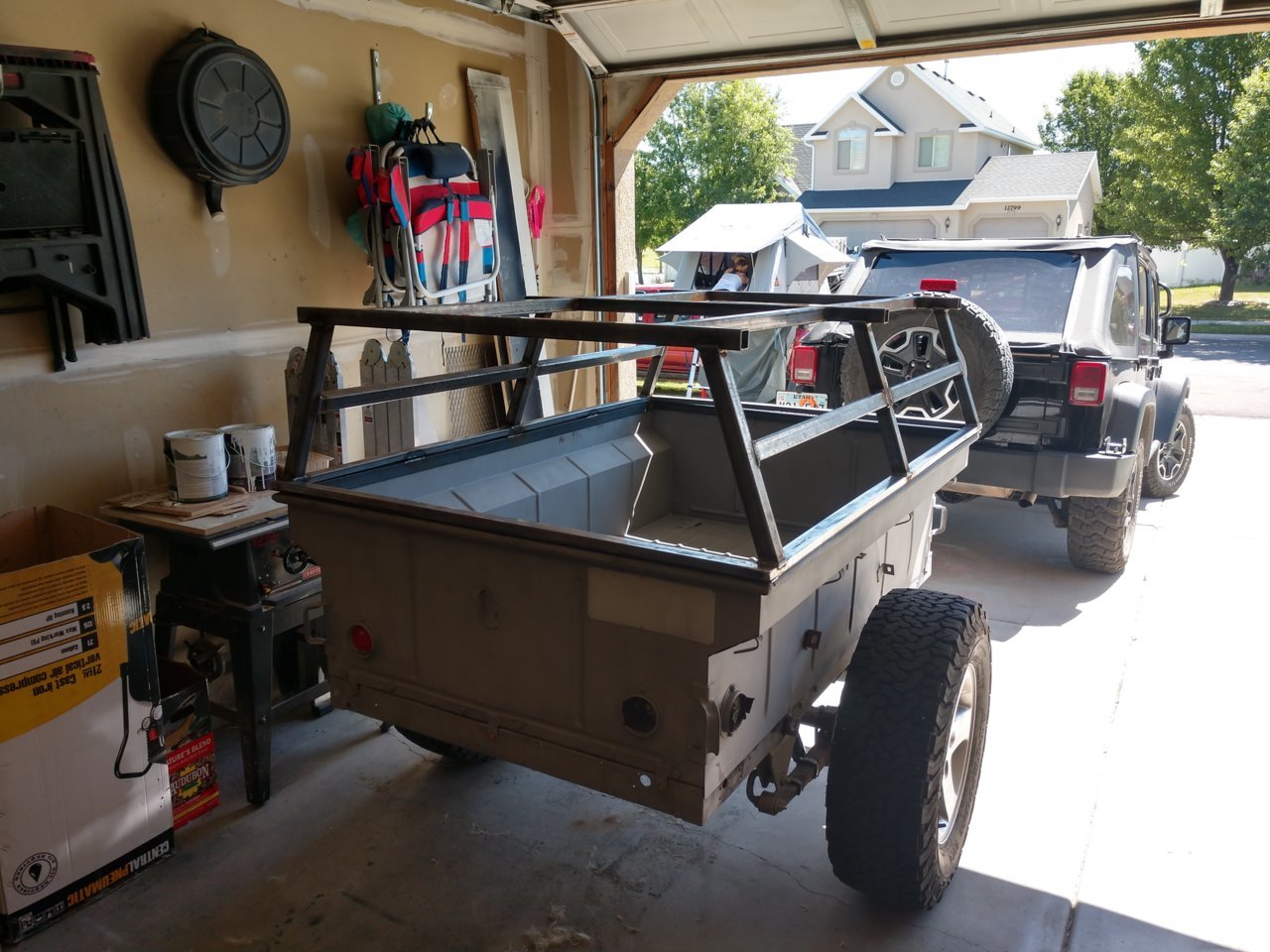

    Built a rack for a buddies military trailer he just picked up ( sorry for the heep :crapstorm:) can't tell from the pictures, but it is able to hinge up for easier loading of the trailer. Even though the openings at each end are ~16" tall and able to get a Costco large yellow/black storage container in there...
    Trent_G, Drainbung and koditten like this.
