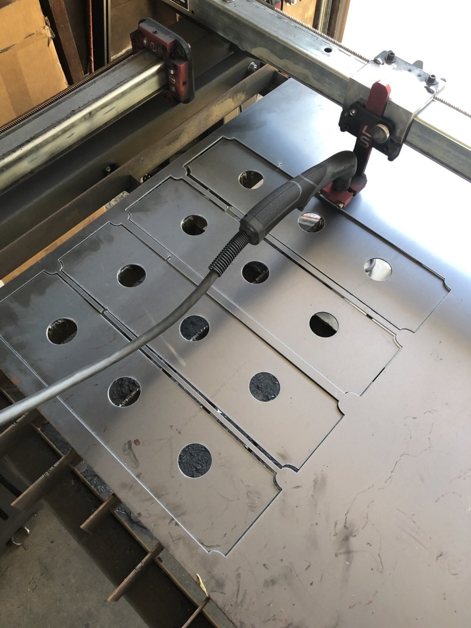

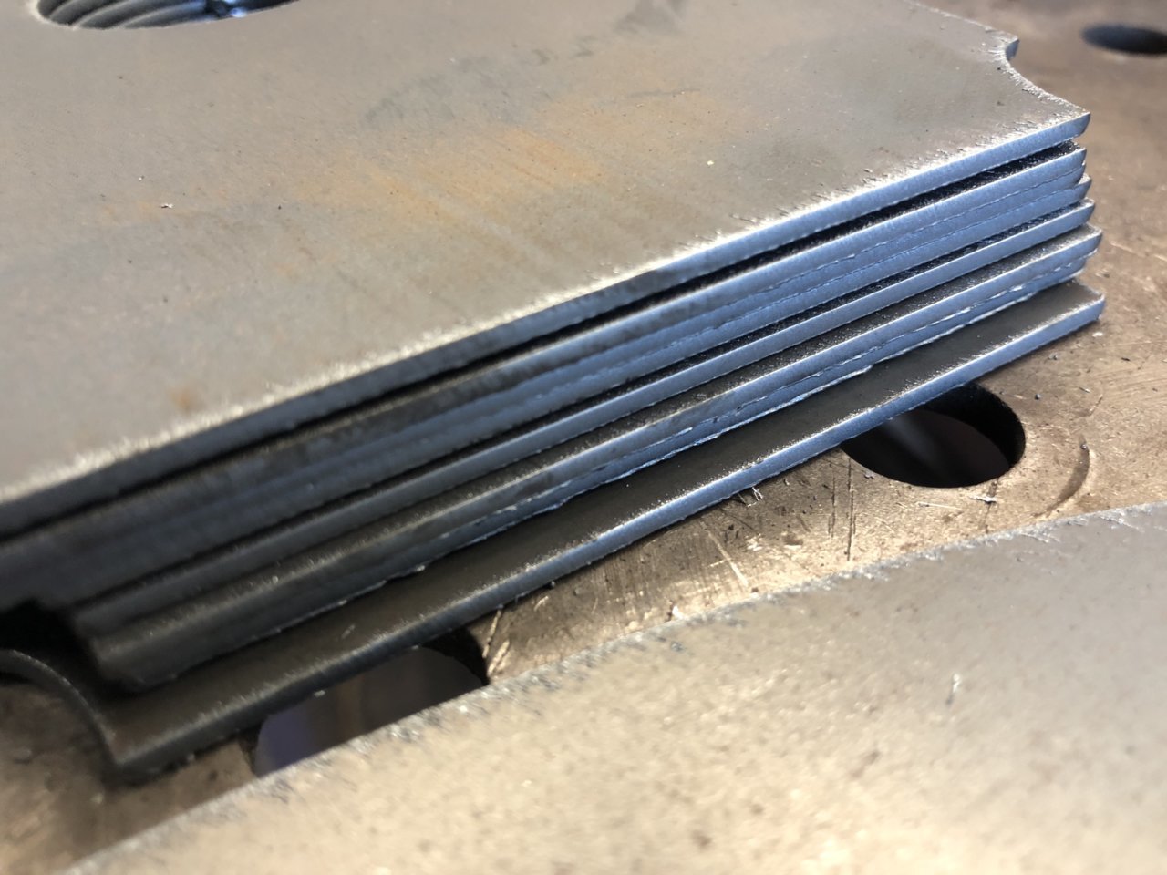

    Frickin love this crossfire. Cutting out fill plates is soooo easy now

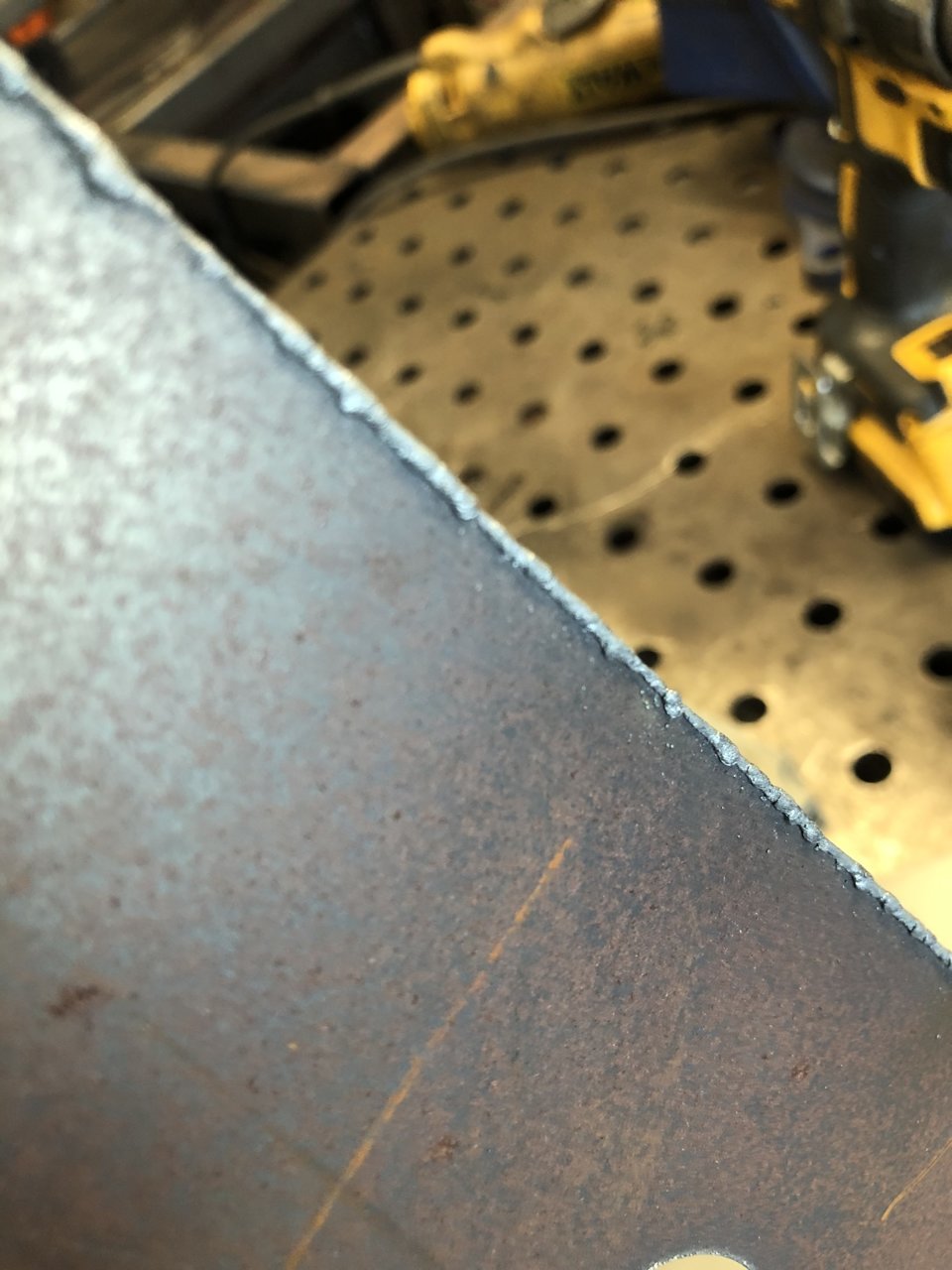

    I want to see some close ups of the cuts. Are you running any THC?

    I will take a couple pics. Very very clean in my opinion. I’m usually doing 14 gauge and 1/8” every once in a while 3/16”. Using a Hypertherm powermax 30 XP. No THC. For what I’m doing I don’t need it.

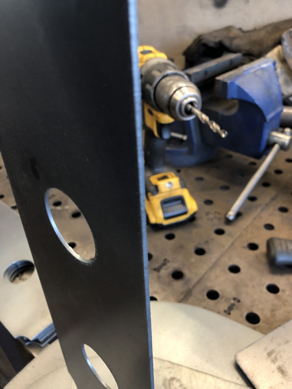

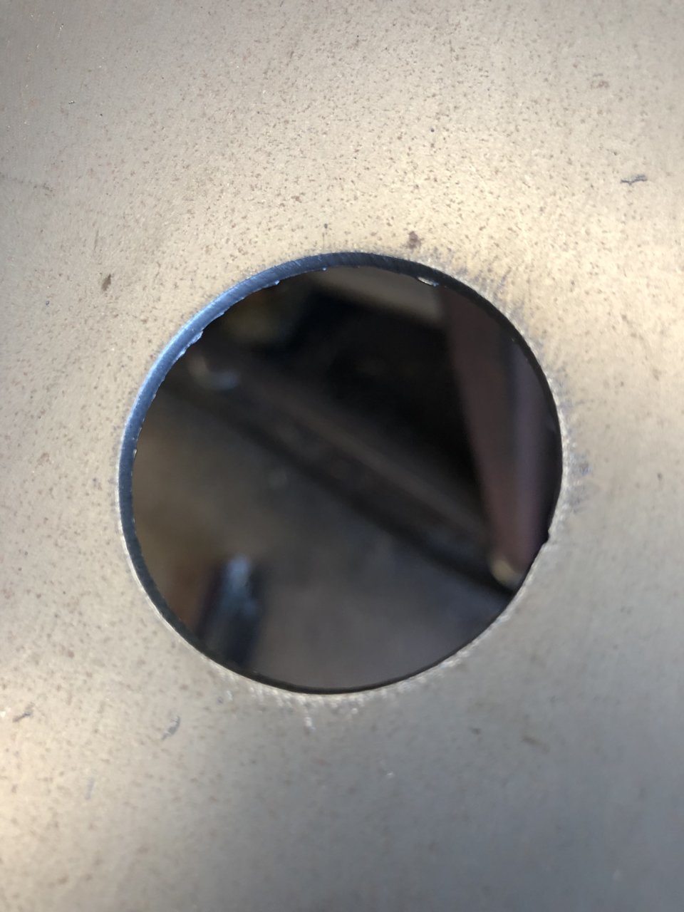

    @koditten
    Not the greatest pictures but here you go. Pretty damn clean edges. Pics don’t do it justice. No clean up at all here. Very minimal dross that chips right off super easily with a slag hammer

    Hahaha yes as @In4aride said “torch heigh control”
    If you have a THC on your table it will move the z axis up and down. My machine is basic and doesn’t have a Z axis. Only X and Y but it’s all good for what I’m using my table for.
    Having a THC helps a decent amount with cut quality and with consumable life

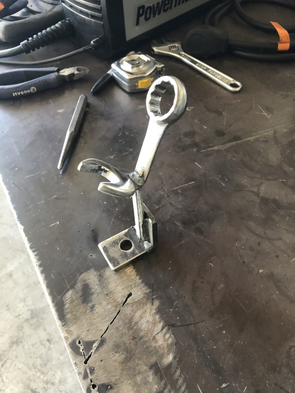

  20. Jul 13, 2019 at 8:04 AM
    Trent_G
    Trent_G Well-Known Member
    Apr 30, 2015
    #154287
    402
    Central Oregon

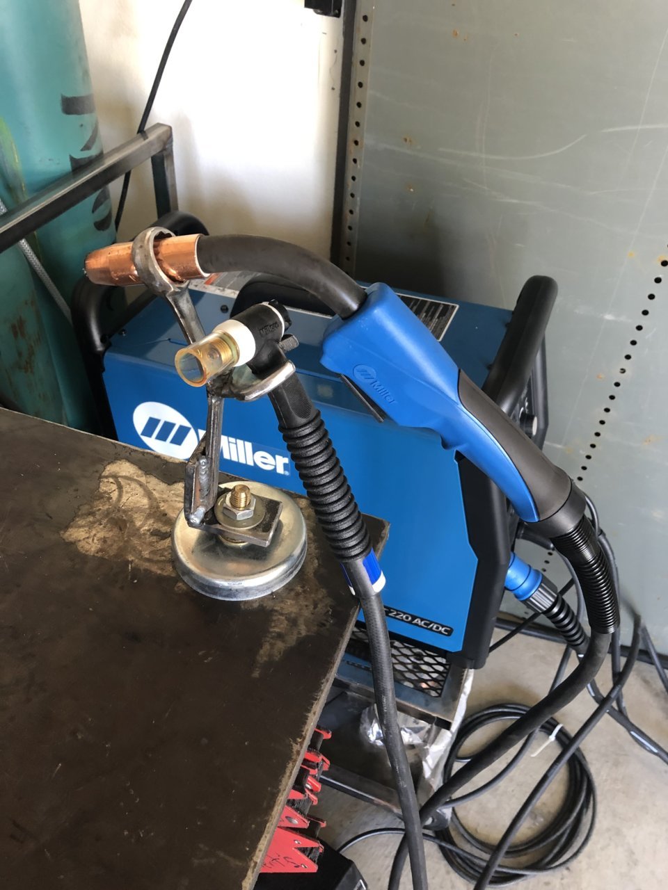

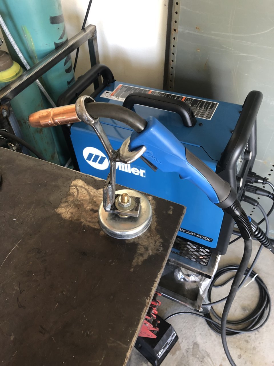

    Got bored and finally made a gun/torch holder.
