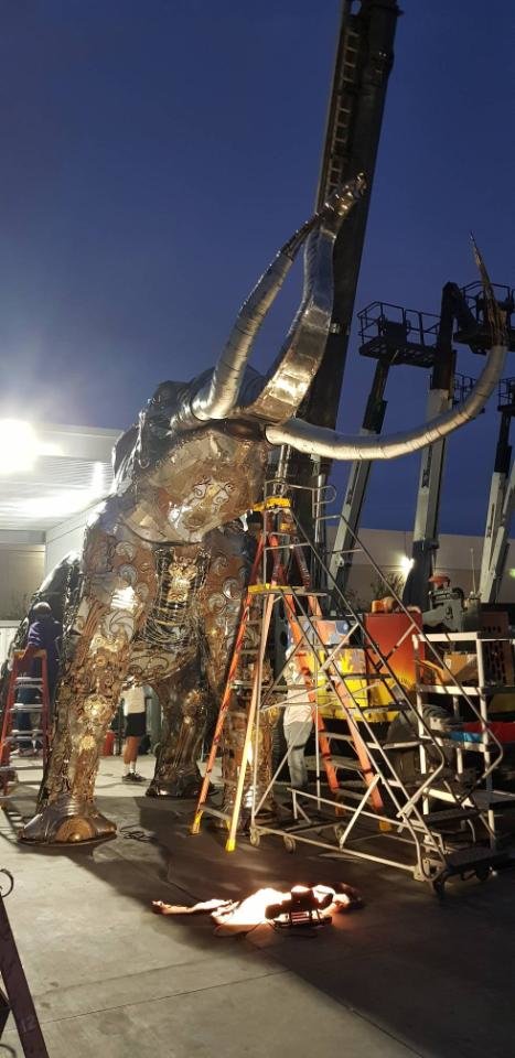

    Went last night to see the tusks installed.

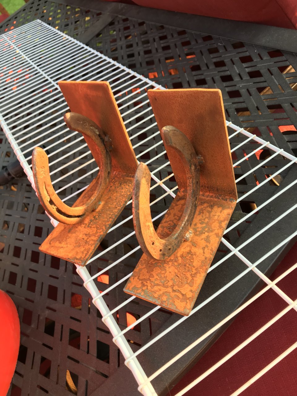

    Nice and rusty after 24 hours, with occasional salt water dunks. Gonna keep em going for a week. Any way to make it less orange?

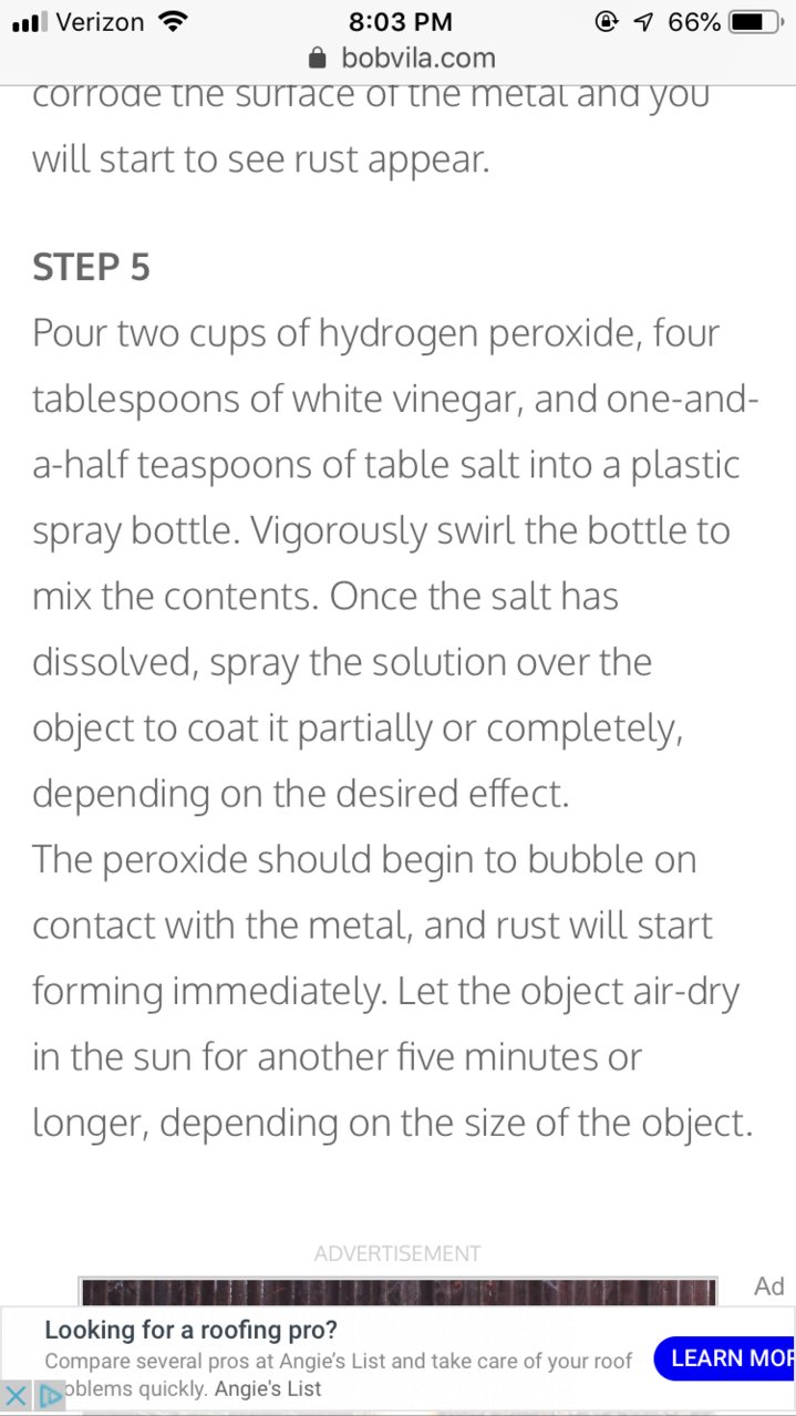

    There was a google recipe that used vinegar, hydrogen peroxide and salt if I'm not mistaken.

    Yep, called it. Will try this tomorrow if I can find a spray bottle.

    That orange should brush off with a stiff nylon brush.

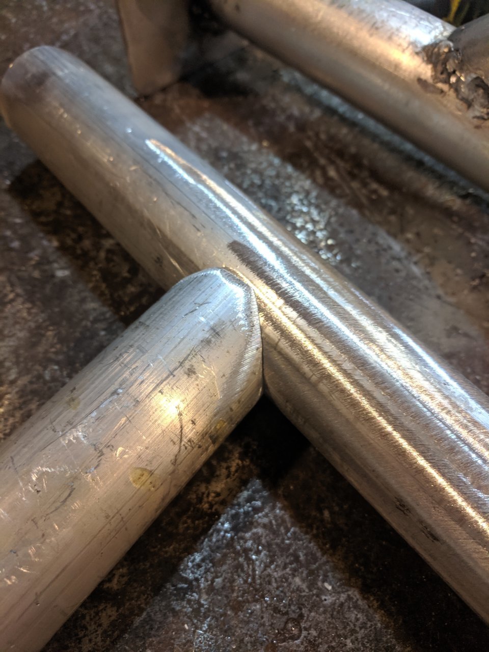

    Played around with a HF tube notcher. Am impressed. Makes aluminum spool gun welding much easier. Actually willing to show my welds and not be embarrassed IMG_20190726_175734.jpg IMG_20190726_184405.jpg IMG_20190726_180903.jpg

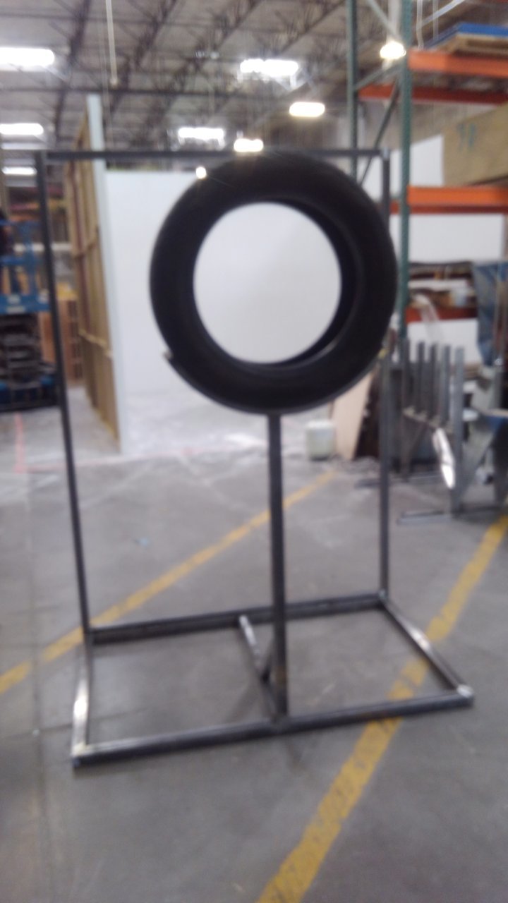

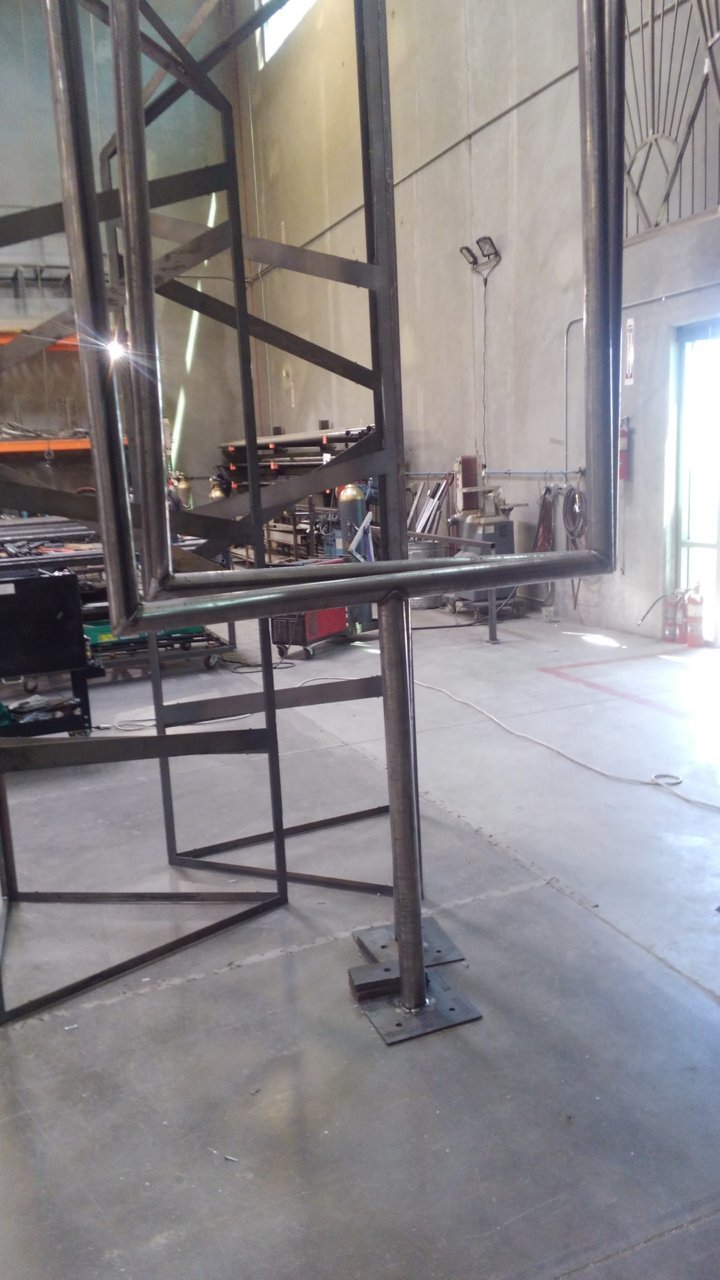

    Built a few things for a Dan Marino event. Toss the football threw the tire and some small goal posts. And some things they call Geo stands. They get covered in edge glow acrylic and get LEDs inside. Shop is busy and it was friggin 112 degrees todayKIMG0902.jpg KIMG0900.jpg KIMG0901.jpg KIMG0897.jpg
