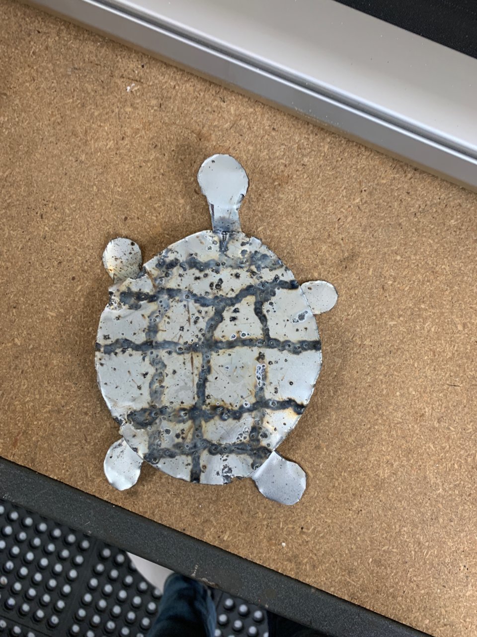

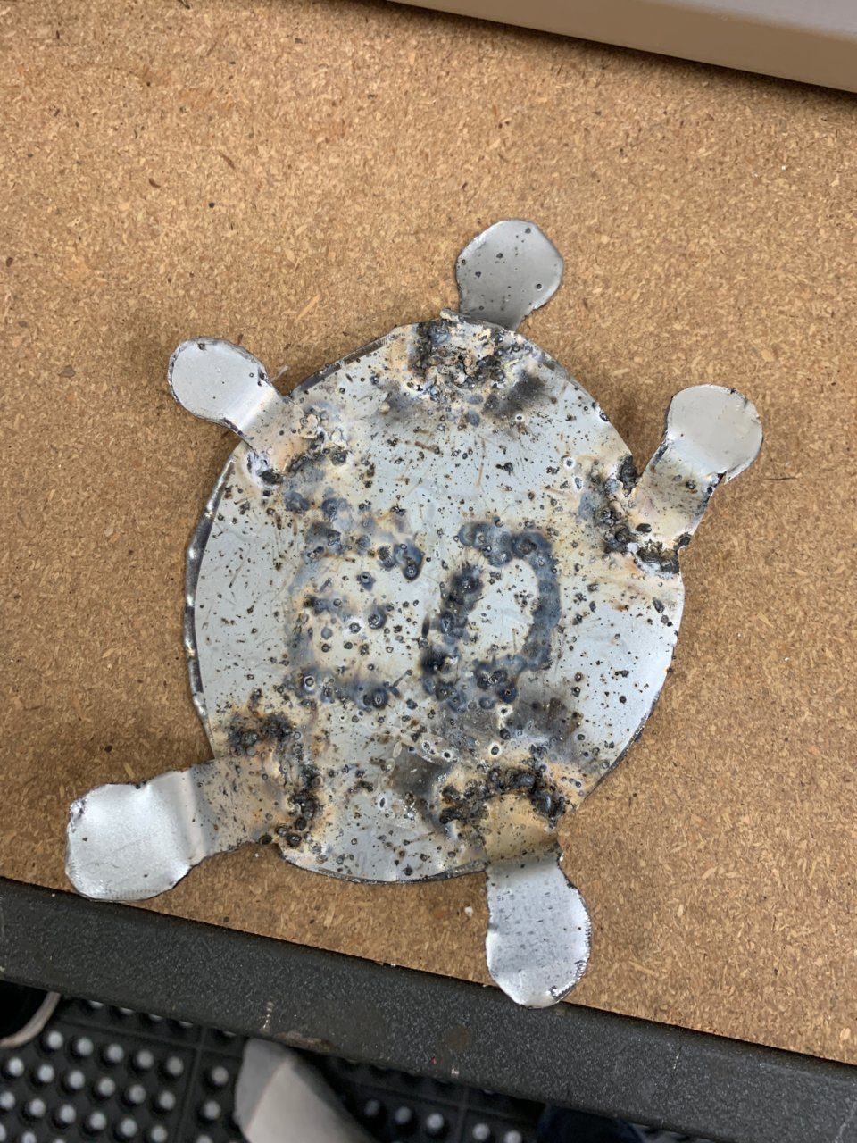

    I've wanted to learn how to weld for a long time, so I went and bought a 125 amp harbor freight mig welder and these are my first welds so please forgive how rough they are. Any tips of tricks would be greatly appreciated.

    How thin is that metal? Looks like sheet metal. I'd go to lowes or home depot and get some 1/8" thick bar stock, cut it up, and weld it back together in various joints.
    If you wanna be self taught, watch A LOT OF YOUTUBE. There is endless information at your fingertips. Watch, practice, watch some more, practice some more. Keep at it. Took me over a year to get to the point I can lay a nice weld.

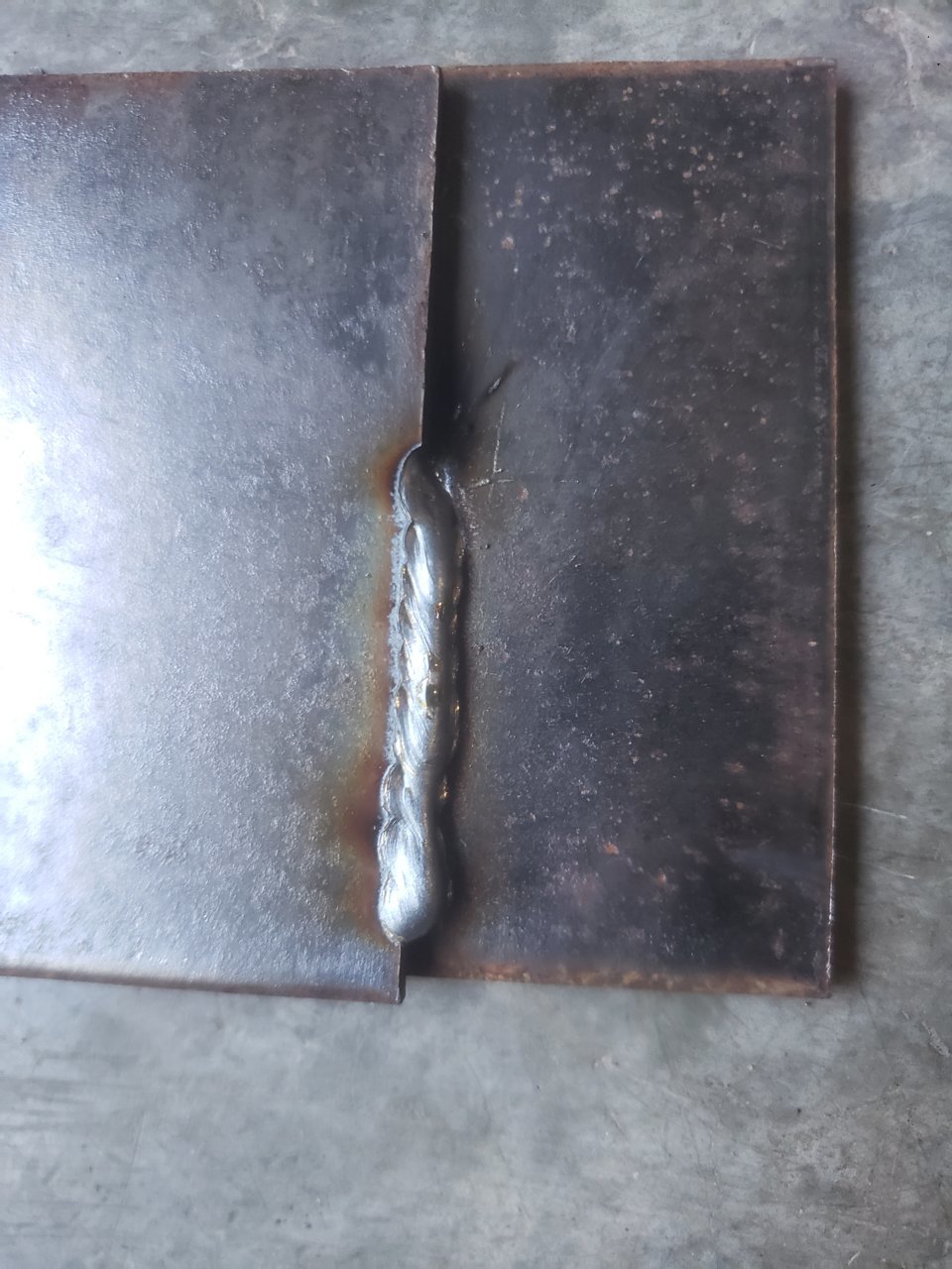

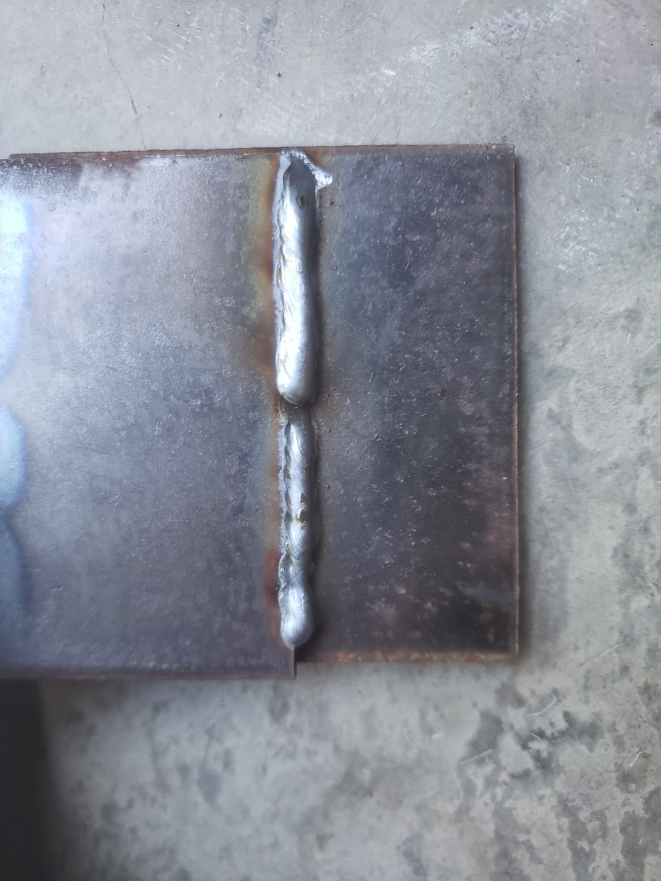

    Getting some practice in as I'm getting ready to weld on some sliders. Trying different positions and joint types. Here's some lap joints I was trying while laying on the floor (as if lapping onto my frame). First pic is a weld that I thought was decent, but I felt like I was moving super fast...
    Second pic show another where I slowed down a bit, but looks like I went too slow....
    Going to try and slow the wire feed rate a bit and see how that works. What say you?

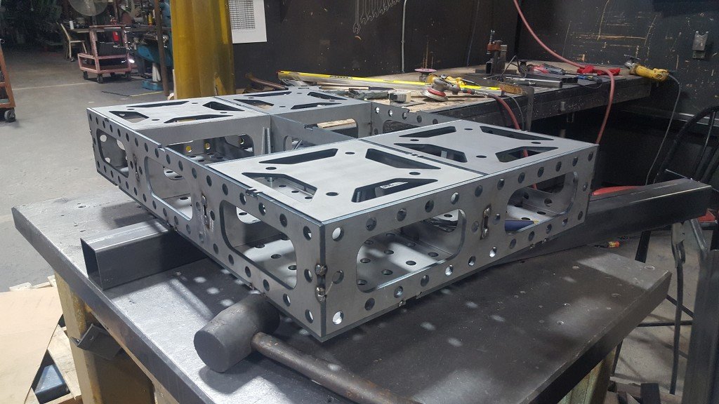

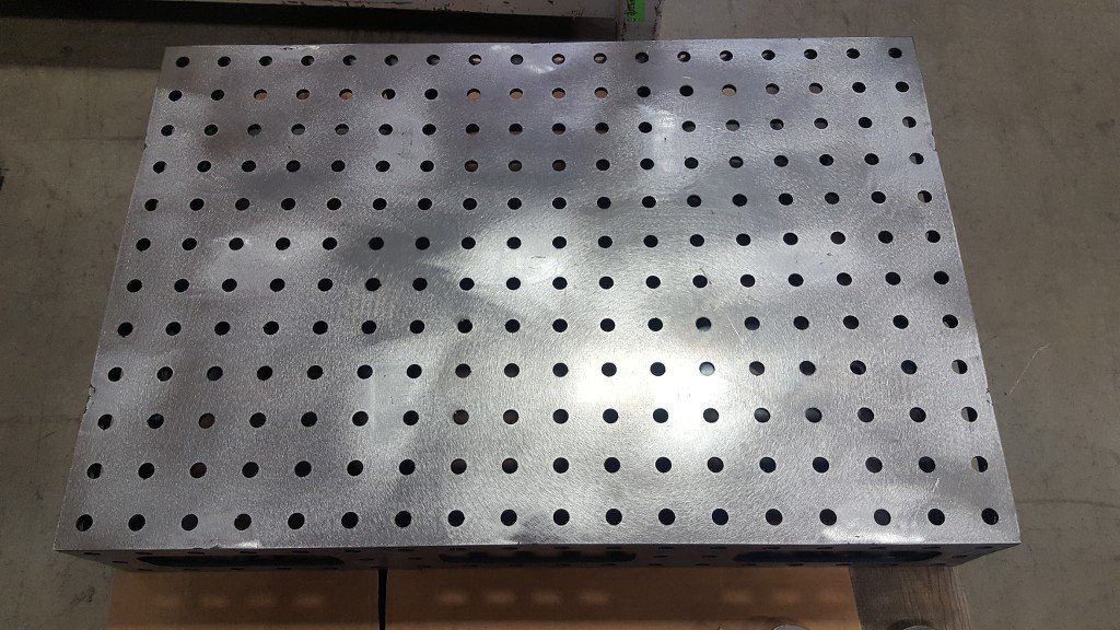

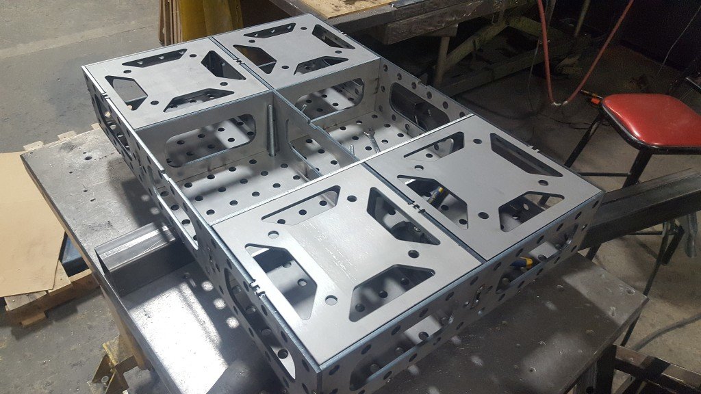

    I just finished up this small welding table project this morning. Not much welding in this piece, but a lot of welding will be done on it.

    Whose table is that? Looks nice.

    I bought plans from Maker Table for $29, and had everything cut at the shop I work at. The tables are very similar to Certiflat tables.

    Wire speed is too high or not enough heat.
    Is this 120 volt welder?

    Did you cut it with a plasma or laser? Debating making my own but my dads plasma isn’t good enough to make a clean hole and I’m not sure if I want to drill out every hole lol

    Yes/No, it's 120/240. It's a Miller MM 220 and have it hooked up to 240. I was using the auto-set (for 1/8" material) with voltage near max (18.4V) and WFS near min (283). I think that I need to get out of the auto-set feature and play with some custom settings. The auto-set works great for welding in perfect conditions (flat, on bench) but not so much for out of position. Still working on getting shit right. Will probably take some more practice.

    I cut this one a laser, and it isn't perfect. I'm going to ream each hole since some have dingle berries that need to be cleaned up.
    I'm having 5 tables that are 5x12 cut on a fiber laser. That's the cleanest cut you'll get.
