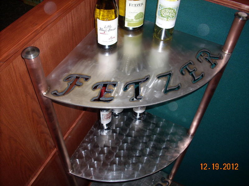

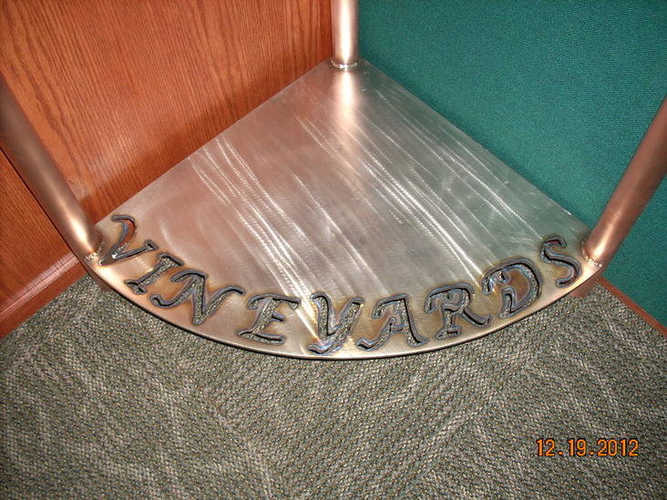

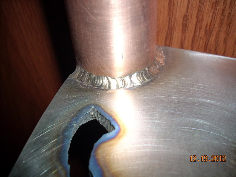

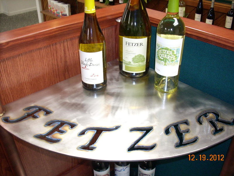

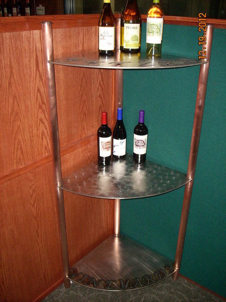

    Here is what I made at work today for our Head CEO for his office. It is out of Stainless Steel and copper tubing for the legs. I used silicon bronze for the welding of the copper tubing to the stainless steel.

    pretty cool, good job. :thumbsup:

    Hand cut with a plasma? I can never hand cut for shit. LOL. It's the one thing I can never do as good as I'd like, I probably just need more practice. I hardly ever do it
