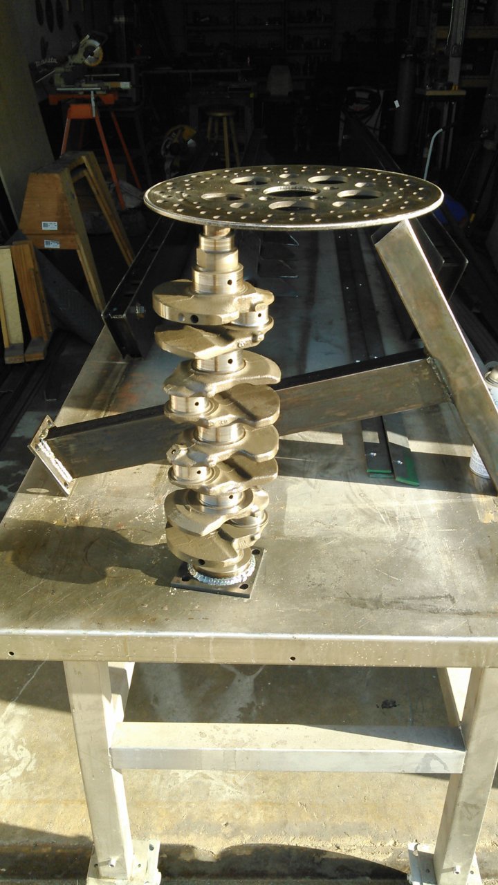

    V6 crank and a Harley brake disc end table. Will get a piece of glass one day.KIMG0075.jpg

    :thumbsup:nice!
