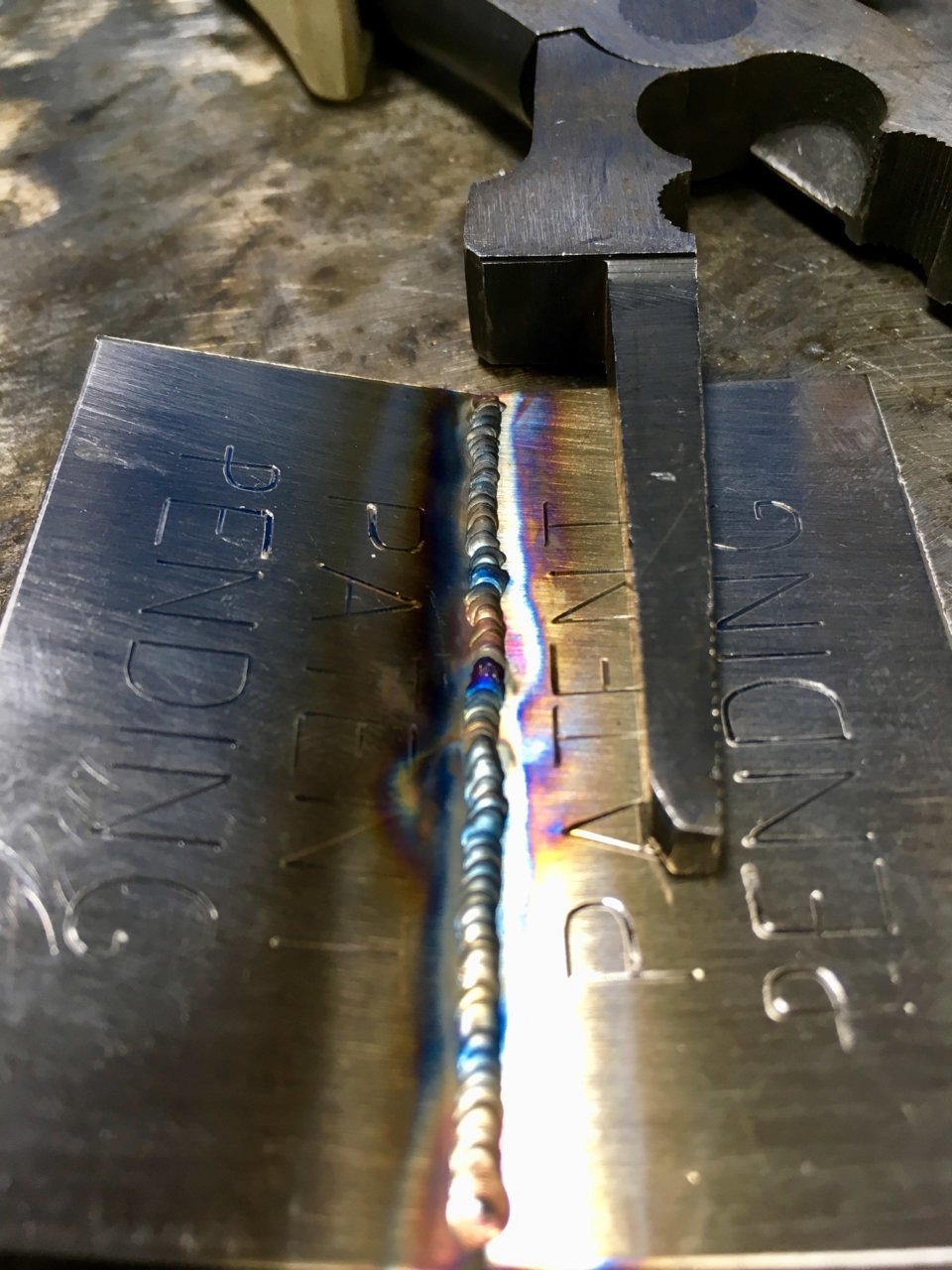

    I noticed that I would get some weird sputtering when I let my gun tip get too close to the work piece.

    @wilcam47 Since you're using fluxcore, sickout needs to be 3/4 - 1 inch.

    Do you have splatter between the nozzle and contact tip that will do it.

    Yes, definitely have spatter in there. I forget to check that all the time and just keep welding. Lol

    Oh, you mean like enough spatter to bridge the gap between them?

    Better heat control meaning smaller heat effected zone
    I find the puddle is so much cleaner and easy to see if your prep work was done correct .
    Some Purists will even cut the heated rod end off exposed to the atmosphere to prevent even the smallest chance of a contaminated weld

    yes it really does not take much

    Plus you’re much more likely to get a cold start welding something like this with a mig welder. It’s also a lot easier to KNOW you got good penetration by running multiple passes on a price like this. I personally would only attempt this with a tig welder.
    Also I always cut the oxidized tip off the wire before starting a new weld. I do it on mig and tig, one of the main reasons I do it on tig is because I tend to pull the rod out of my gas coverage zone before it has fully cooled, which can cause oxidation on the rod. If you want to continuously improve I find its best to remove as many variables as possible. That’s why you clean all your rods before using them and cut the tips off. That’s two less things that can cause trouble with your welds. So she’s hit isn’t going right it’s a little easier to figure out the problem. It’ll also give you more consistent results.
    I’m also not a production welder. If I was I’d probably have a different view on everything.
