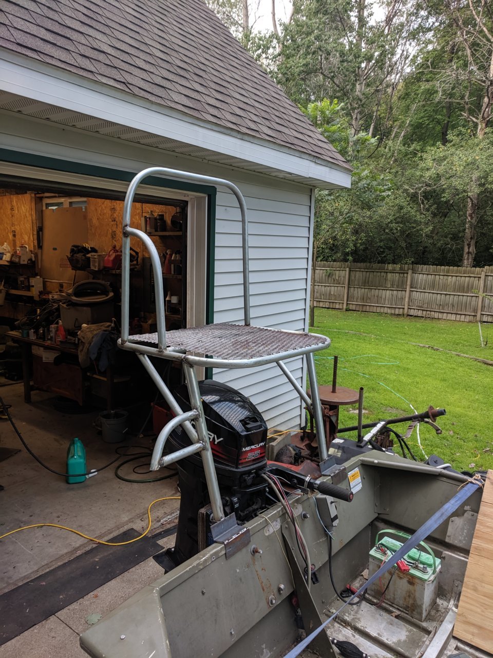

    Made some progress on the poling platform.

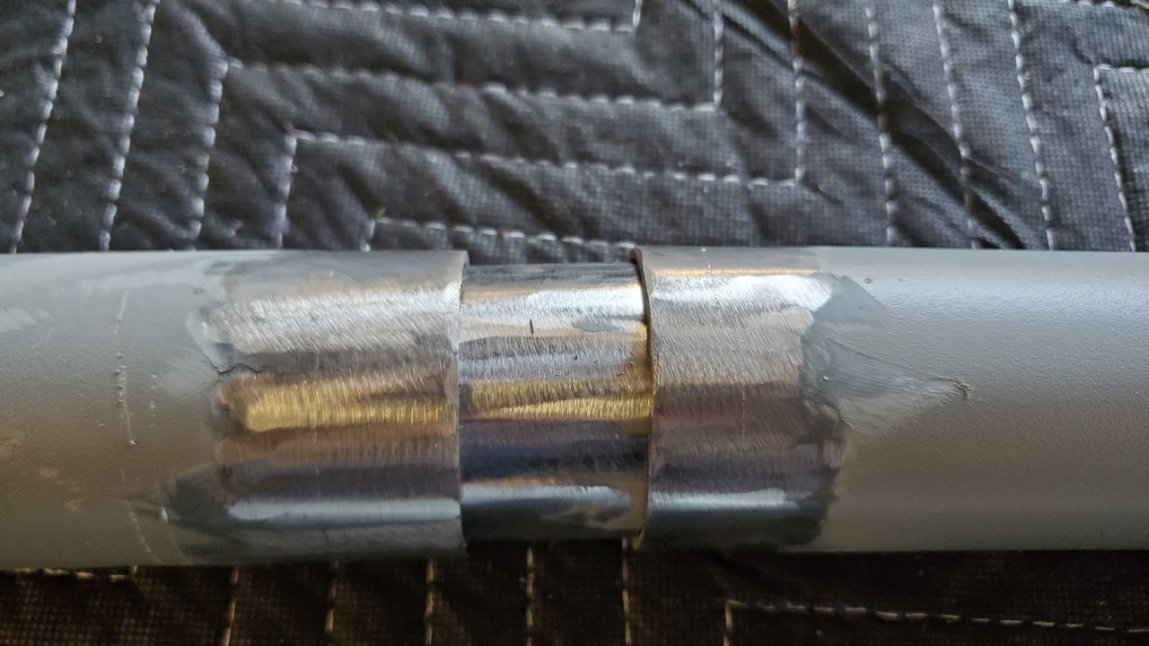

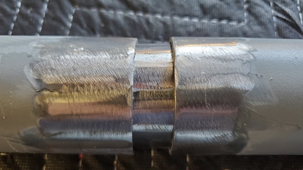

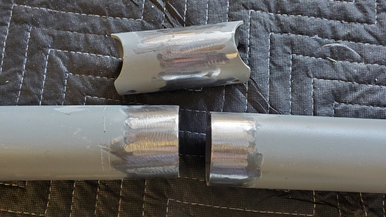

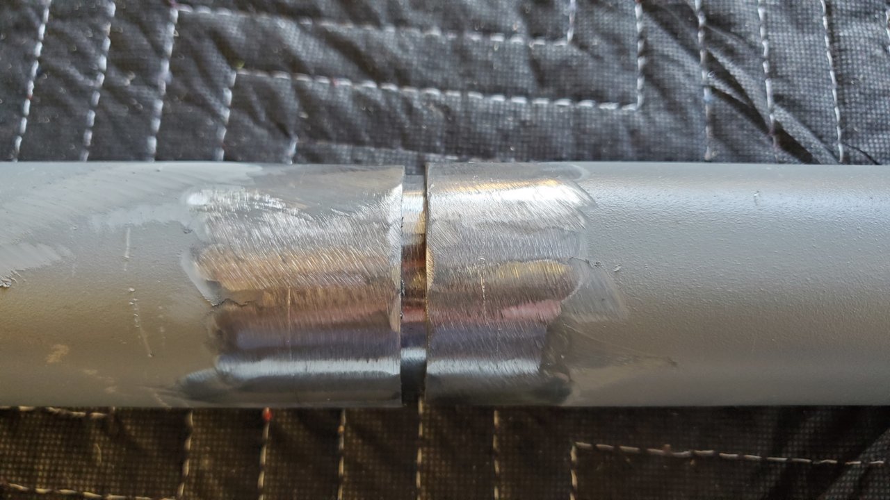

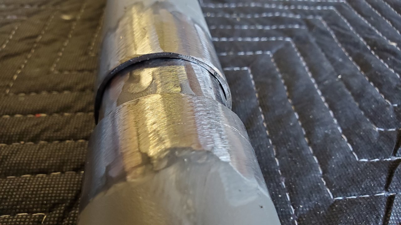

    ok seriously, I'm gonna be welding these two pieces together (actually 3 pieces). The "coupler" fits as good as it can inside the longer pieces.
    The questions is, should I weld each side first then do a whole side to side pass OR should I just do one side to side pass all:fistbump: at once?? I will be doing MIG, .025 wire 75/25 gas.

    Whenever I sleeve and weld stuff I tack it on top and bottom so it lays flat on the table and weld one side then flip and weld the other. If im concerned about it warping I clamp it and weld and let it cool then flip and repeat

    Once and done. The pic with the 1/8" gap is the way to go.
    70S wire is going to be waaay stronger than the base metal.

    Interesting. I have to do 8 of those. Never done it before. I like the idea of one pass. Were talking like 12ga not even 1/8 thickness. I'm gonna do some testing tomorrow.

    Just what does that piece do ?
    In what direction is the load going to be?

    They are 4ft pieces, need to make a 12ft post with them. They'll be on concrete (about 3 ft deep) linked to each other by a steel cable.

    More then likely working with what was on hand
