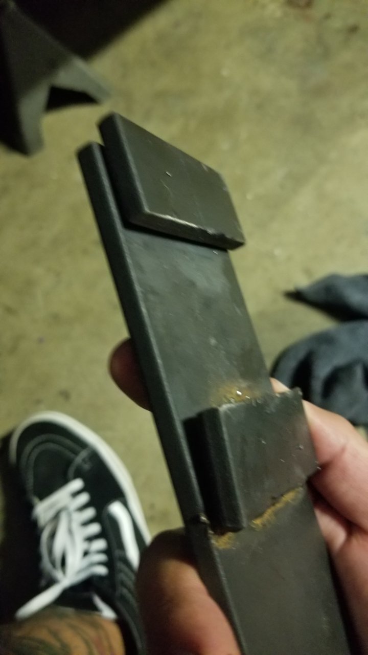

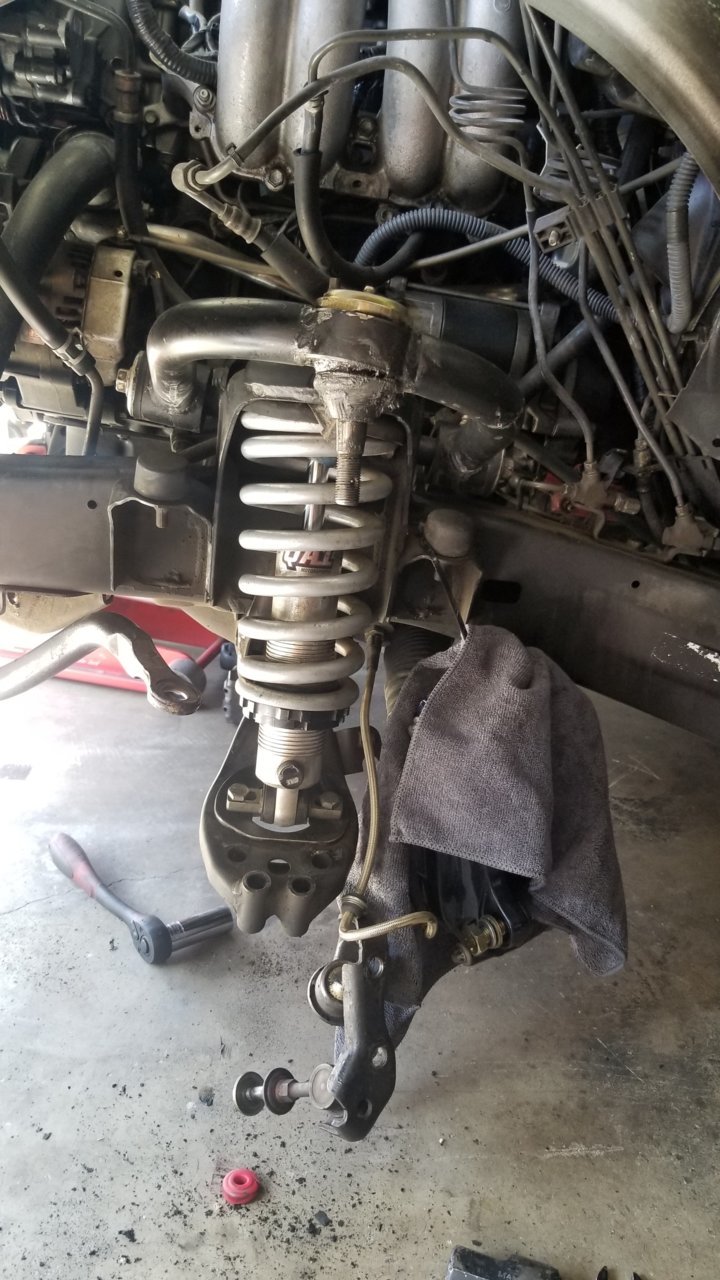

    Built this ugly ass tool to remove my balljoints lol. Didnt feel like dropping $20 on a tool or even driving anywhere today so I made it work haha

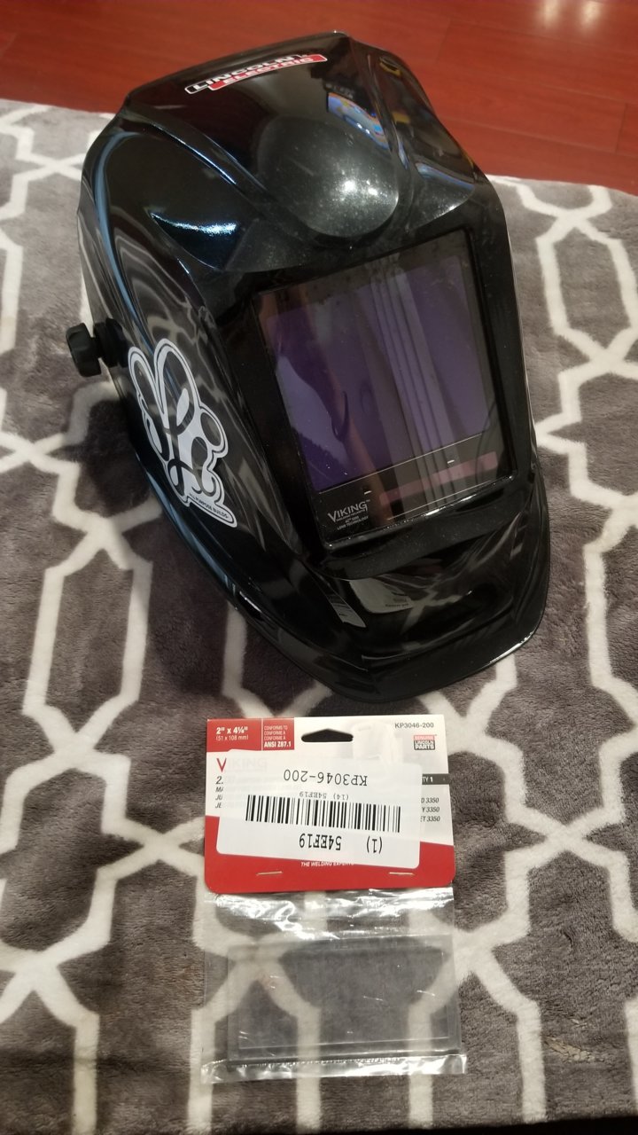

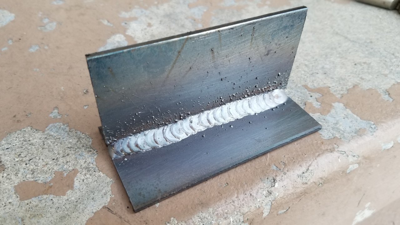

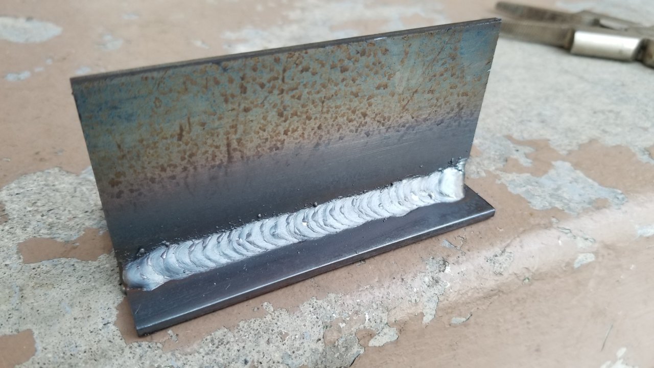

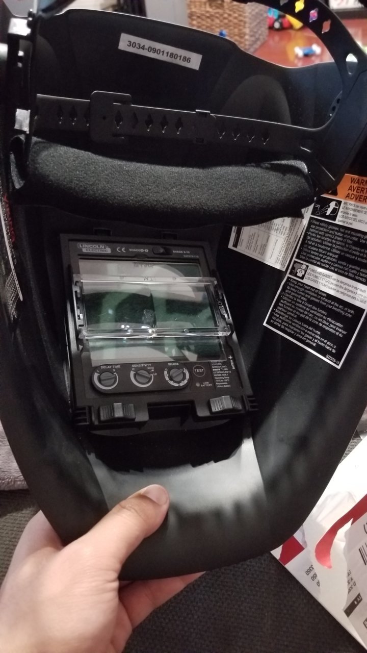

    Didn't get any pics today, but was able to weld with my new cheater. It definitely helps.

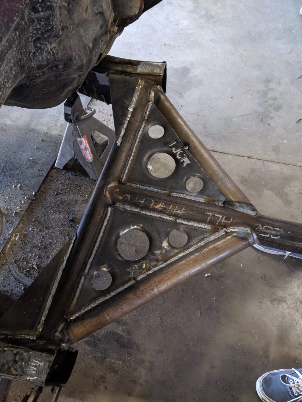

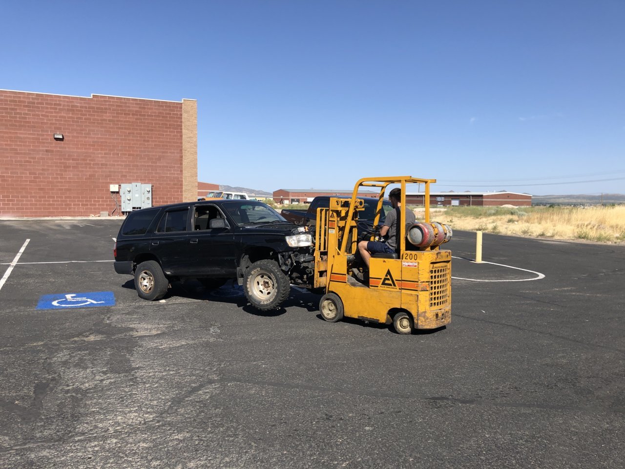

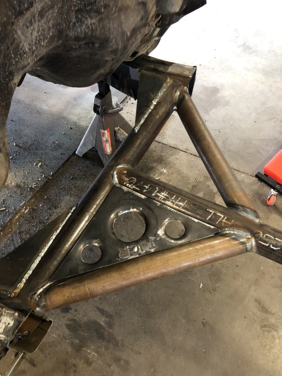

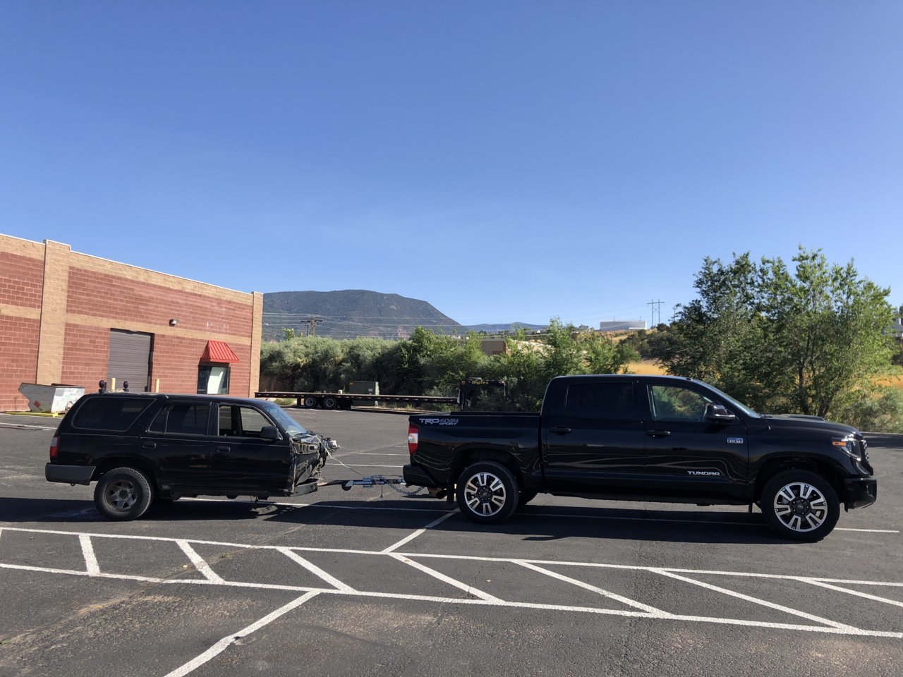

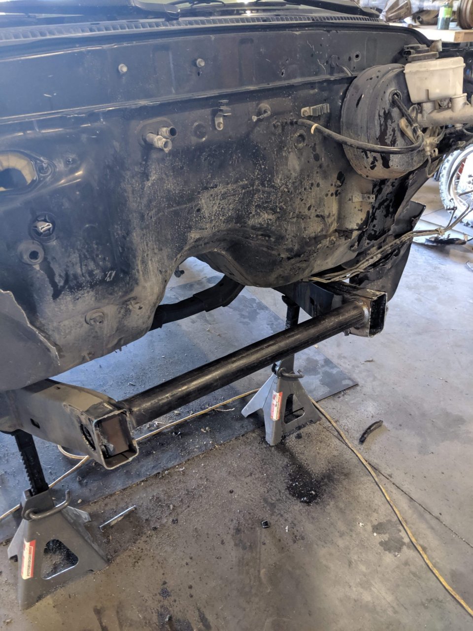

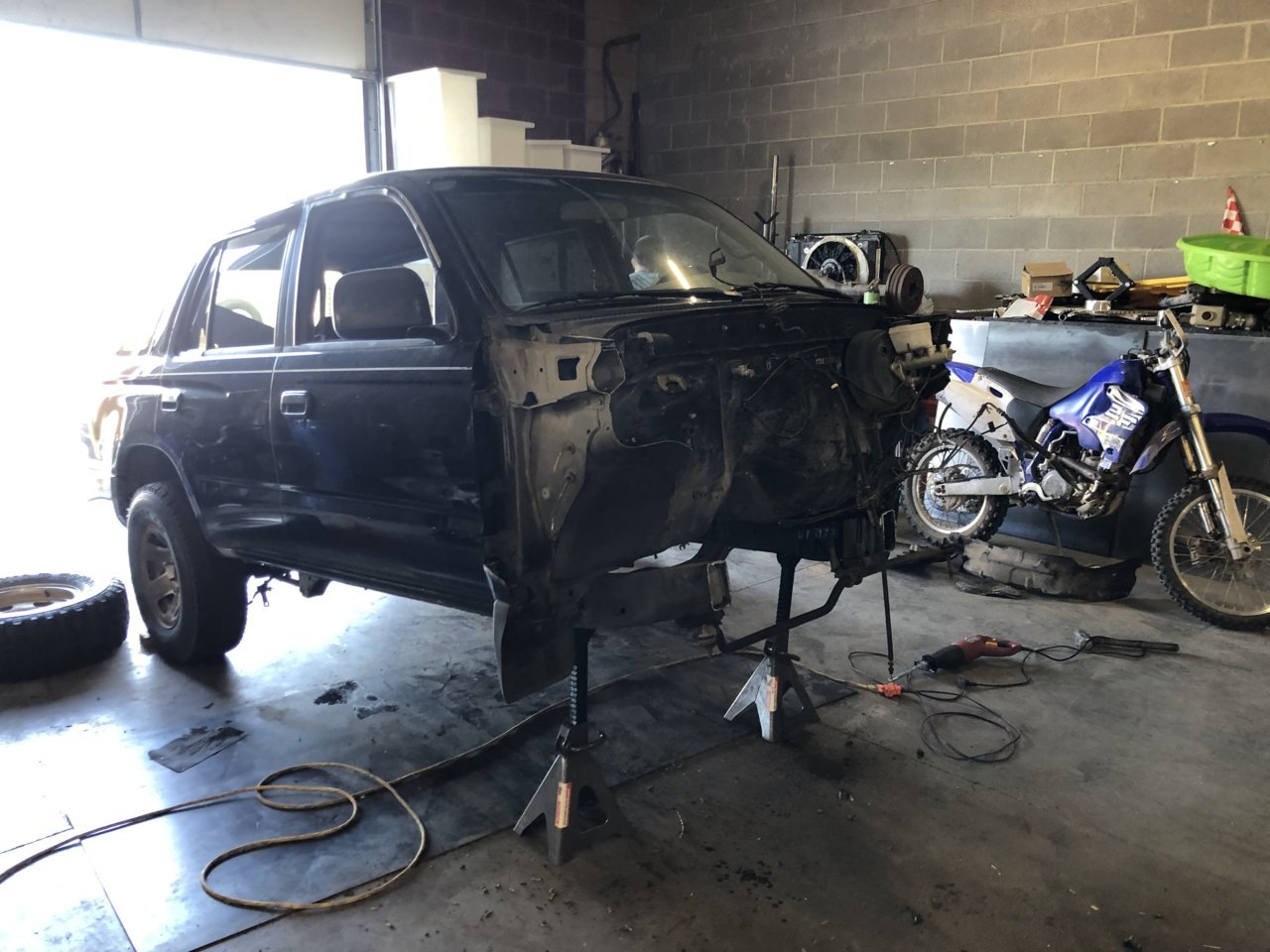

    Start with a nice POS without a title. Seeming it worthless
    Cut it in half
    Weld a bar across the frame rails. 2.5” .25 wall DOM
    And then just keep Welding
    Dimple dyes help
    Needs a lift and 35’s

    I like it, but fear that eventually the junction between the coupler younger and the frame will start to sag. That's got to be a massive amount of tongue weight.

    I venture that is lighter then the diesel welders I tow.
    I don`t think the tongue weight will be all that great
    I doubt the interior is still in.
    Two people could pick it up a carry it without the axle

    Doubt it. It’s sleeved 2.5” .25 with 2” .120 . The whole things weighs absolutely nothing. If I flipped the hitch there would be less tongue weight for sure but I can move it around solo.

    Towed it 500 miles this morning

    Probably close to just the weight from the B-pillars forward, the rear would counterbalance the weight from the axle to the B-pillar. Not a lot left.

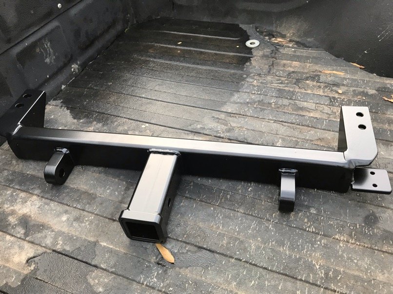

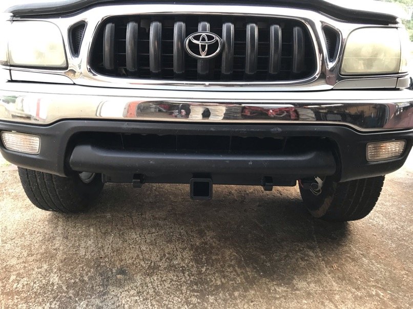

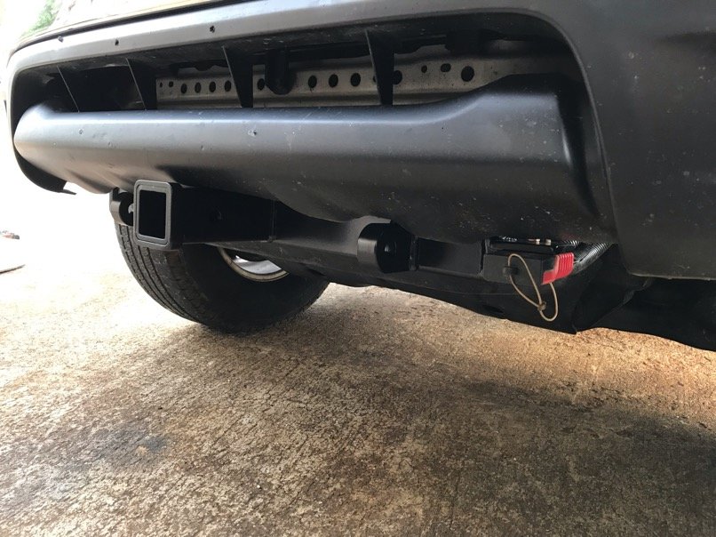

    Just picked up the front hitch I made from powdercoat. They primed it and painted it black.
