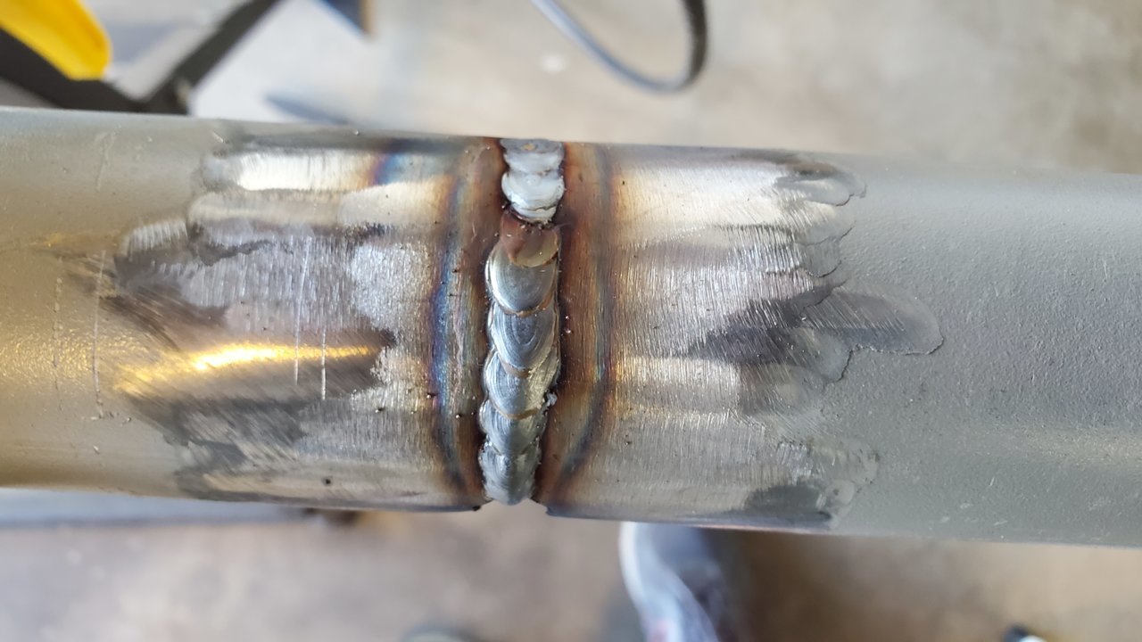

    I have a question. On rare occasions, when running a bead with my M211, the bead starts off normal, normal sound and then midway through the bead the sound kinda starts changing from the normal sizzling and popping to a non popping/sizzling smoother fluid type sound. Any ideas what causes this? The bead still lays down good and hot, but the puddle seems to be not as uniform as the beginning.

    It could be many things .
    Does it seem to happen only after the welder gets hot??
    Bending the gun putting pressure on the wire but not enough to completely cause it to stop .
    The shielding gas mixture is changing as it is pulled out of the cylinder .
    Someone turned up the AC so the input power dropped enough to notice .
    Who knows what cooking out of the base metal.
    I could keep going .
    Look at the position of the gun when it happens.
    When was the last liner installed ??

    I just replaced the liner. I'm going to try and shorten my extension cord that is supplying power to the welder. That's interesting about the gas mixture because this never happens when I run 100% co2.

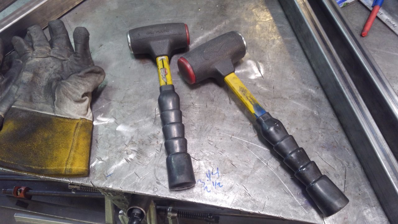

    This is just a FYI.
    These are Nupla dead blow hammers. I find them to be awesome. The one and 2 pound versions have a soft blow face and a steel face. I like them so much I have a full set for the shop, my home shop and my mobile setup, 1,2,3 and 4 pound.
    You can find them on Amazon, but the one pound with one steel face can be harder to come by.
    Anyway, awesome tools that I use daily and feel is excellent bang for the buck.

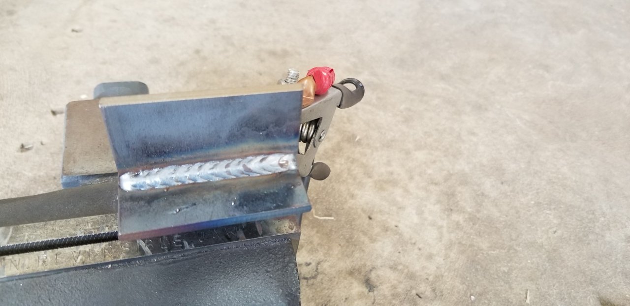

    Looks like I found the culprit. It was the torch gas nozzle. The old one was faulty wasn't making a good seal and was also allowing the contact tip to protrude outside of the nozzle, like the stop inside was not there. Changed to a new one and it lays a consistent bead now.
  11. Sep 2, 2019 at 1:15 PM
    deeezy
    deeezy Well-Known Member
    Sep 1, 2013
    #111645
    5,253
    Dana
    Hawaii
    2013 4x4 DC, 6 spd, TRD Sport
    King ext travel coilovers, Icon tubular UCA's Rear-King "Tundra" 2.5's, Allpro Expos, TRD cat-back, Hurst/Core short shift kit, etc...

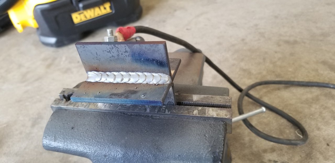

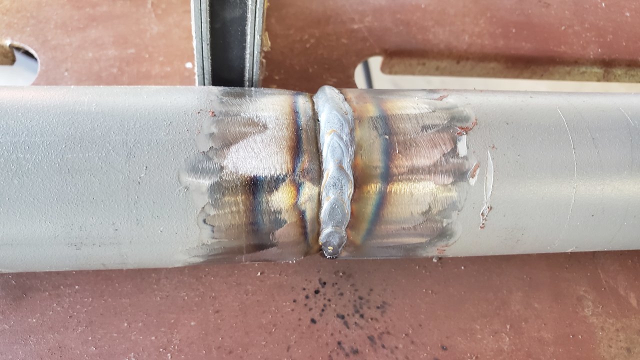

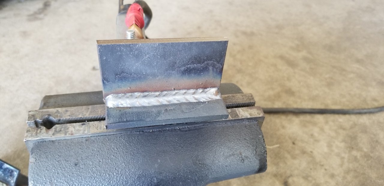

    A few practice beads to make sure it was the nozzle. I had no idea the nozzle made that much of a difference. I also wanted to practice pushing instead of always pulling.

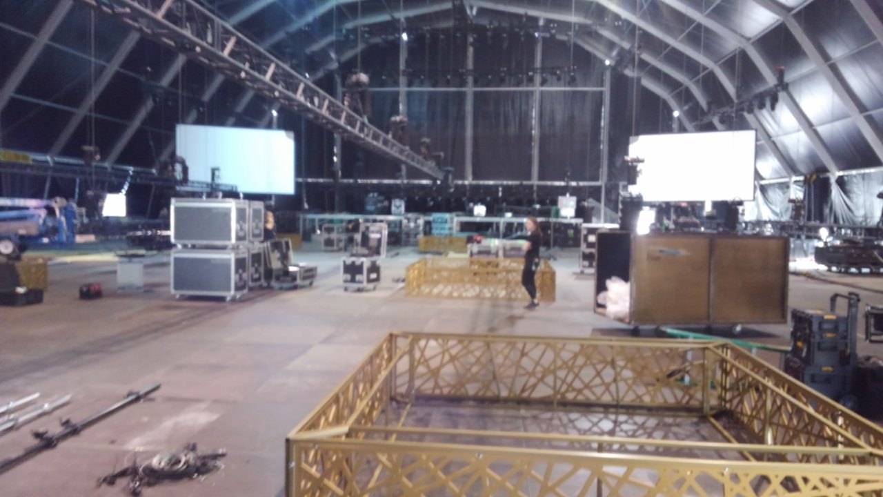

    Got out of the shop today.
    Went to put together my light box things for the Toyota event. Turned out they will be hanging in a giant tent for a George straight concert for Toyota execs.
    All went well, except for having to be there at 5 am. Each high beam can carry 6500 lbs. Impressive for a tent.KIMG0936.jpg

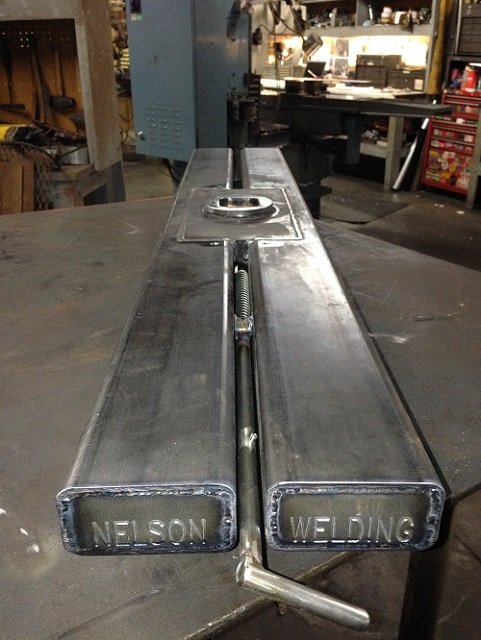

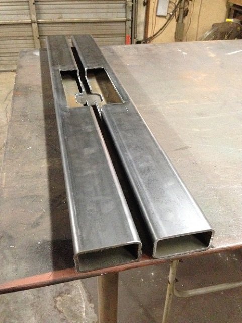

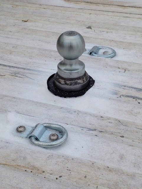

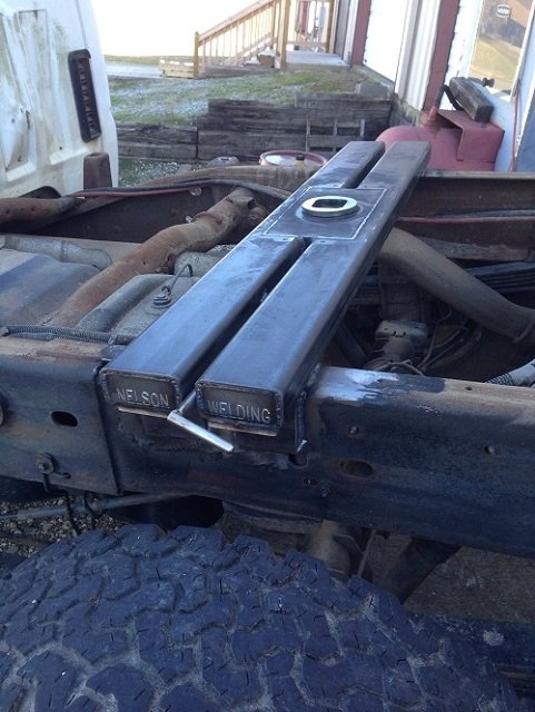

    Made a gooseneck hitch for my other truck.

    Love everything, but those D ring safety chains rings look so undersized compared to everything else.
    Nice, clean work.
