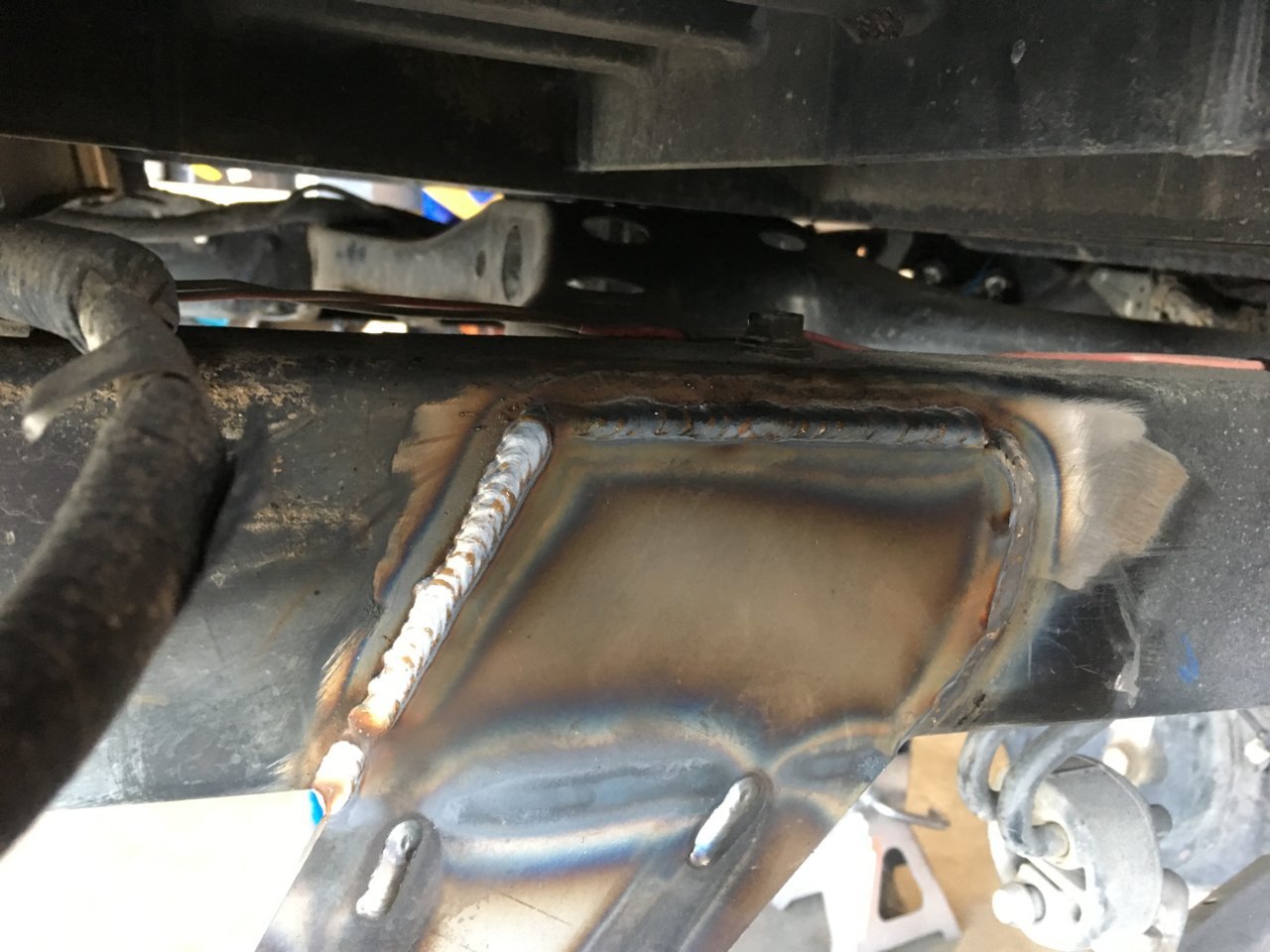

    Did some welding today. Installing a DMZ long travel spring under kit on my truck.

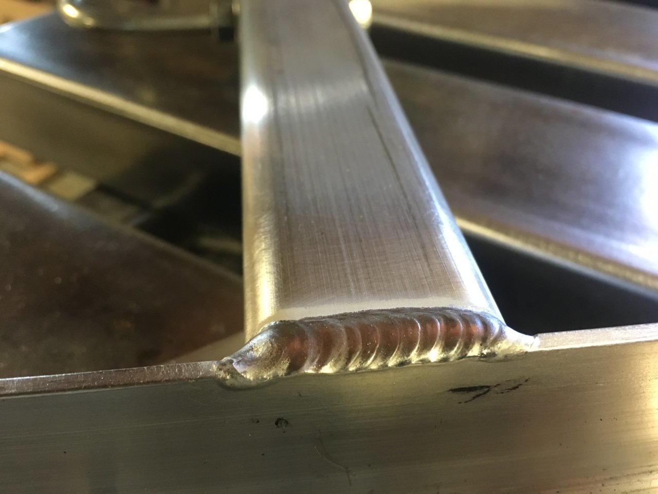

    gucci interior and chandelier.

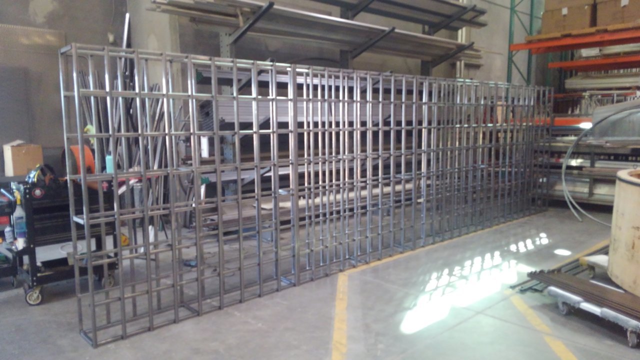

    Wall of 140 mailboxes for a event in Nashville.

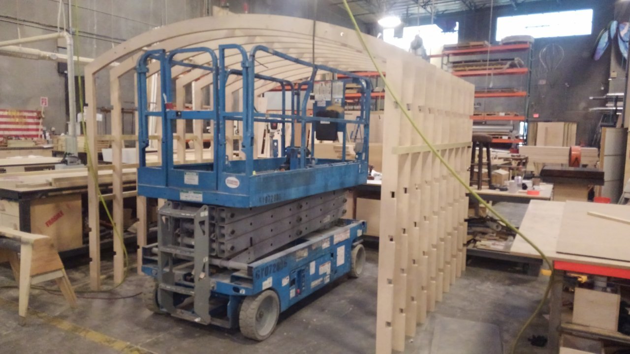

    The rendering showed flowers covering the top and ends. 24' long 7' tall. 12" deep.
    2 days, one man
    47 20' sticks of 1x1. Built in four pieces.
    On to the next job.

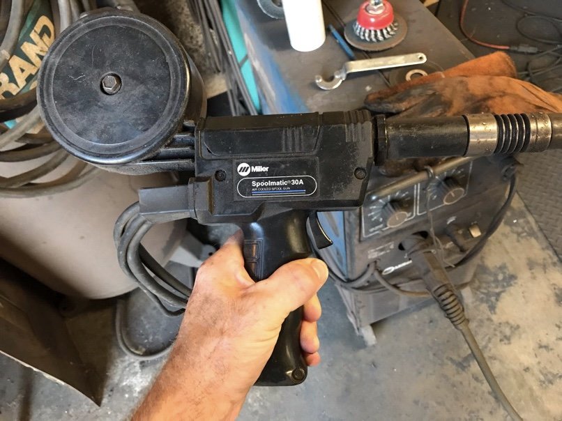

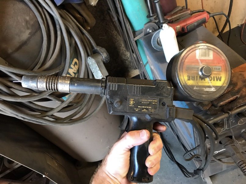

    Anybody here does Mig aluminum?
    I'm finally pulling a trigger on the Vulcan spool gun. Also buying a bottle of 100% argon from cyberweld. Any pointers?
    Side question, can my 75/25 bottle be filled with 100% argon once it's empty?

    Yes, we have a spool gun on our Millermatic 250 here at work. It's alright, it has it's limits though. Get a lot of tips, then get twice as many as you think you will need.

    I disagree on the number of tips you will need.
    Once dialed in, you won't have a problem. I only used 2 to build my boat.
    You have to have a dedicated tank for argon. You will have to lease a second can.
    I used a buddy of mines HF mig max and I think it worked just as good as my miller 30a gun welder.

    Once dialed in you won't have a problem with burn back, learning to get there is what eats tips.

    You should be able to swap your 75/25 cylinder for a 100% Argon cylinder depending if the gas distributor polices
    A learning curve for sure just buy a bag of Tips to start.
    Just like Tig welding used dirty Aluminum still is a Royal Pain.
    I hate spool guns You would have to pay me $250.00 /hour for the punishment.
    Just used a Aluma Pro on a Miller Millermatic 350P talk about being spoiled

    Spool Gun on a Mig machine with straight Argon.
    EDIT: And the skills...

    A spool gun basically uses the machine for power, otherwise it's like a separate system. Our welder here at work (Millermatic 250) had a plate on the upper right corner that was for the spoolgun option, it was plug and play. We added a bottle on the back for the spoolgun and it has it's on little roll of wire, you can use aluminum wire or stainless.

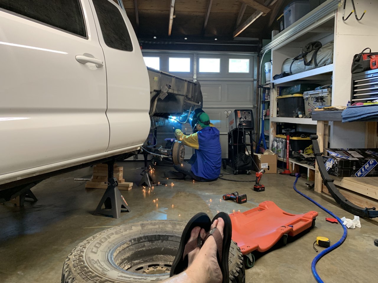

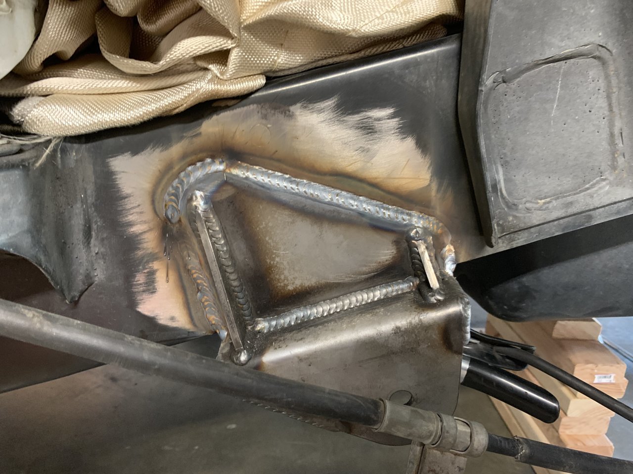

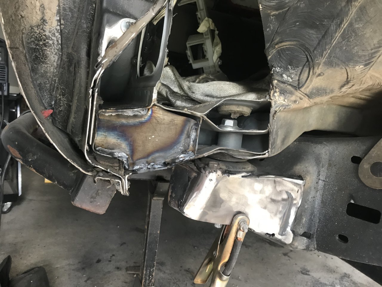

    Tubbed another truck, this time my own. I still hate sheet metal and have respect for people that work with it regularly
