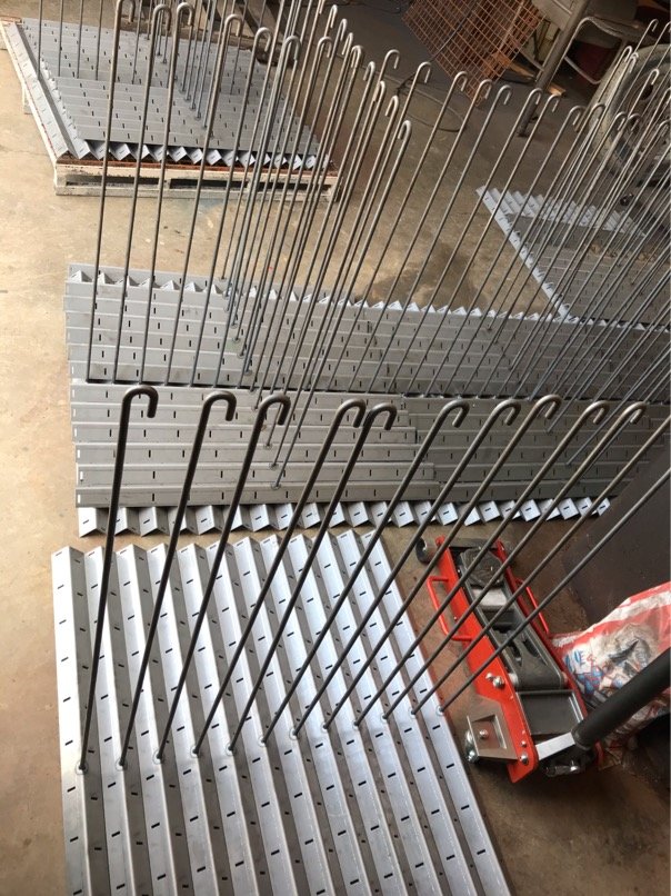

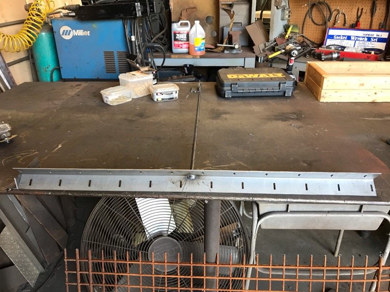

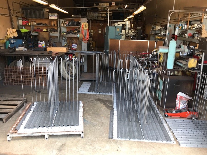

    Made some hooks out of 3/8” round and welded them to some fixtures for the powdercoater.

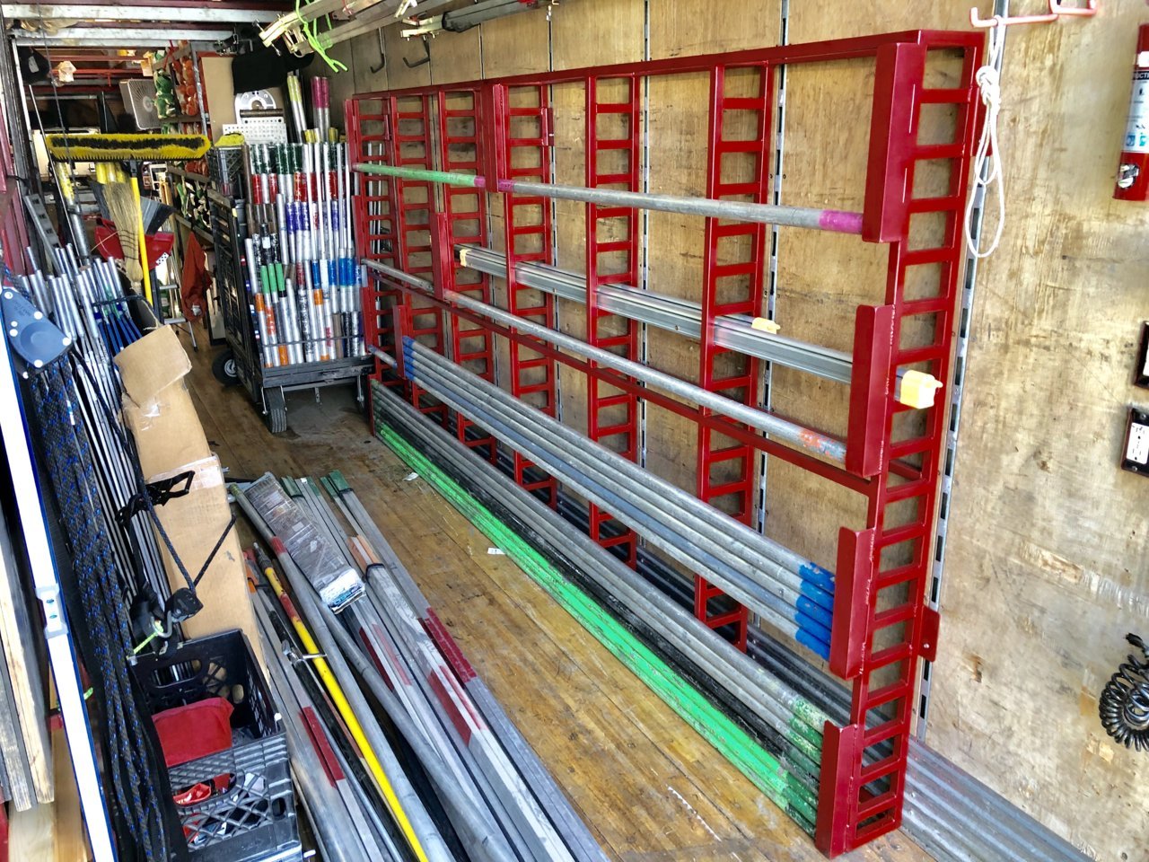

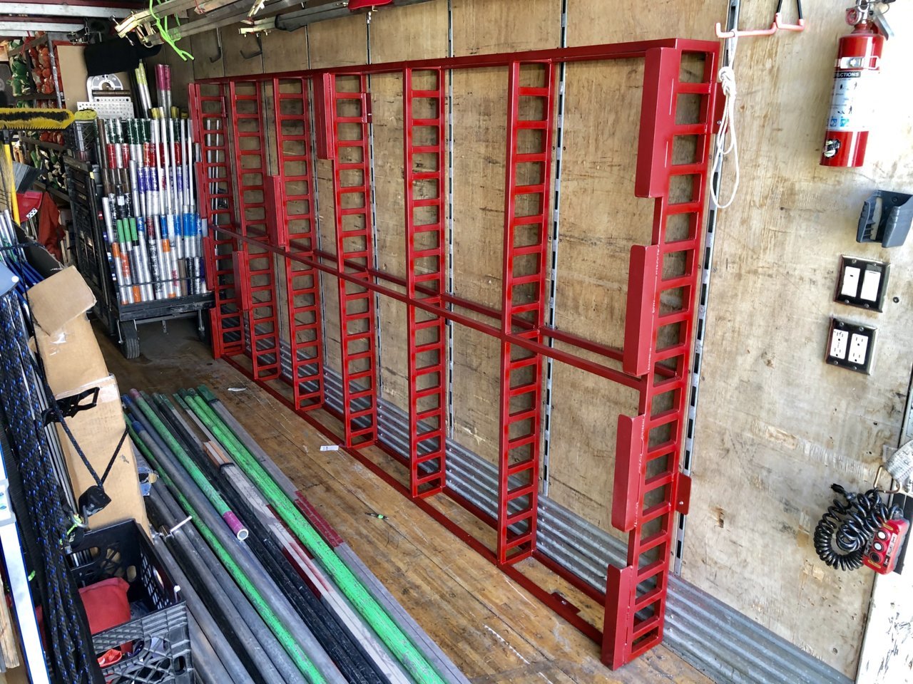

    Here is that rack all finished up that I built for my boss to go on his truck and store his dolly track. Also added some pipe holders on the outside so he could hold 8 pieces of each size. 12’,10’, 8’, 6’, 4’, 2’. We use a lot of aluminum pipe to rig things so we always have tons of it on the truck.

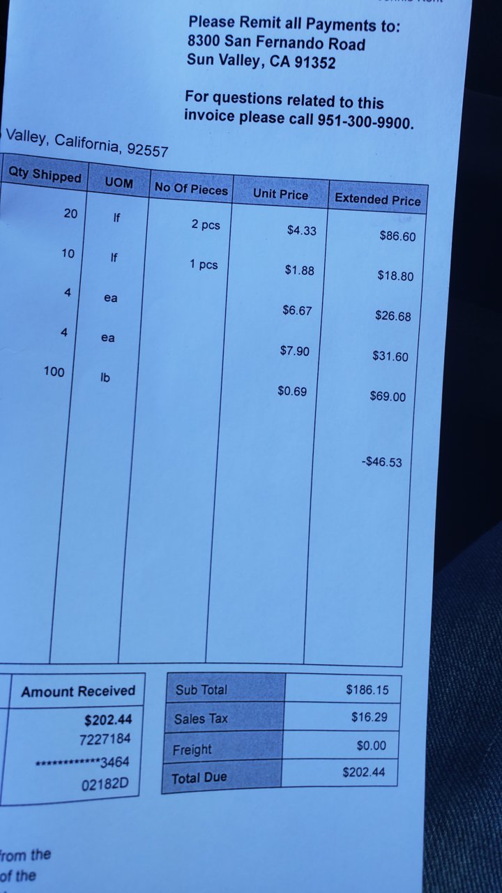

    Went shopping for my welding table stuff. 20% off total purchase. :headbang: :lalala:
    $202 for a custom welding table, I'll take it... and make it!! :welder:

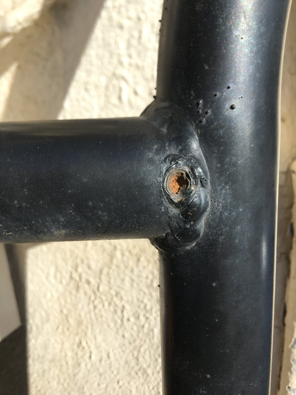

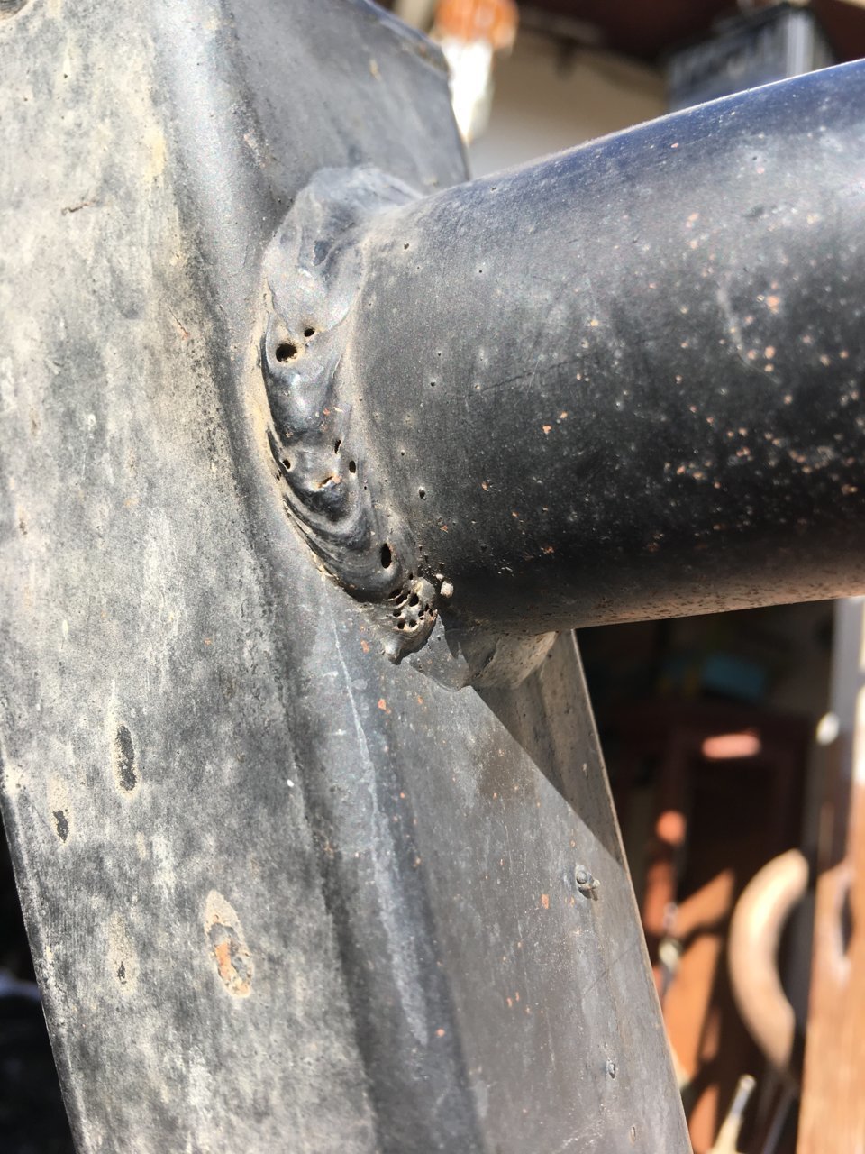

    Recently bought a set of sliders ( highly discounted) due to the poor fabrication and immense amount of porosity present. I’m gonna hopefully add step by step pictures of how to properly fix so that you can wheel comfortably.

    It gets worse.

    More something cooking off the inside of the tube then lack of shielding gas flow .
    Where they just sitting around never installed ?

    Shielding gas? What’s that? I thought the holes in the weld was good weight reduction. :homer:
