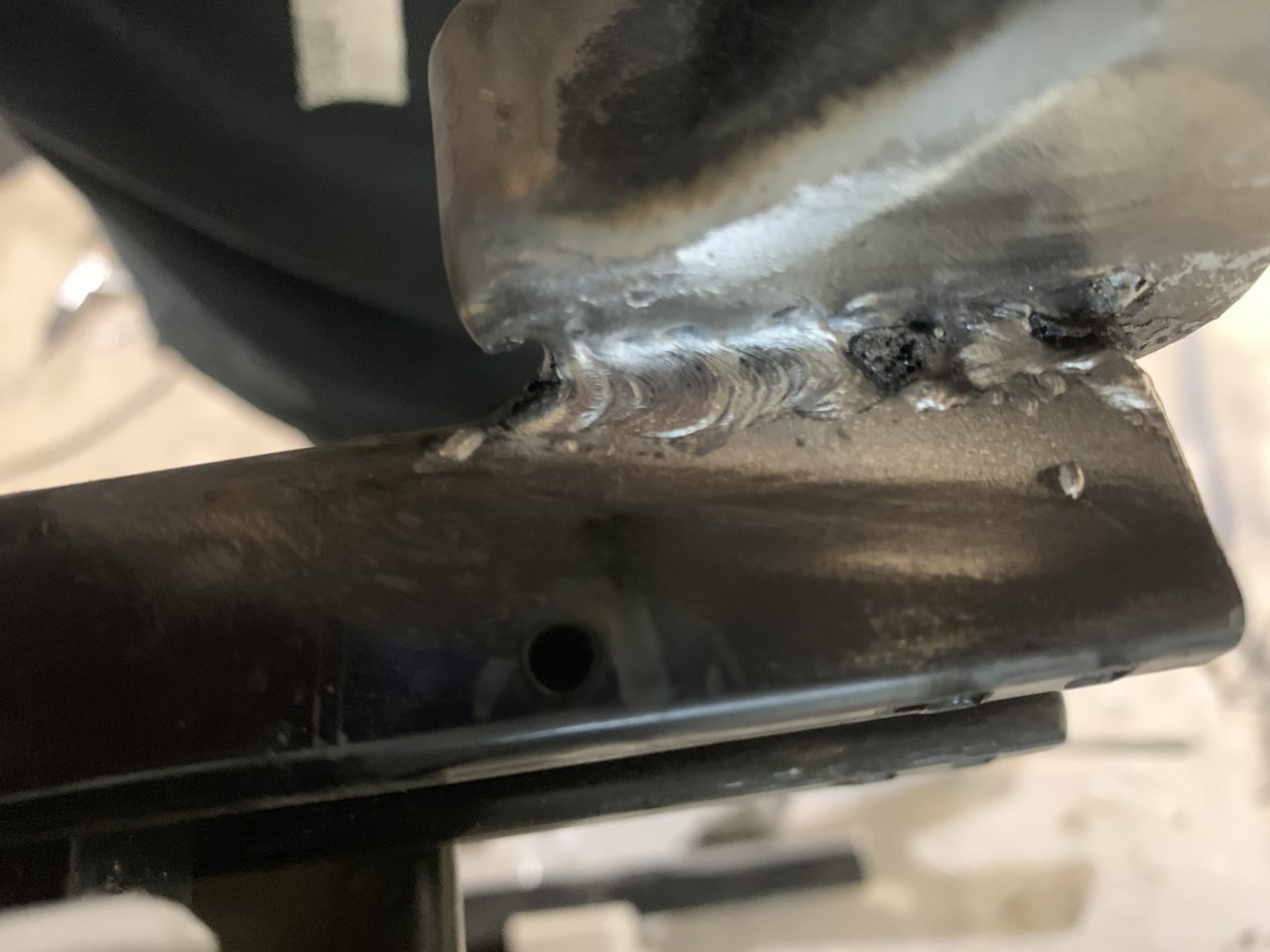

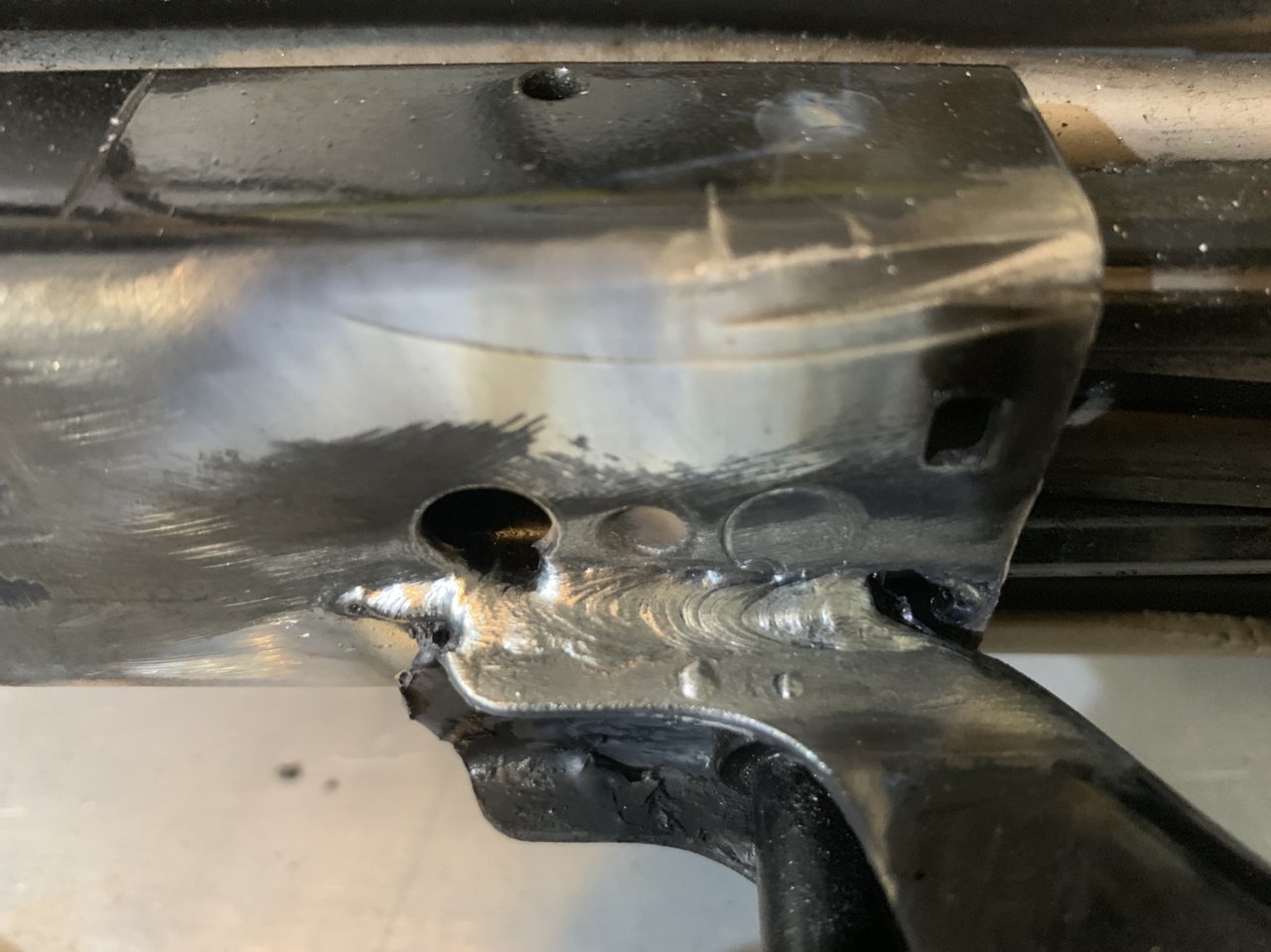

    Drop bracket lift and booger welds
    Speaking of new welders who have no idea what they are doing...
    Doing a seat swap project on my taco. Seats are out of an RSX and I cut the mounts off my current seat and am welding it to the RSX seat rails.
    Damn slag holes get me every time.
    (Don’t worry it won’t be left like this lol)
    But I’m happy with this one:
    Super thin material, less than an 1/8” for sure. Been jumping back and for between 6011 for filling gaps and 6013 on the tight fit ups.
  12. Oct 7, 2019 at 9:44 AM
    glorifiedwelder
    glorifiedwelder IG= @Liquid_Torch
    Feb 14, 2015
    #148647
    3,658
    jason
    Santa Clarita, ca
    double cab trd sport
    This is exactly the cause.
    Any hollow tube needs vent holes if it’s gonna be completely welded shut on both ends (which is most tube work). It’s super common with guys when they first start doing tubing work. You’ll see porosity in the ends of most of their welds as that’s where the expanding air inside of the tube was venting out the joint. You can wait for the tube to cool down and finish the weld, but that’s not 100% successful. Adding vent holes in between tubes is the ideal way to fix the issues. It a big issue when building roll cages.
    Same thing can happen when welding tabs or new tubes onto finished tubes tubes that have already been sealed as well.
  13. Oct 7, 2019 at 10:14 AM
    glorifiedwelder
    Feb 14, 2015
    #148647
    3,658
    jason
    Santa Clarita, ca
    Also I don’t think those sliders would of failed under use. In the grand scheme of things that isn’t that bad. If you think that’s bad you should see what 50% of the sliders I’ve seen in person, welds look like at the frame. And this are extremely poorly welded and in the vertical down position. Many have been beat the shit and still are holding on. I wouldn’t want to lift them with a high lift as the leverage will be the most at the frame plate welds, but I don’t see the falling off anytime soon.

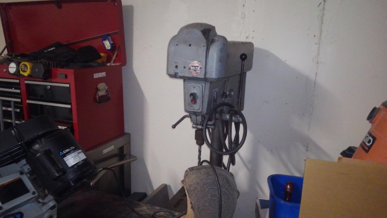

    work in progress
    gucci interior and chandelier.
    Pucked up this 1963 Rockwell 15-000 variable speed drill press a few months ago . Going to bring it back to life. Weights a ton and unfortunately is missing the variable speed parts, but I am closing in on replacements.1570506209327765669783.jpg
