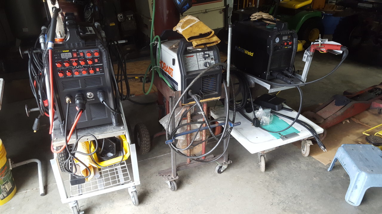

    Just wanted to pass along an idea I had a few weeks ago. I recently got a Tig welder and, of course, needed to build a cart. I always vow to use scrap except for the casters/wheels, but I broke with tradition. You can see by my homely collection, I usually stick to my scrap rule :) The one in the middle was an old school desk with the wooden lid. There's also a washing machine top in there.

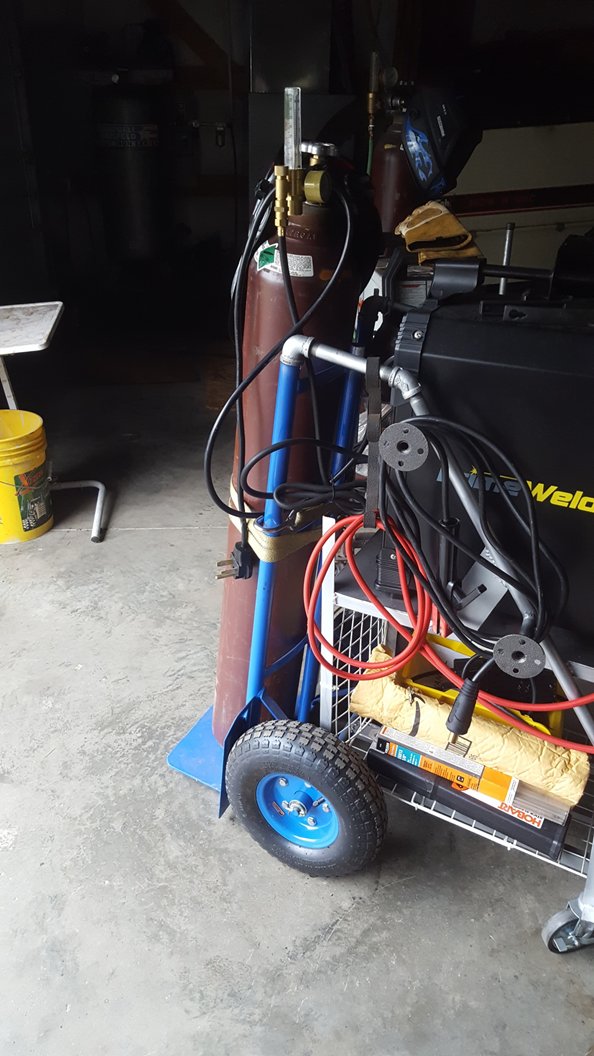

    On my Mig cart, I got lucky and had an old wall mount for a heavy duty fire extinguisher. Being round, it made a good bottom tray for my tank. But this time, I didn't have anything handy. So, I saw the Harbor Freight 700 lbs rated dolly was on sale for $39.00. Considering the price of the wheels I needed anyway, I thought why not.
    It turned out pretty good, I'll still will be welding some small keepers at the base to better secure the bottom of the tank, and add a better strap system. But overall the idea worked well. The key is having just enough forward tilt so the bottom of the dolly doesn't drag the floor, but also keeping the bulk of the weight off the small front casters so they swivel easily. If you get the balance right, the weight of the tank helps offset the weight of the welder on those front wheels because the rear axle acts as a fulcrum.
    By the way, for just an amateur, weekend warrior, I really recommend something similar to my lineup there: I have a 60amp plasma cutter, 150 amp Mig, 225 amp AC/DC Tig w/arc. My tig is not water cooled, but for me it's more than capable enough. The PrimeWeld equipment is really super value for us low hour users.

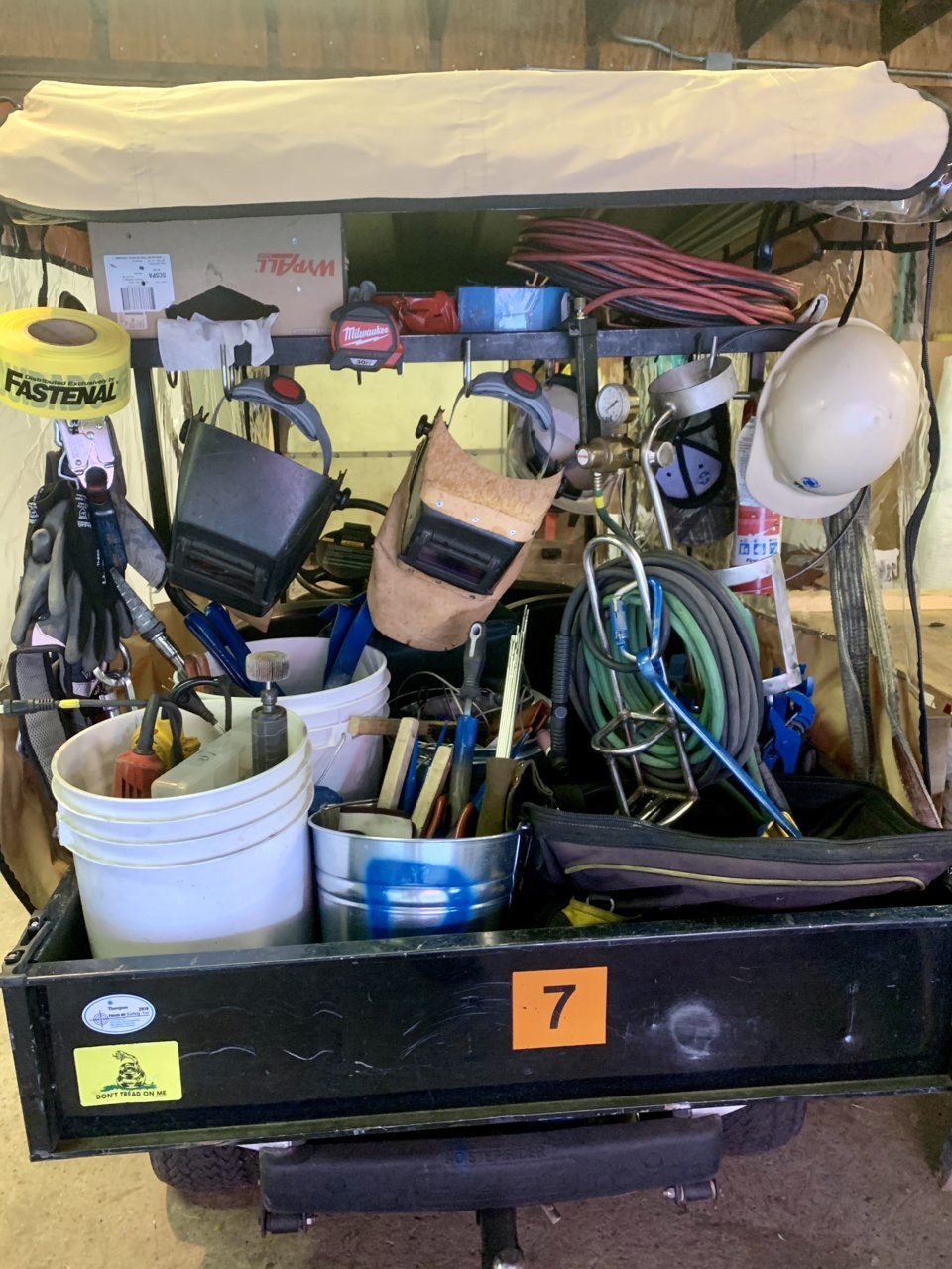

    my Mobile EZGO rig

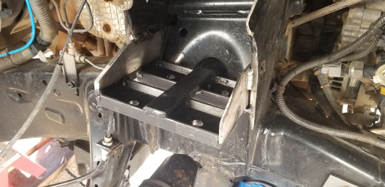

    So I'm in the middle of making new upper coilover mounts on the shock tower bucket; is there enough vertical stress supports on my current design?
    The coilover bolts to two 1/4" C-channel sections, which is that vertically supported by a 1/8" C-channel section and a 1/4" 2" wide bar.
    I'm a little worried about vertical stress.

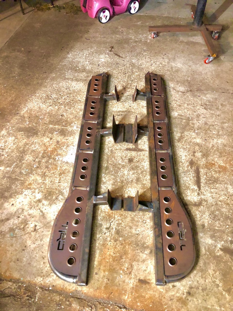

    When I have the extra time after work and on the weekends I’m trying to continue pecking away at my rock slider orders
    almost finished with this set.
