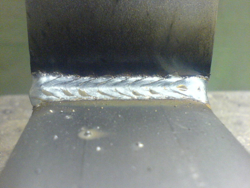

    I've been welding for 12 years. Pretty well rounded but haven't welded to much pipe in my career. Red seal, CWB...
    Here's some of my work from the past. I'd love to help if anyone has any questions.. Hopefully I can contribute!

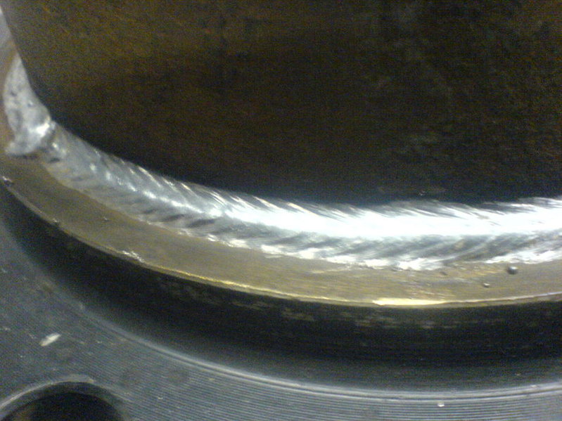

    welded some spindle gussets for a friend. it was my first time welding to spindles. what do you all think? any pointers?

    Looks good the heat is even and nice travel I personally would do smaller staggered stitches to avoid warping but all an all it looks good.

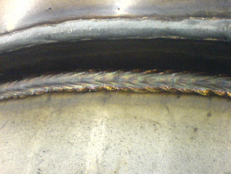

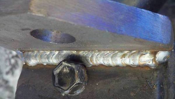

    Added a couple recovery points to my front bumper. I thought the welds were pretty good. Any tips to make them better?

    looks pretty good, Im assuming you had the heat all the way up?
    All I would say is avoid having bolt flanges sit on part of the bead:p

    Looks a little cold to me. Looking at it, it's hard to tell tho.
    How does the recovery point integrate with the bumper? Are they welded to the front of the bumper or are they T-shaped and poke through the bumper?

    Yeah heat was cranked way up. It's 1/2" plate so I beveled it and made two passes on it. And the bolt will be shifted a bit once I have the time.
    Yeah it could've used a little more heat. The bumper is bolted to the frame using three 17mm bolts on each frame end. I basically boxed around the end of the frame with 3/16" plate and then welded the 1/2" recovery points onto the forward facing piece of the frame box.

    The first thing i see is if you had the heat cranked way up your welder is too small for 1/2" plate. I dont see much penetration into the plate. Also you just welded it right to the font of the bumper? If im reading what you said right they don't go through the bumper and weld from behind it as well?
