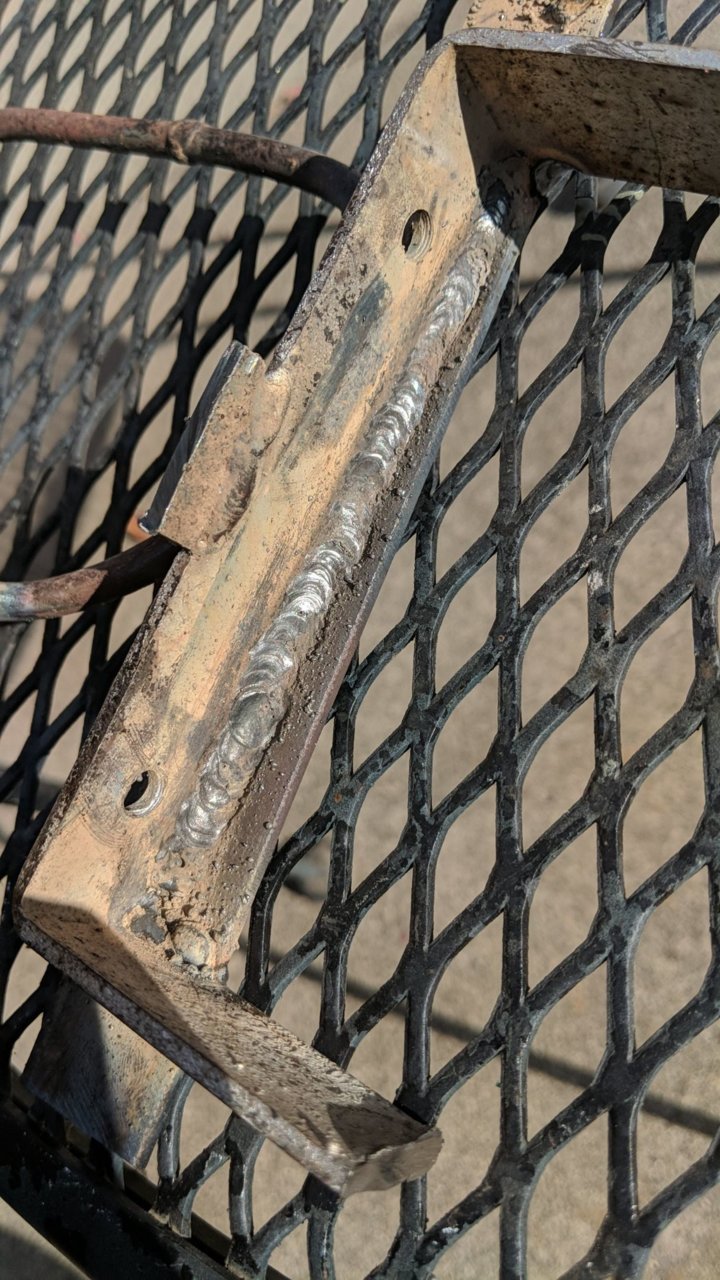

    You need to grind the dirt/rust/paint away where you weld. It has to be clean for any kind of wire welder.

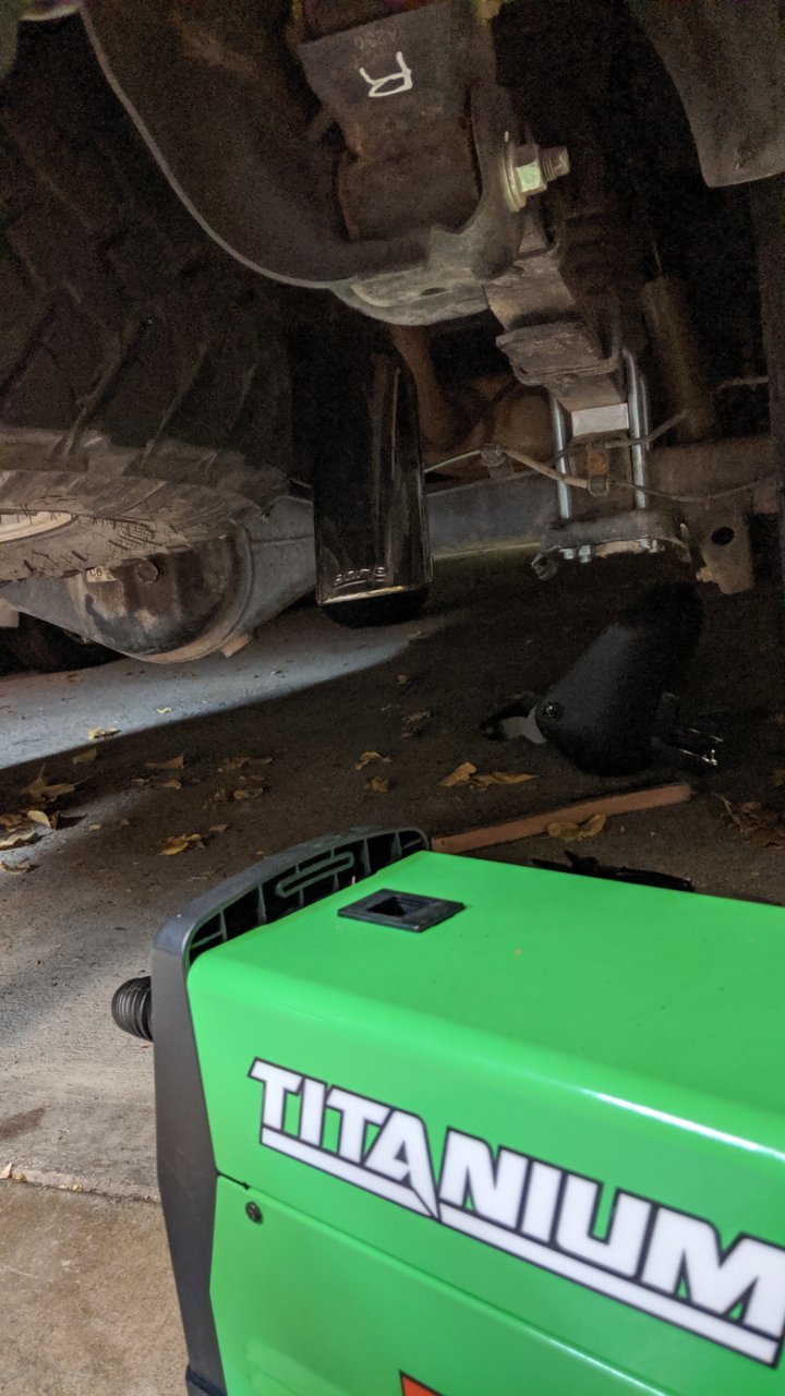

    Does that model have the provision to add a shielding gas? If not, take it back and opt for the next model that allows that feature.
    I think you have handle on making decent welds, you just need to spend time on prep work and think about getting shielding gas.
    Edit: I just checked, you need to grab the Titanium MIG140 to have the gas feature. It's $400 vs $200 that you paid for your present unit. With the holidays coming up, I bet a 20 percent coupon would appear for those welders.

    Oh ok so like down to bare metal on both pieces, or just make sure there's no dirt, rust, or paint on it before I get started?
    Also, is it bad if I see little dots coming through the exhaust tube I'm welding the tip to? No holes, just wondering if I'm running too high of voltage or something.

    Down to the bare metal, some even like to rub a little acetone on it before welding. I never do, but then again I'm just messing around in my garage. You want the metal to be clean clean clean!

    Ok sounds good, thanks. Do you think that weld around the exhaust tip should be strong enough? It's got a decent bead all the way around it but I never really cleaned the pipe up beforehand.

    If you are seeing dots appear on the inside, that means you are very close to burn thru. back off the heat just a bit.
    Ccrames2018 likes this.

    As clean as you can get it. The exhaust pipe bubbles are from dirtiness, the pipe may be aluminized and a combination of dirtiness don't help that especially with a flux cored wire. Flux cored wire doesn't give the best looking weld anyways. You started good, keep it up!
    Ccrames2018[QUOTED] likes this.

    The problem with 140 welders is they don’t like positional work, are more likely to give you cold starts when in the higher end of material thickness they can handle. And if you’re doing tube work they start to run rough once you get a decent amount of stick out
    not_nick and gpb like this.

    it’s pretty simple. Trying laying down some clean welds on coped tubing. Once you get into the insides of the coped tubing it can be really hard to keep a steady arc when you get into the corners of coped joints that require more than your standard wire stick out. And pray you don’t need to restart one of your welds with that much stick out. The 120
    Machines lack the power to get your wire flowing smoothly quick.
    as far as positional work. It’s easy to get decent welds in the flat position, but you’d be hard pressed to turn out a professional job welding something like a leaf spring hanger to the frame when you get into the overhead position. A little more heat can go a long way when working out of position. Especially if you aren’t already a proficient welder and understand exactly what the puddle is doing while your welding.
    if you’re just sticking stuff together it can be done with the 120volt welder. If you goal is to lay down professional quality welds it will me much easier to do with the 240v machine.
