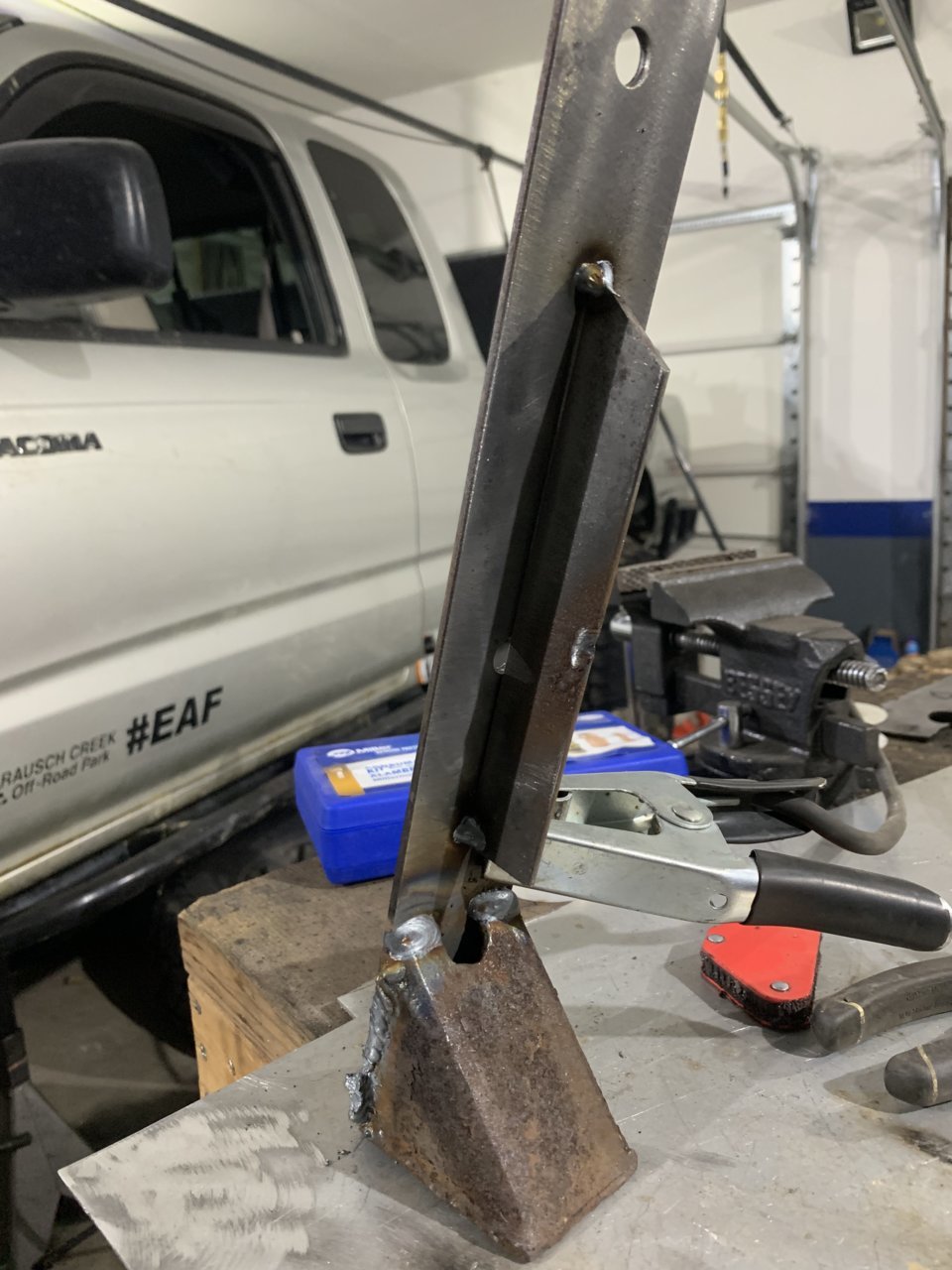

    I forget what the size is, but grab extra pipe. You can make all sorts of helpfully holders and braces out of them. Cut 2 U's in some angle iron and weld it to a post and you'll have a grinder and wire wheel holder
