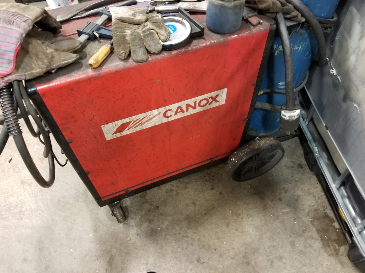

    And a very howdy to you too!:hattip::cheers:
    It's a work welder actually but does the job lol

    Lol. It looks the exactly the same as mine from the top, down to the nozzle lube.

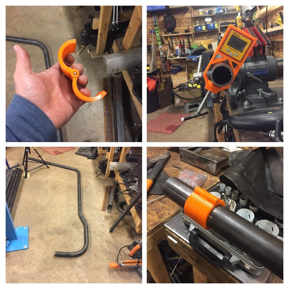

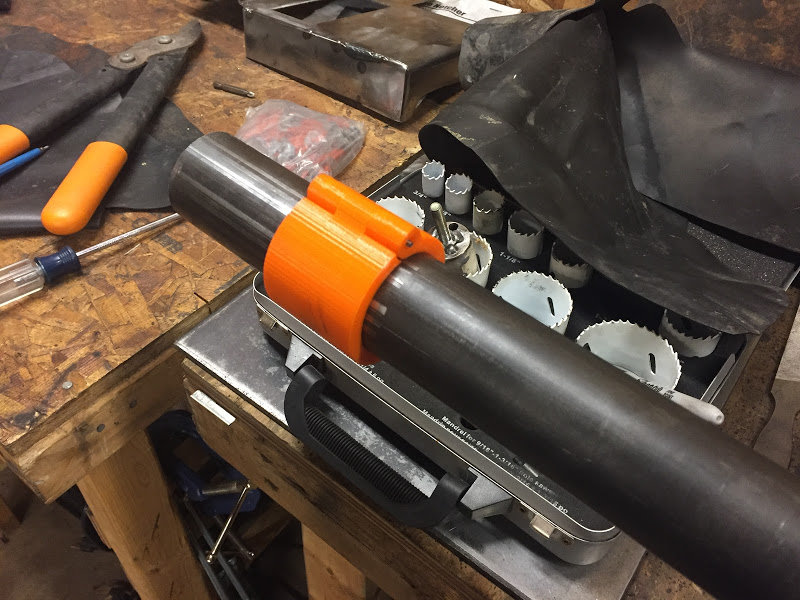

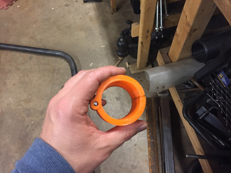

    Hey Everyone,
    here is a few things I created then 3d printed to help me with bending tube,
    1) Digital angle clamp, This one fits the digital angle readout I bought years ago when I thought I was going to get into woodworking.
    its a simple clamp, self centering on the tube, and holds pretty tight.
    2) is a clamp to help me make straight lines on tube for cutting / bend marks. I bet some of you will shake your head at this, but I liked the challenge of the design, and it works quite well. Its snug enough to not fall off when you let go
    UFcuIar028RuC0X2btEuoe2UDQr90PNBZCxo9kD__8e1b43fa19d95d52ea7106b6e444af0e85a91c3f.jpg
    Ip-A5SYP7sEEKk63fiO6ed7HCFJdKFZBn5X_ep1w_820689f4ff08379a32ff94239df5f3b02d86d455.jpg
    the result?
    not bad! the bloody angle finder's battery died 3/4 of the way through the project so I had to revert to an old fashioned level ( which worked well.. )
    she's pretty flat too!

    Weird,
    I can't seem to fix it...
    I'd like to add that I fully plan on putting these things on Thingiverse.com for free, I also want to make one so you can use a regular old 6" level. When my electronic level died, I put the bubble level on top and was able to continue that way. I was surprised how easy it was to use the bubble level to keep the same plane of bend. heck, its got 0,90, 45 & 180 degrees built in, and the "display" is multi-directional. That was an annoying mistake I did with mine, I had it facing the wrong way, so I'd have to keep running back and forth checking the degrees

    how about a collage.....
    TCrv3R7dRyDY8Vz2UrXd5_8DwhQikiVpHVH5cByp_90af2b89730e935c7ea1f7b278785c17120a8c72.jpg
    upper left: Pipe clamp open to show its hinged with recessed nut & bolt
    upper Right: Digital angle finder in my 3d printed holder
    lower left: the result of some bending ( thanks @Shmellmopwho )
    lower right: Pipe clamp on pipe, nice snug fit, wont fall off, and allows you to make a perfect line all the way round your pipe

    DUDE! Well done on the POB bracket!! That looks really awesome. And the tube you bent looks like it turned out just how it was supposed to! Awesome work man!
