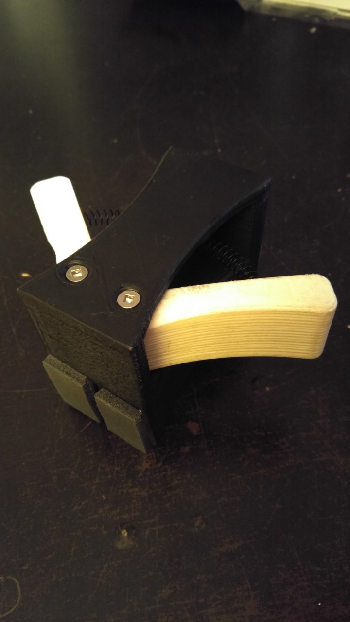

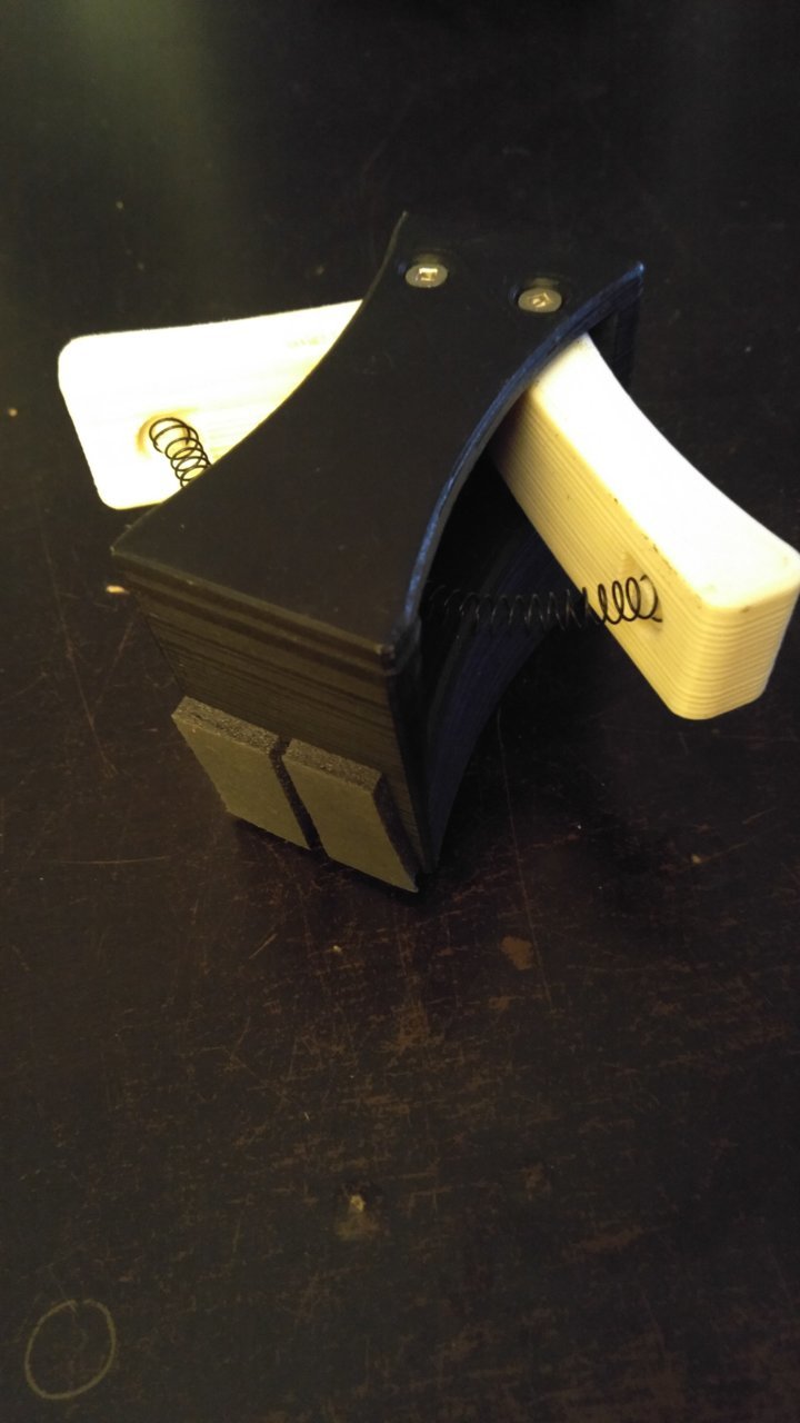

    the cheapest thing money could buy about 3 years ago :D
    I bought the "Anet A8" from gearbest.com a few years ago. It was in about 100 piece's ( on purpose :rofl:)
    assembly was easy. if you have ever done anything on your truck, or built lego, you can build a 3d printer. Hardest part was leveling the bed, and getting the print to stick to the build surface. ( hint! go to the dollar store and buy a cheap picture frame that has glass, cut the glass to the size of the print bed and use binder clips to hold it in place. No special "smoo" or Glue, or painters tape needed to make the plastic stick, just clean glass with glass cleaner and start printing, PLA filament sticks GREAT to clean glass, and pops right off when the bed cools down. Hell most of the time I use some cardboard and literally squegee the dust off the glass before printing and that works just as good provided you diddent get your fingerprints all over the glass from the last time you printed ) I'm no expert in 3D printing, but it sure is fun being able to design something on your PC and have it come to life.
    If you wanted to do more then just print with PLA Filament ( susceptible to warping with heat, AKA left in a car with the windows up in Florida or California ) then I would recommend a different printer. I can't seem to get mine hot enough to print with PETG or ABS ( PETG seems to be the favorite new kid on the block when it comes to filament, its seems to have the best qualities of PLA and ABS combined while being easier to print )

    Nice! I also made one that looks similar to yours. Good work!

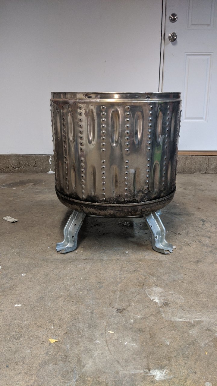

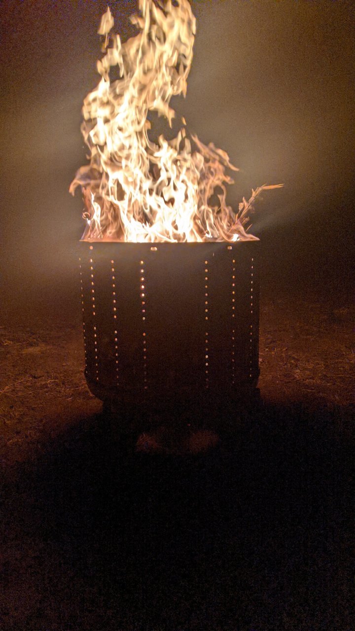

    lol!
    I was going to just do that, but it was my turn to get up with the kids that saturday, so while they played / Watched TV I created my version.
    your way was much faster, I guarantee it :rofl:
    the one in my pictures is V3, V1 & 2 were a hot mess

    Is that a clothes dryer drum? :rofl:

    I was wondering the same thing. That or a washing machine.

    Washing machine actually. It burns super hot because it gets air up through the middle. Cost just as much as the wire used. Basically $free.50

    Surprisingly common in CA. Growing up so many neighbors had old washer drums as fire pits. We’d pull them out in the driveways and hangout and whatnot.
