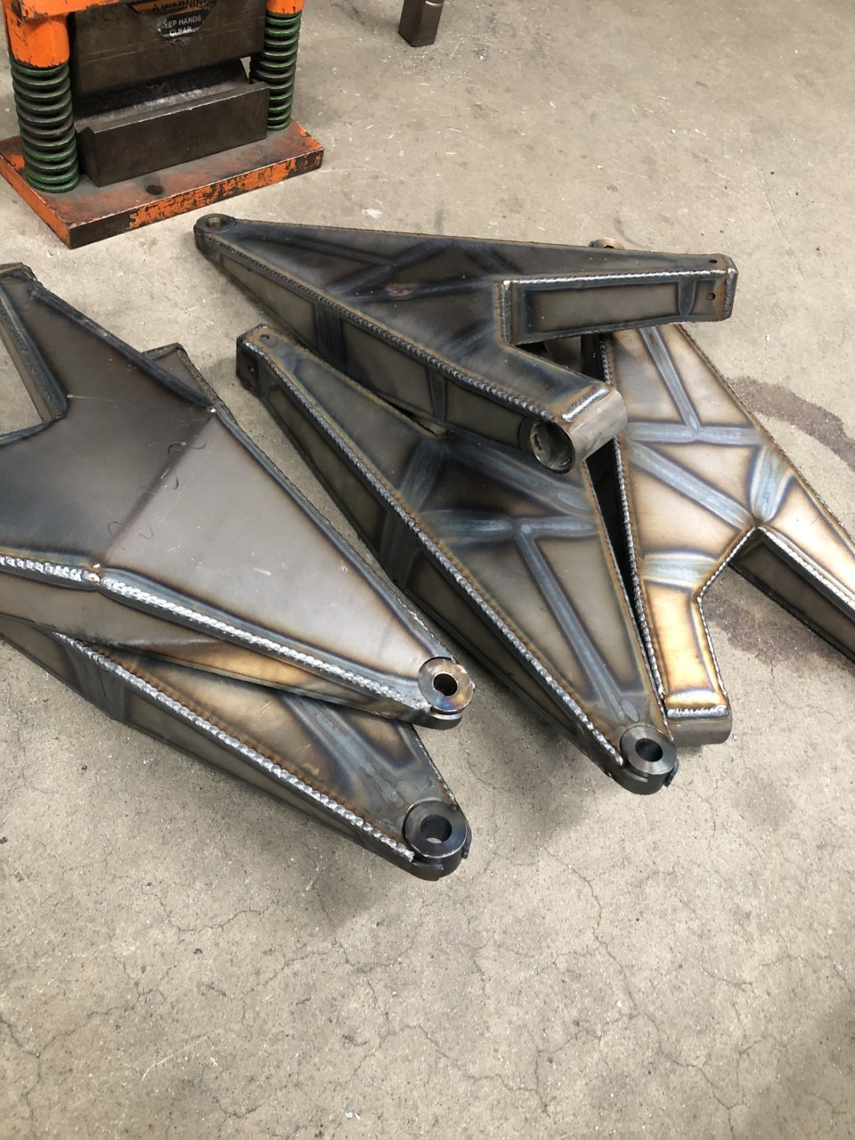

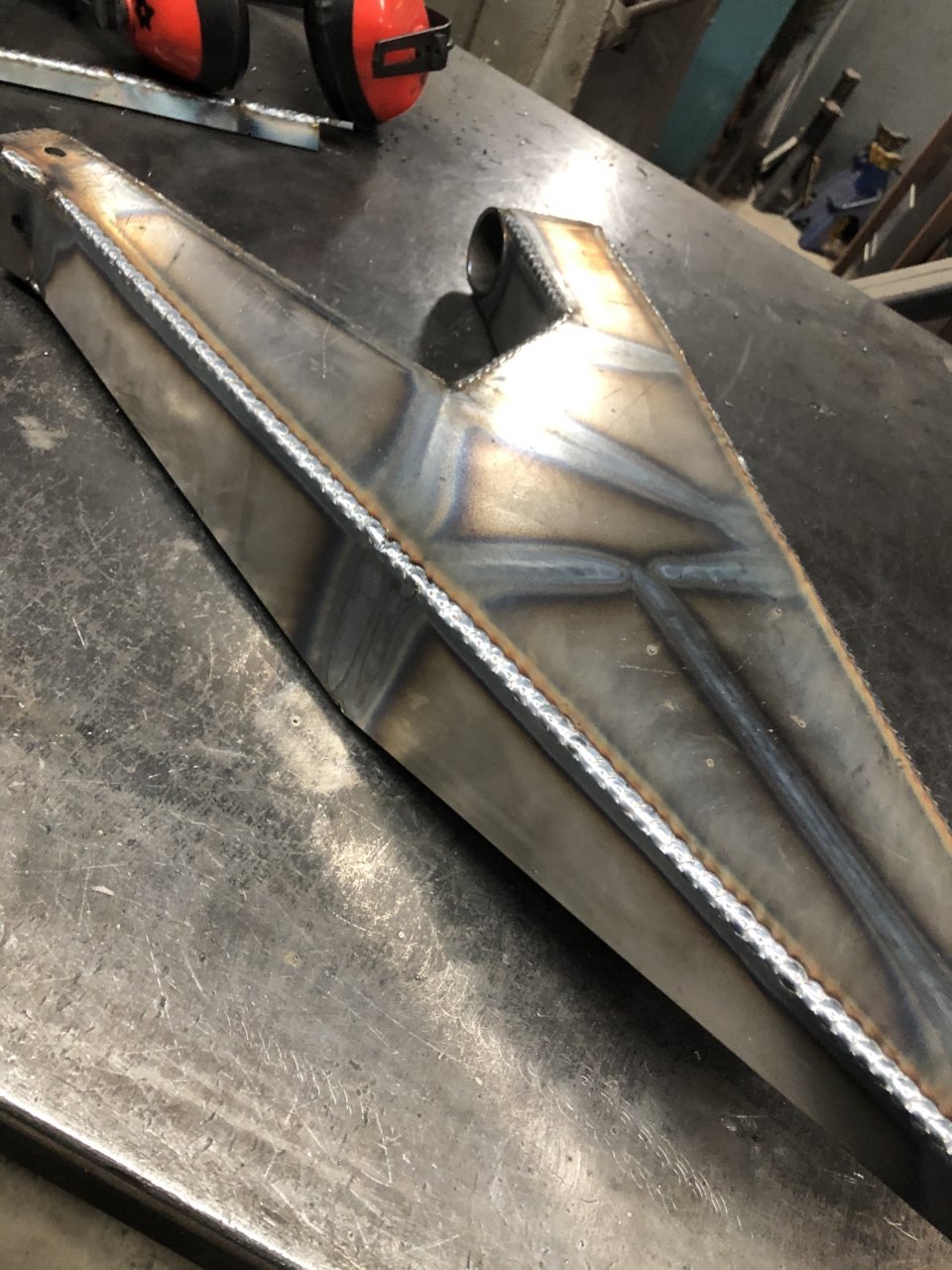

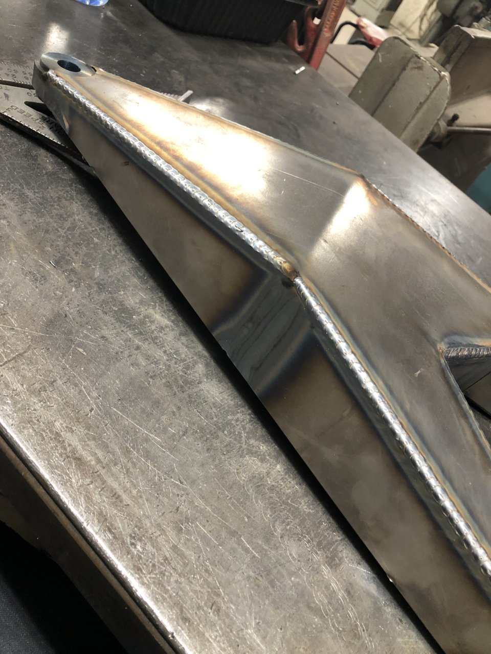

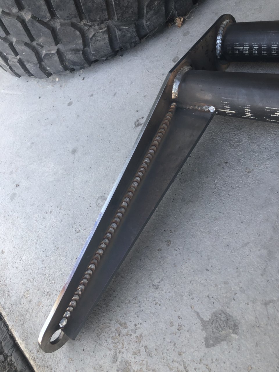

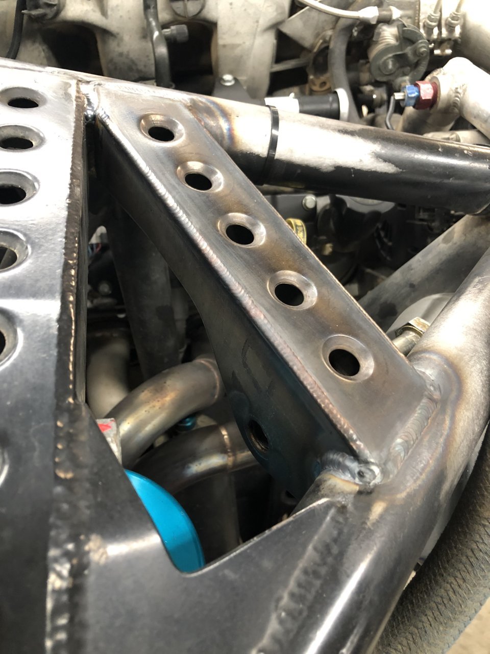

    In no way shape or form am I trying to be a jerk or call you out or anything so please don’t take it that way when I say this. I just wonder if you’re getting the correct amount of penetration on those joints with the method of welding you’re doing. Tack, tack, tack, tack along the whole joint seems as though you would have a lot of cold starts (evident based on the little crater in each individual “dime”) as opposed to running a continuous bead along the entire joint where the voltage and heat stay the same the entire length of the joint. The tack, tack, tack method is great for sheet metal and body panels so that you don’t get warpage or blow through the material but I just question it a little on something like an A arm. I’m no expert or anything so please educate me if I’m wrong. Really nice TIG welds in the last picture

    It’s not tack tac, I don’t EVER DO THAT CRAP!
    It’s a continuous bead with a miller 252 .030 wire, heat at 18.5, wire speed at 195... more than enough penetration for 1/8”

    Haha well I kinda figured you’d react that way. That was my main purpose for “I’m not trying to be a jerk or call you out” and finishing with “I’m no expert so educate me if I’m wrong”
    I’m not saying I don’t believe you, I’ve just never seen a continuous bead have a little crater at the middle of each “dime” like that. I have a few friends with that same machine and I’ve used one many times myself and haven’t yielded the same look with a standard whipping of the puddle motion. However, rather than argue about what it is, I’ll say I’m sorry for assuming and move on. Didn’t mean to offend you if I did

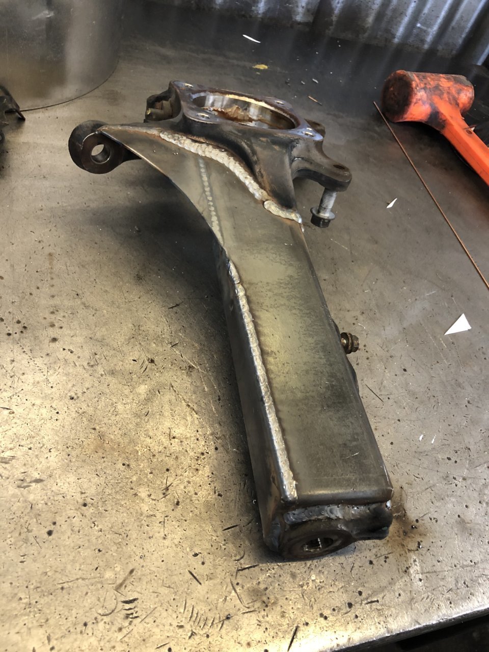

    Not offended at all. For this style of joint with 1/8” I do a “push-pull” method with the tip perpendicular to the material. I’m happy to make a video showing you or better yet just go try it yourself and you will see what I’m talking about.
    Here is a king pin spindle done in similar fashion... you can see there is lots of penetration

    And for the record I’m not offended at all! I love the questions... that’s how we all learn. There are many different styles of MiG welding combined with different machine settings, material type/thickness which can all result in different style looking beads!
    Here is a 1/4” thick VW beam I just glued together using cursive E’s... you can see the difference

    Okay cool man. Thanks for clarifying.
    Good I’m glad. These are definitely more like what I’m used to seeing. Looks good man

    Might just be how it looks in the pictures it does look different .
    Then we all have our own style what ever gets it done.

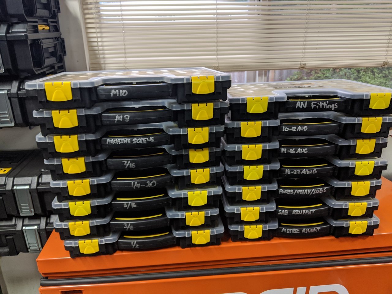

    I went a little crazy on Home Depot’s website as well. Grabbed one of those Milwaukee die grinders, a stubby impact, and a bunch of 4.0AH batteries. Also bought half a dozen of these small parts organizers. Gonna build a rack to hold ten or so. For now three are stowed under a tool box.

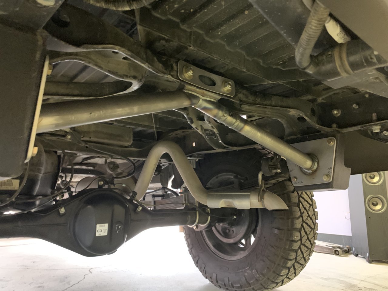

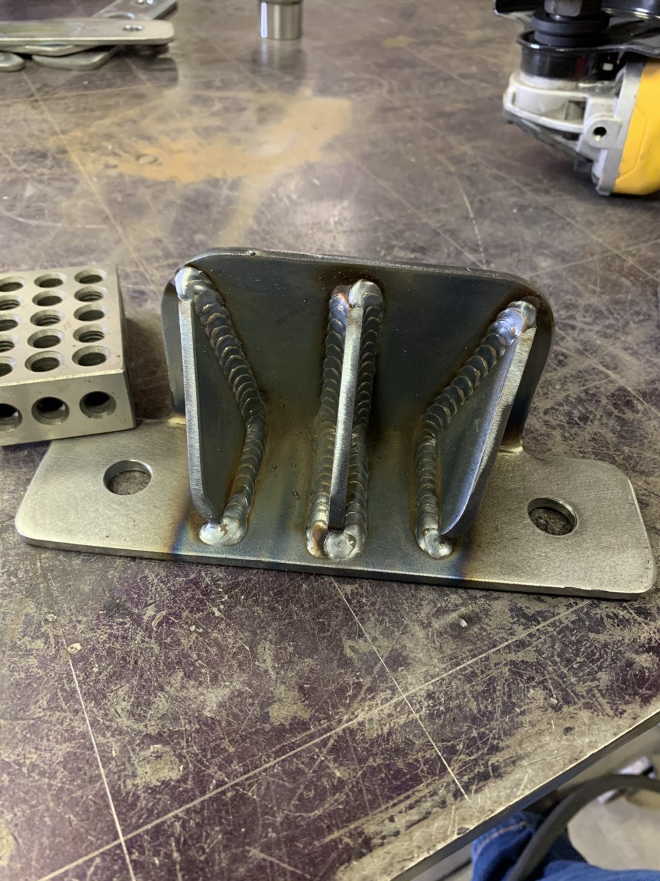

    Here’s a peice if 3/16 plate I welded up yesterday.
    It’s a mounting bracket for a leaf spring hanger cross brace.

    Those bins are nice. I went with the harbor freight version for the 20 bins vs 8-10 (depending on brand). Still need to build a rack for mine....plus fill the other 6 I have. Been nice to consolidate everything

    I’ve been using some Home Depot hdx ones for the last few years, but the patches and stuff are starting to break. Hopefully I’ll find some free time to get a rack going for mine.
