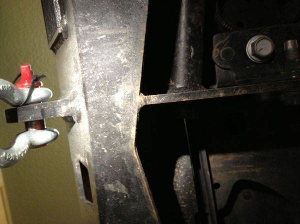

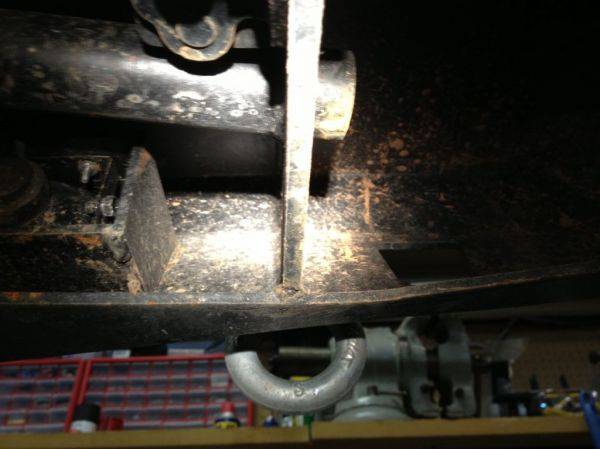

    Can you post up a picture of this? I have some bruteforce bumpers and I'm not sure if they are proper recover points now. I looked behind the point but it looks there's a sheet running behind it so I'm not sure.

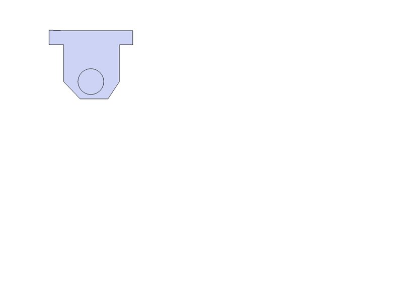

    My bumper is a Shrockworks bumper. Think of the standard recovery point with a 1/4" tab on ether side of the tab. All it does is keep the tab from coming through the bumper by spreading the load across the bumper.
    What Jerry is describing, slotting the bumper and putting the tab all the way through, welding both front and back does the same thing-the tabs Shrockworks uses add a bit more strength is all.

    I'm thinking he does but I'm not sure. Let me snap a pic and you guys tell me. I've used them to get tugged along before a couple times and haven't had a problem.

    Looks like this. Sorry for the crap graphic but you get the idea.

    Gotcha. That doesn't look like what's going on the pics I posted unless I'm not seeing it correctly. The points in line with that other piece of metal but it's two different pieces and I'm not seeing it flare out the back side to indicate it coming through.

    Yeah those are just T joint welded I myself would't pull too hard form those they could rip off pretty easily if you pull hard enough.
