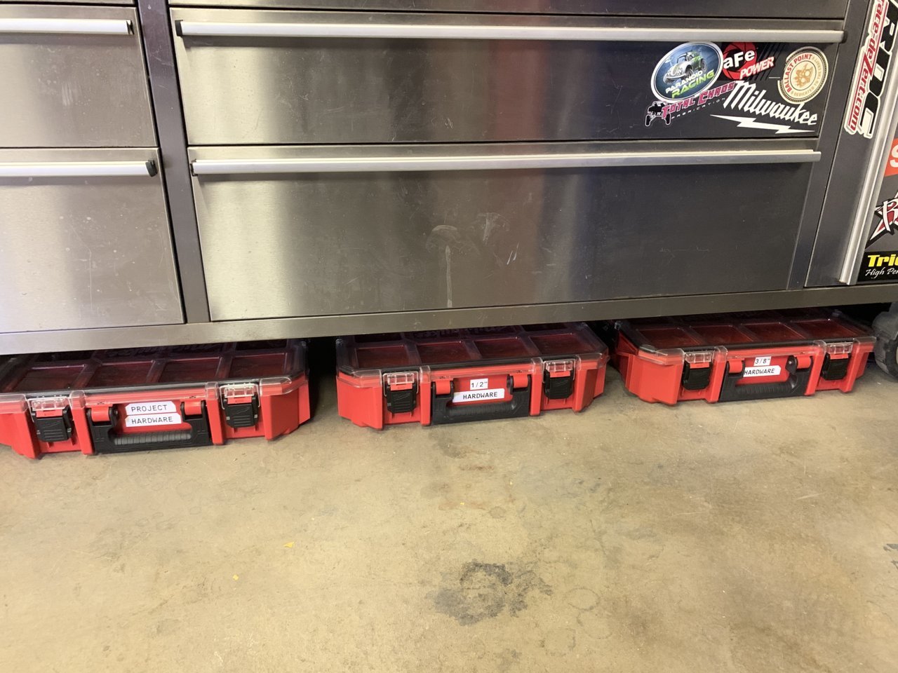

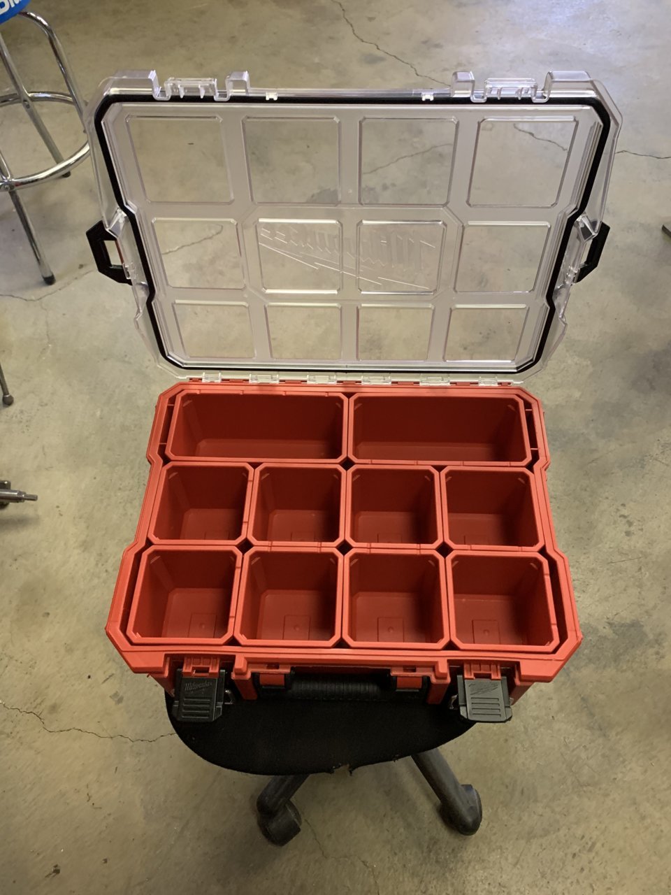

    I love my new truck but miss my Tacoma
    I got one of those stubby impacts as well. It is one awesome tool! Makes doing suspension work a breeze. It's now one of my all time favorite tools. I got one of those organizations too that I use as a tool box in my truck (I just took out the cups). How is the die grinder?
    Do you have a link to that table?
    jjsul likes this.

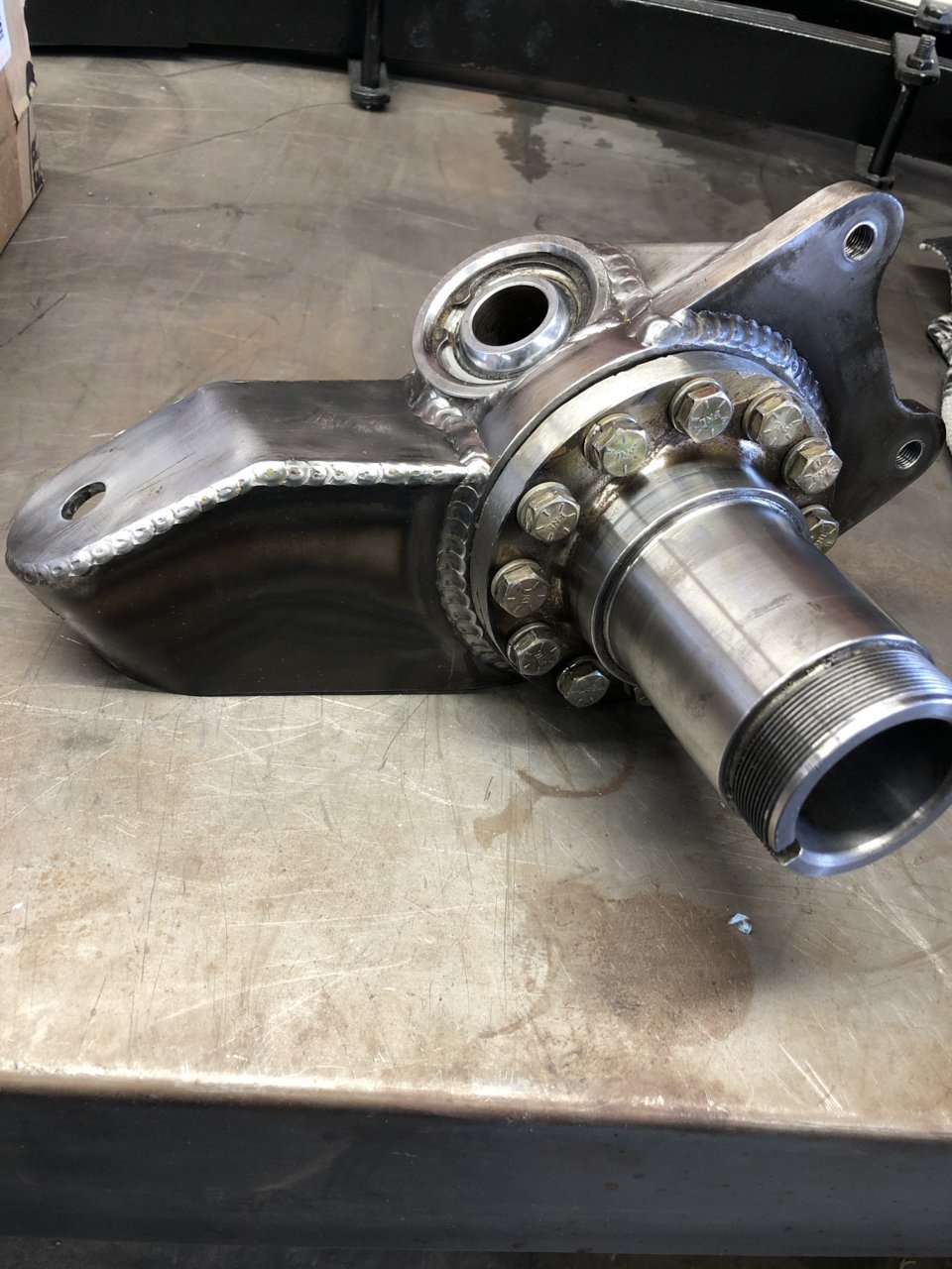

    Done a little welding on a customers bucket pin for a trackhoe this morning.
