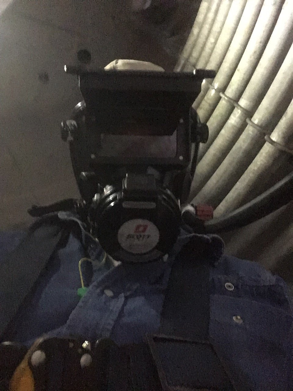

    Did somebody say respirator? D70A6807-07C7-43C6-992F-3026BC20E28C.jpg Normal days for me are under a supplied air hood inside chemical reactors.
    Replacing Sections of Damaged coils In this particular photo, Mirrors are used for welding back side of pipe. Rare picture as Phones are not allowed in most plants I work in.

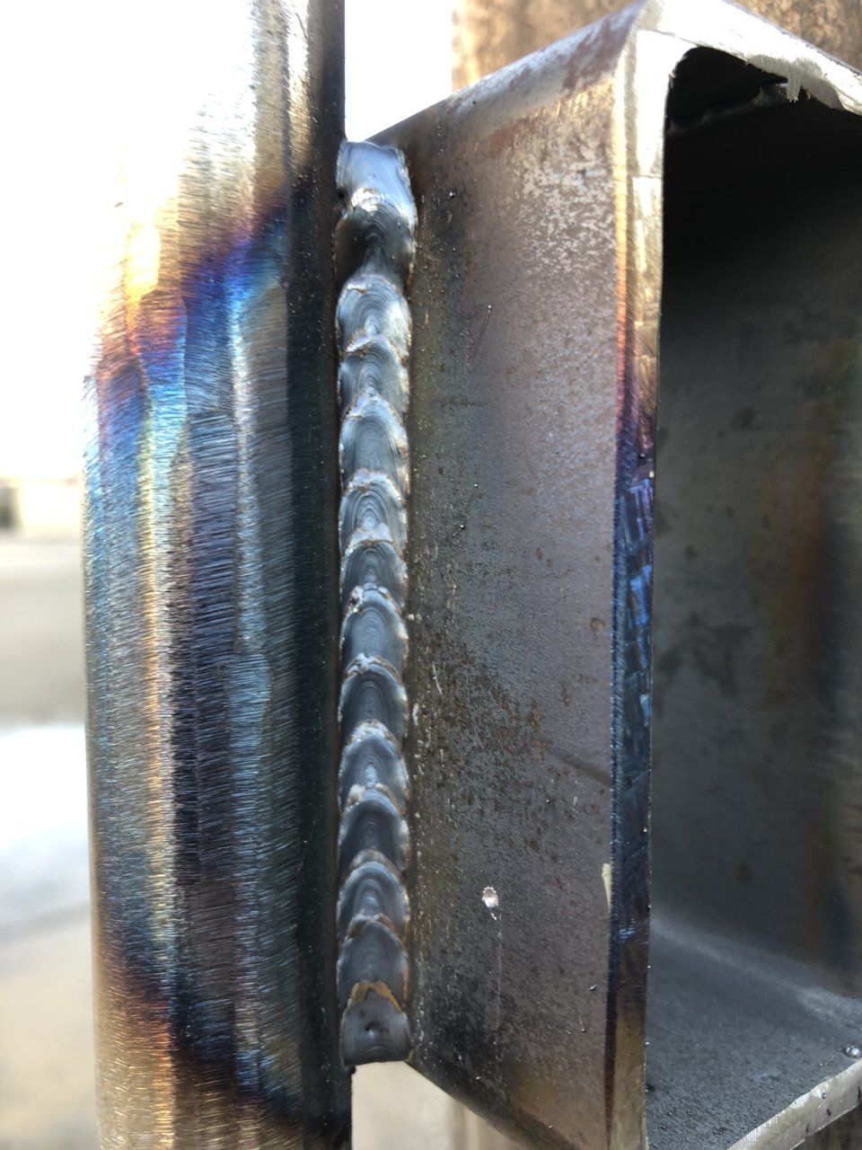

    Some practice today. I figure I should make something and not just practice and throw away the pieces. My wife's going to use it as a paperweight at work. Lol

    those welds look great! Nice paperweight!

    Thanks! I also got to use my new Milwaukee right angle die grinder and it's my new favorite tool to clean up the weld area. I picked up some 2" roloc discs from Amazon and they work great. Flap discs and purple stripper discs.

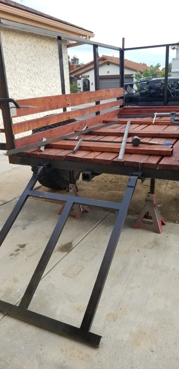

    Built an A frame today for moving around set walls at work

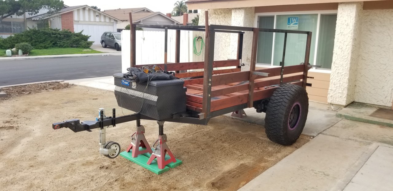

    Saved for future! Awesome set up.

    Thanks. I hope to one day convert it to electric/hydraulic

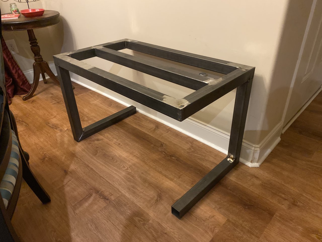

    Working on a Christmas gift for my mom

    those are nice. that pro tool electric hydro ram is pretty sweet.:drool:
    I just want a basic set up to get some shit done. someday

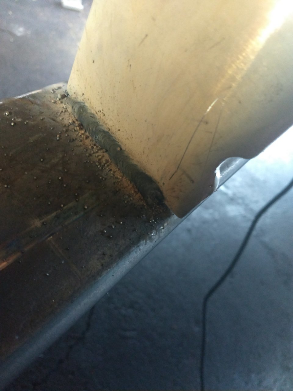

    Here is a pic of a weld I did on one of the 1/4 plate supports to the main tube so maybe you can get an idea of where my welding skills are. Sorry about the uncleaned flux core weld, but I am away from the bumper and can't get better pics for a few days.
    The supports are fully welded around the edges as well now as well and have gussets to support them even better.
    Edit: more than happy to take any suggestions on how to weld better if you have any suggestions looking at this as well

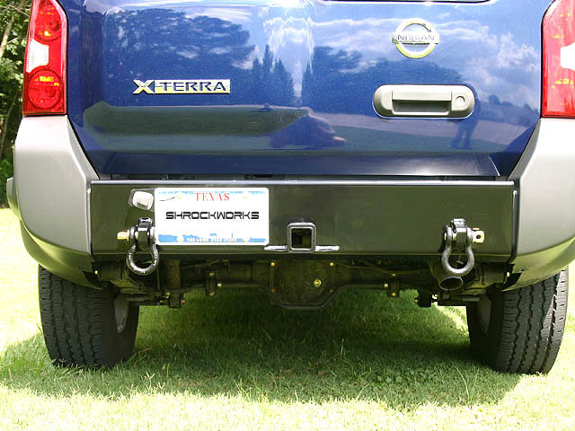

    It would be setup kinda like this:
    The receiver would be surrounded fully by the bumper on 3 sides with the 4th flush with the bottom of the tube. The only thing I really tow with any frequency a 18ft aluminum bass boat (~3000lbs fully loaded) maybe 1,000 miles a year.
    I planned on hooking the safety chains to the two 1x1 tubes on the backside, but after looking at this I might make the hitch stick out a bit from the bumper so I can put the chains on the outside on two tabs like this and that would also help with forces pushing the hitch into the bumper.
    I currently leave my hitch with a locking pin in the receiver about 99% of the time, taking it out only when I might need the clearance so I wasn't super worried about it being a big pain to install and remove, but it would be nice.

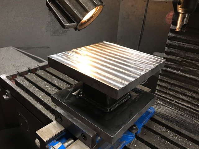

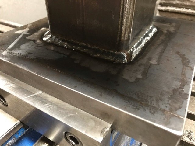

    Welded this piece together for a customer and in the process of machining it flat.
