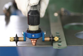

    If you’re making straight cuts set up a piece of angle iron and use it as a fence.
    I have one of these things. It came with some consumables I bought. If I’m gonna be ripping a bunch of pieces or making a bunch of cuts I want held to a tighter tolerance I use the roller guide.
    I’m sure some of the guys in here will have better advice. I don’t do a ton of manual plasma cutting these days and when it do it’s to remove cam tabs or rip 5x8 sheets into smaller sizes for storing and easier loading into the plasma table.

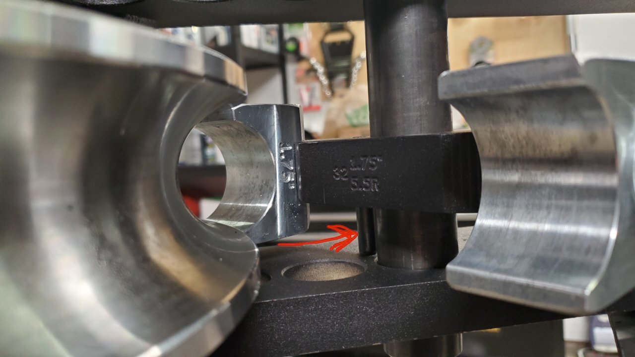

    Wtf? Any idea what's going on here?

    The little metal dowel next to the pin needs to be adjusted a little to where the follower sits at the same height as the die. I drew a red arrow to it

    Gotcha thanks. So basically push it in a bit.

    push the pin down from the top of the follower so it makes it a little longer and shims up the follower to the same height as the die
