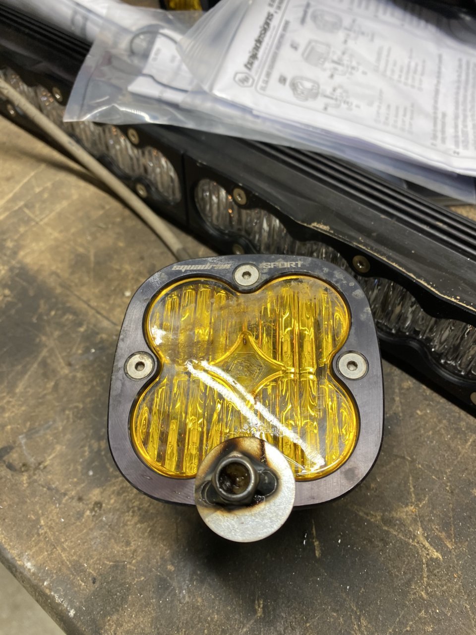

    Gotta love having a welder. Rounded out Allen bolt? No problemo. I was swapping out lenses so I wasn’t worried if this one got messed up, but to my surprise it didn’t.

    For rounded small allens like that you could also try using the next size up torx bit. Hammer it in and it should bite. Screw is garbage afterwards but it’ll come at least.

    That woulda been a good idea too. I know that trick but it escaped me. Must be the 4 hour drive I had this morning. Yeah we’ll go with that...

    If it came out, it works either way. I would’ve been worried about burning the anodizing in the bezel By welding the nut on. But then again, I’m not opposed to rattlecanning expensive things. Haha.

    Ha, me neither! It was also kinda a test to see how rugged they are, and they passed. Granted it was only a few heavy tack welds really, but I was happy with how it all turned out.

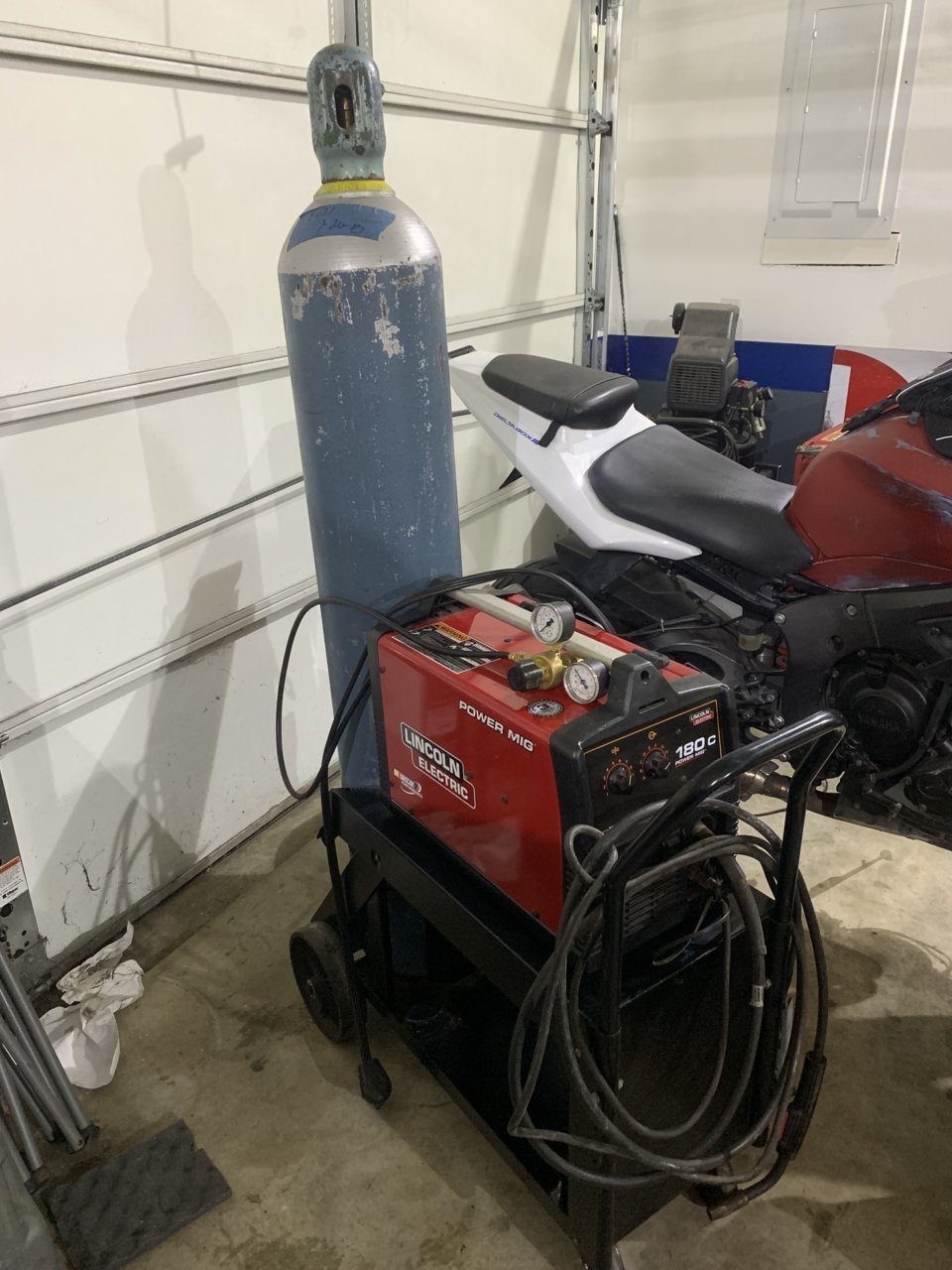

    My new to me setup:
    $600 for the tank, welder and cart. According to the serial it’s 10 years old but In great condition. Ran a bead with it in the guys garage and it worked great.

    Looks great! Must have been under a cover it's entire life.

    Nice. When I decided to start building stuff again I bought that same welder to get myself started. It ran great. It should serve you well.

    Just make sure the tank isn't a rental before you go fill it....
