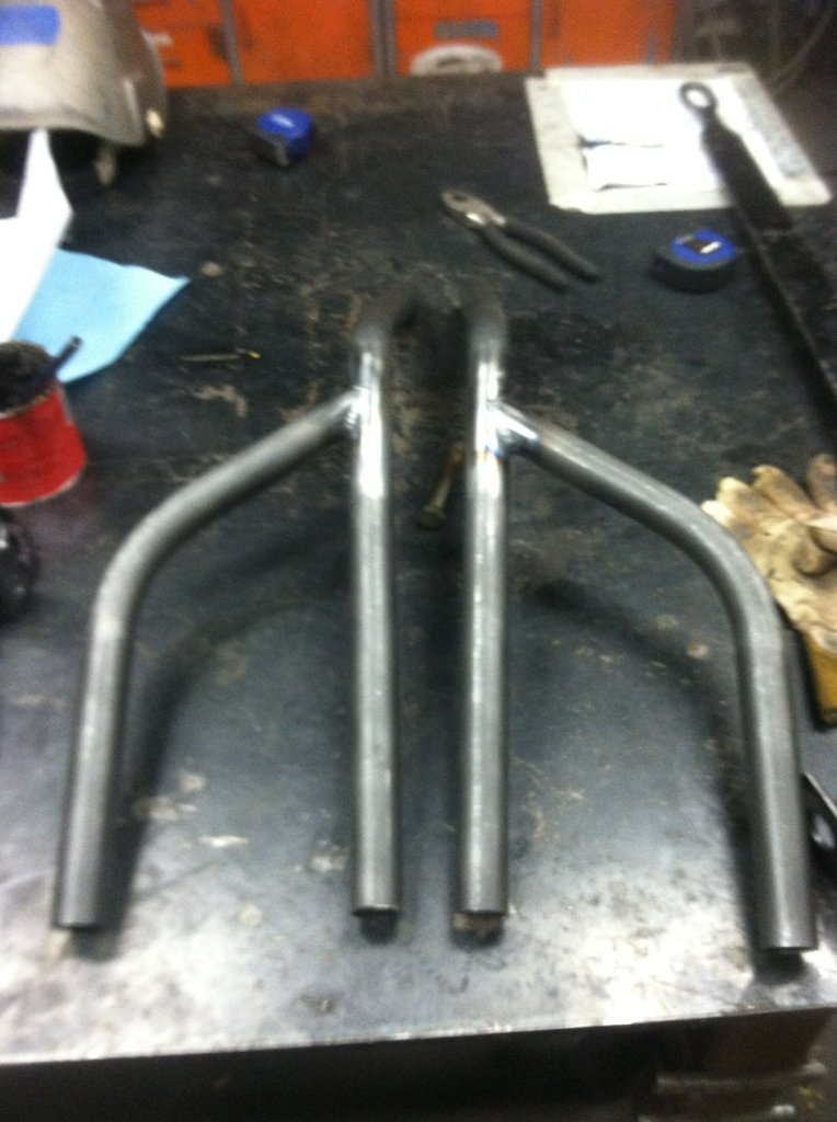

  20. Feb 7, 2013 at 7:10 PM
    #1360
    steve o 77
    steve o 77 braaap
    Nov 29, 2009
    #26726
    19,917
    Steven
    In a corn field, OH
    1990 Chevy Siveraydo
    245k+ miles, rust, working AC, bald eagles
    Rear suspension arms
    Jesus this pic sucks.
