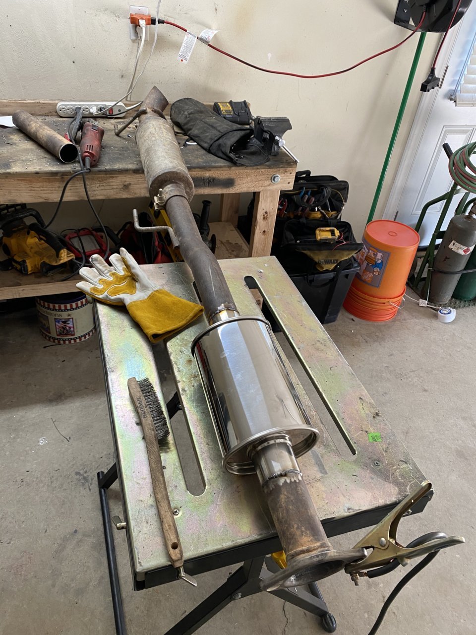

    What would cause a ridiculous bright arc? I checked my helmet and it’s working normally. Had all the settings maxed out and on shade 13. Verified it wasn’t the helmet by looking at the sun and welding some other mild steel.
    I was welding stainless steel with normal filler wire and C25 (I know, not exactly ideal) but it’s just an old free exhaust I got. Is it because it’s SS? Because I’m using the improper wire/gas? I ended up having to position the arc behind the gun so I couldn’t see the puddle. Welds still came out decent enough though.

    I would venture either your cover plate was getting dirty or you had the hood positioned just right the sensors where blocked.
    At 13 I would not have been able to see the arc
    Nothing with the process should have caused you to get flashed

    That’s what I thought, assumed it was the helmet which is why I did some other testing like looking at the sun, welding mild steel, messed with lighting near me, cleaned off the sensors. I don’t know, at a loss. If it continues when I weld other things I’ll warranty the hood.

    By chance there was not a Mirror behind you ?
    Arc reflects off Mirror onto the inside Cover plate it has happened but the Mirror has to be involved

    White will reflect but not flash like a mirror
