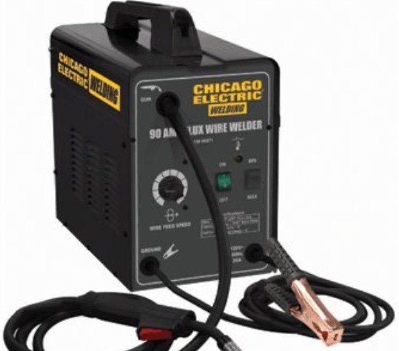

    Chicago electric 90 amp flux core welder guy used it for basic repair on his farm and didn't use this welder anymore.
    Picked it up for $40. I know it's a cheap welder but should get me started learning the basics.
    I ordered an auto darkening hood and a respirator earlier today. Already have ear protection laying around.
    Anything else I should get besides some gloves?

    Yep, it's a cheapy. It is a rough unit to learn on, but if you can get some decent welds with it, better machine will make welding easy.
    Just don't let it discourage you. Take pictures and let us give you constructive criticism.
    Like I said, it is the last machine I would let someone learn to weld with, but if you master it, your next machine will give magical welds.

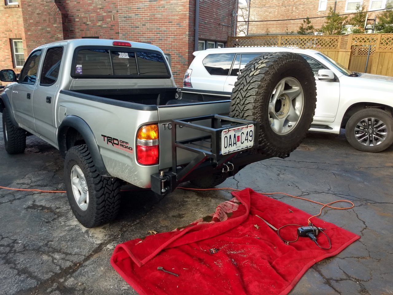

    Finished up my bumper today. Pretty happy for my first big project like thisIMG_20191231_143642341_HDR.jpg

    Awesome! So glad you made the box bigger than normal. Not everyone needs to haul fuel cans.

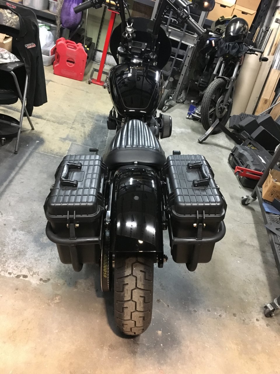

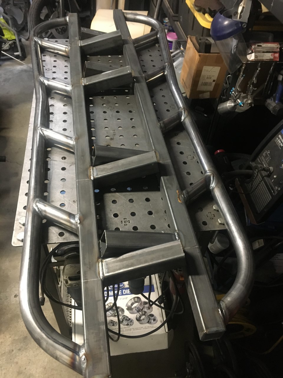

    The larger center radius just means that you’ll be making larger turns. Depending on what you intend to make that’ll limit how tight you can make turns and how compact your overall design will be in the end. This comes into play more so when making bends closer to 90* and beyond. For my sliders I make 55* bends at the front and use a 3* bend for my kick outs. I could go with a small or large radius and it really wouldn’t make a huge difference overall. Example:
    But if you plan on making roll cages or engine cages where space is at a premium and you have to keep things tight, you’d be better off with a smaller radius. Each one has its uses. I made these cradles for pelican cases for my scooter (With the help of @glorifiedwelder bending the tube for me) a tighter radius would've kept them more compact but in the end it wasn’t a huge deal and I’m still super happy with how they came out. Besides, when you're borrowing tools (dies) from a friend, you work with what you have or you pony up for the dies specific to the job.
