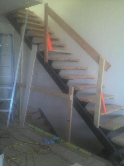

    made some stairs.
    Still have to do the railing and patina the whole thing.

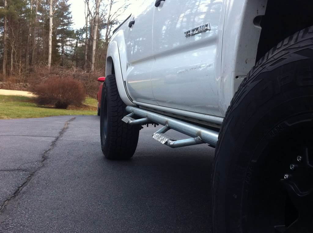

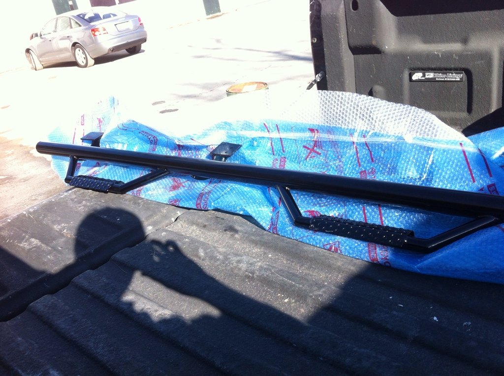

    my last project just before paint
    D2BA0325-17C6-4B8B-AEAE-6749B3C82038-334_f8501149a8cf8b4681ee3f4310ad623762602c92.jpg
    just picked up from paint
    F228660C-42CD-471D-84DE-F560FB9B6CBA-679_df900d22353309aaeef215773311a23c0d409335.jpg
    just after install
    7C1D9403-A841-4724-AF0C-305E10914168-679_58554e56d0c77bfdd4b07a4d6890215f3c71ca00.jpg
