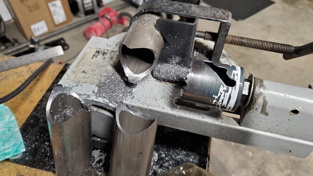

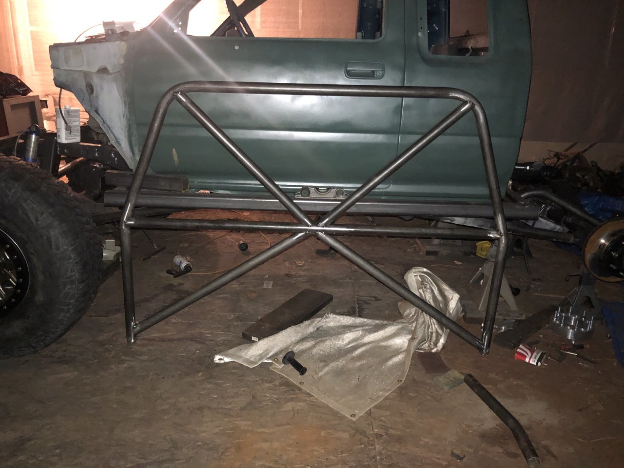

    Man I need to get a notcher
    Doing this with a grinder ain’t fun
    Bottom 2 are coming off to be redone

    HF special. Quality hole saws. Good investment to get started.

    What is the advantage to the 4 and 1 hole square

    They are great to use. I have all sizes and use them everyday

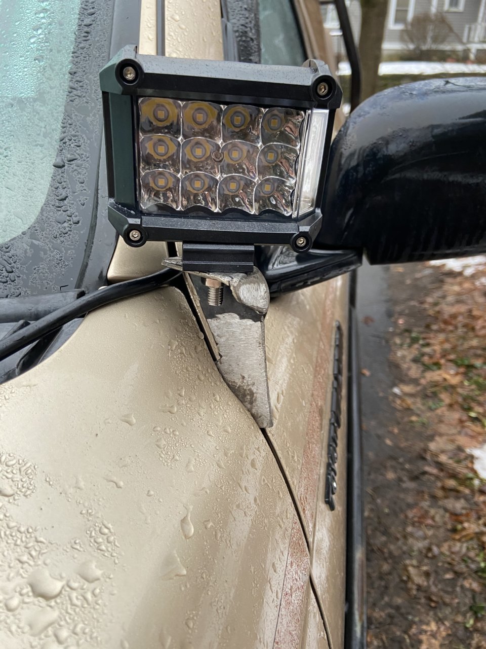

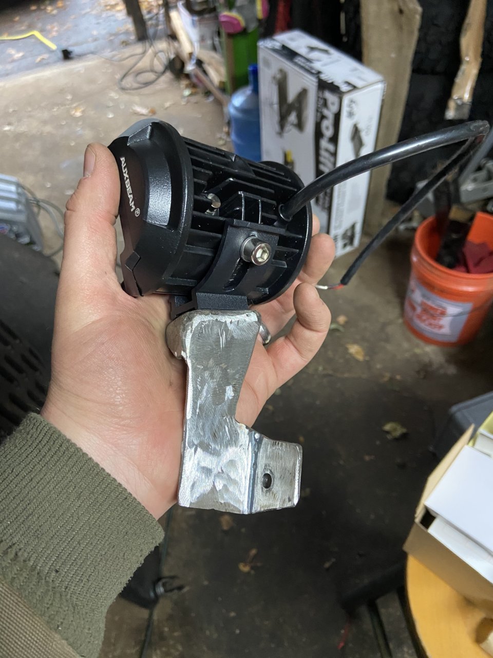

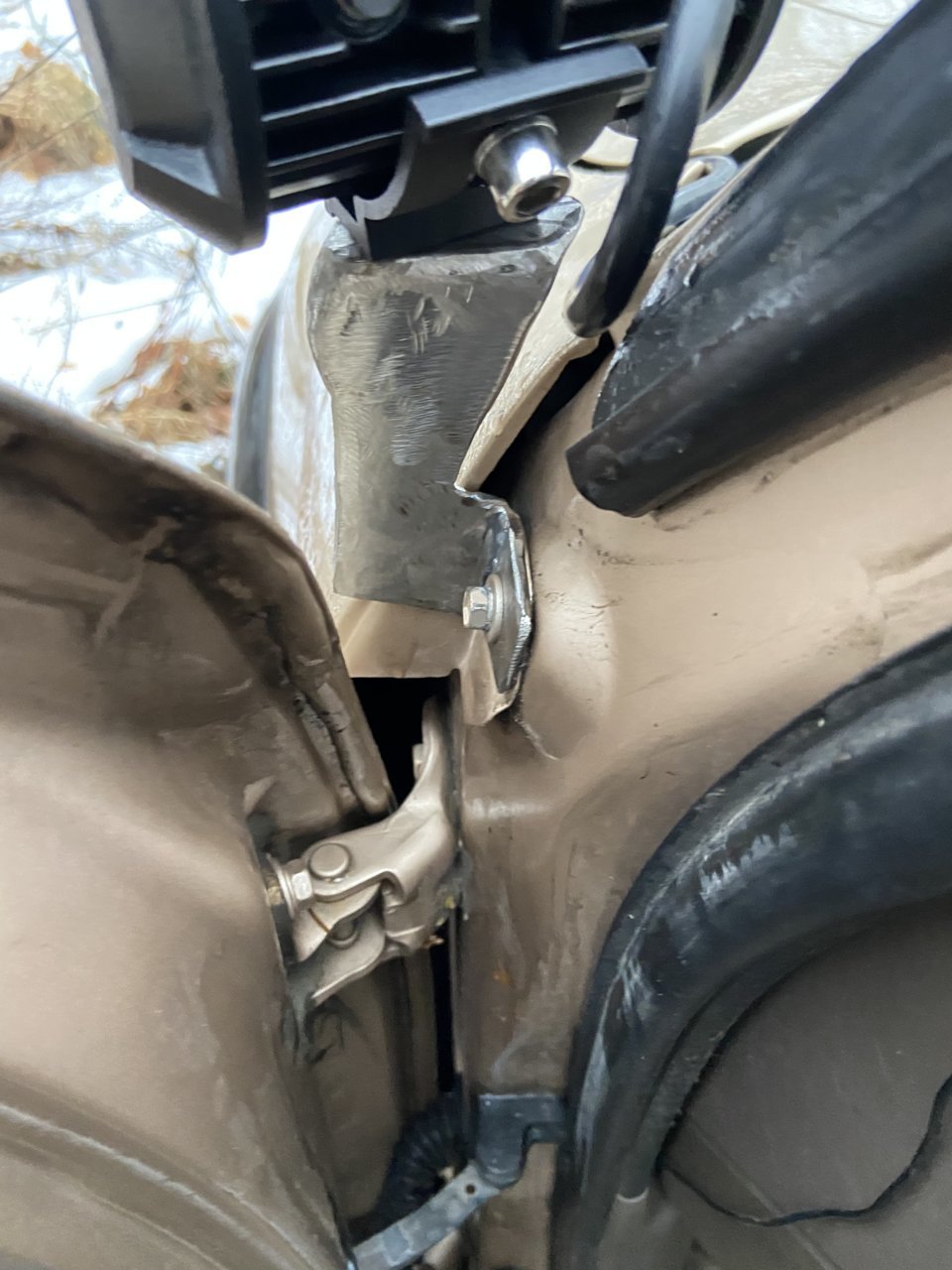

    I made some ditch light brackets that attach to a fender bolt. I don’t think the bolt is really up to the task but I wanted to give it a whirl anyway because it looked easier than messing with the hood hinge bolts :anonymous:
    time will tell!
    I need to grind them down to fit between the body panels a bit better then clean and paint them.

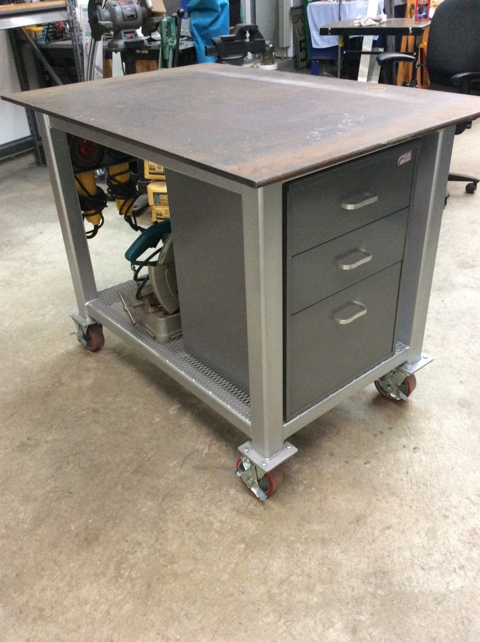

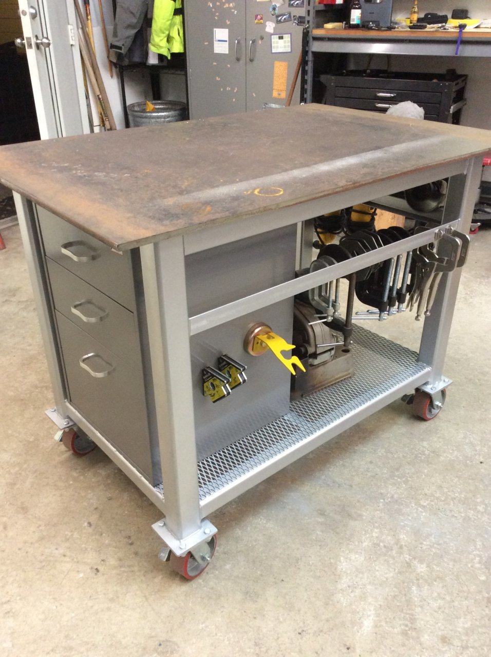

    Some pics of my almost finished welding table. Still need to fasten the top to the base, not sure how I’m going to do this. The top is not flat so I may weld in a cross bar under the middle and bolt down the middle to snug down the top. 7EA8EF92-1E2B-422D-8D8D-9062990559DE.jpg9DD2C8B2-B373-469C-9254-DE3CF165E475.jpg

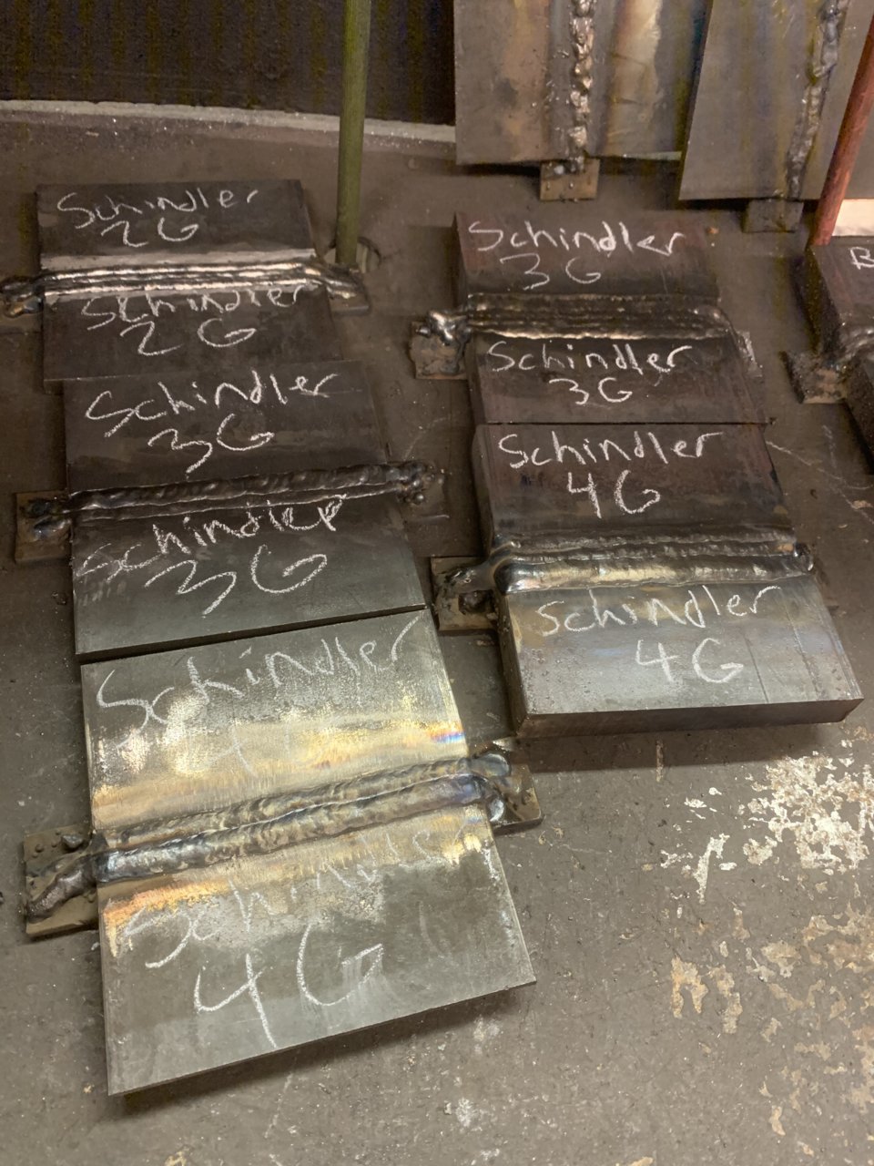

    :pray: all got sent out for X-ray. Will know the results in 3-4 days. 2- 1” carbon FCAW and 3-3/8” plate FCAW but with a weird wire I’ve never heard of before. Apparently it’s used on ships a bunch. Did all 5 test in about 5 hours when we had 2 days to do em lol

    wish you success

    OP's quest for a welding position in the shipyard - ie, X-ray weld tests. My mistake, should be addressed t @weldertaco

    I'd just tack weld the corners, then straight edge all around the perimeter and find the low spots.
    Once low spots were found just jack up those areas then weld in some angle clips. I don't know what you are going for when it comes to perfectly flat, but I would be more than happy with under a 1/16" .

    I’m not used to X-ray structural stuff lol.

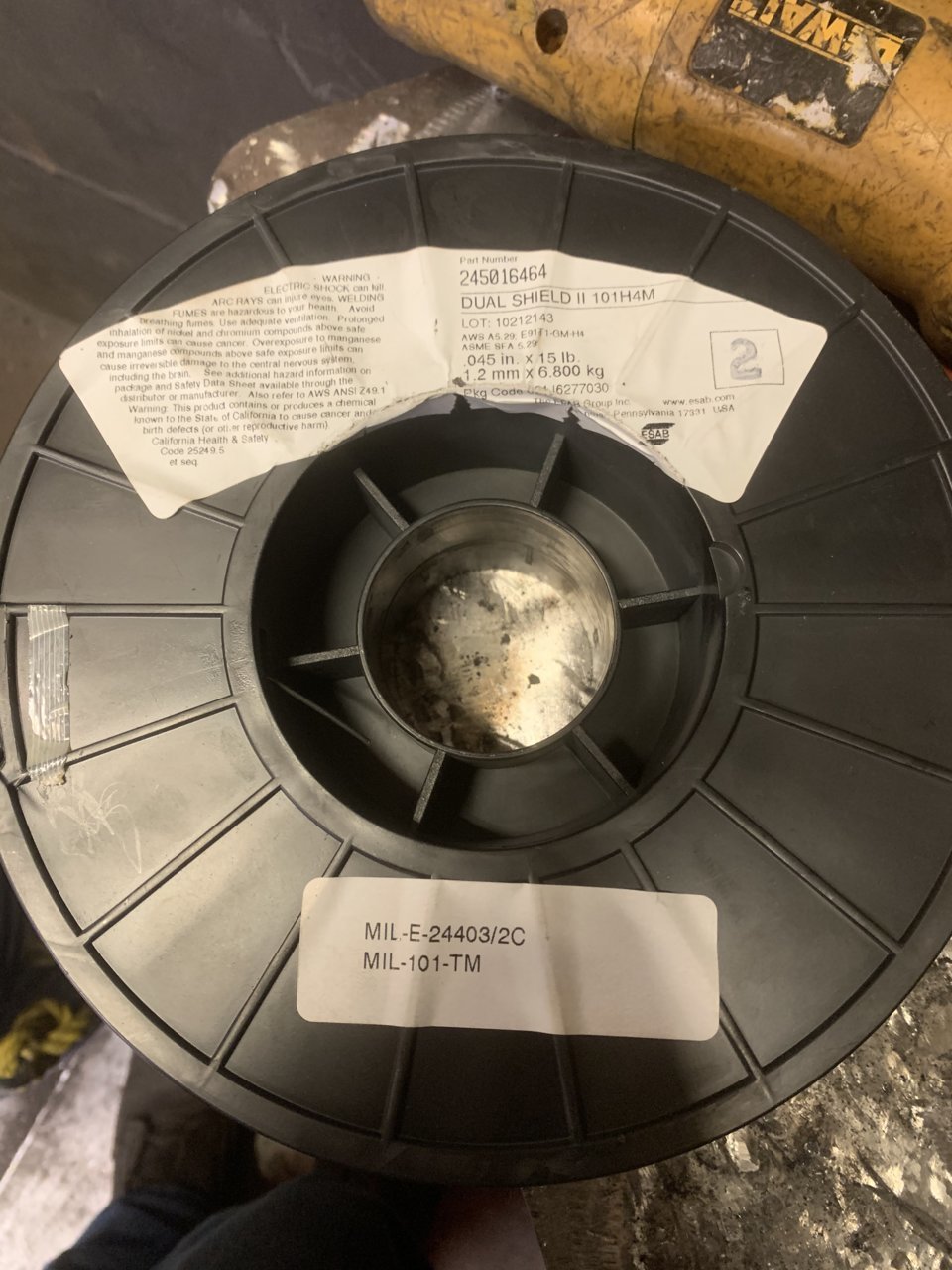

    This was a curveball I wasn’t expecting today lol have never seen this wire before. Hopefully it wasn’t decieving as it welded really easy.

    Could very well be a custom wire made for the Boat Builders.
    I see that quite often over the years Look for the numbers online in the Wire manufactures catalog nothing there.
    I have been Told the Esab wire mill in Hanover Pa will make wire to what Ever specs you want
