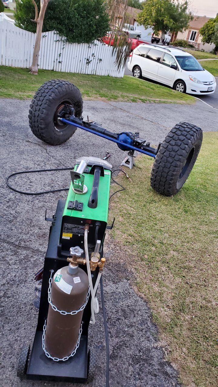

    Let my neighbor use the welder to weld on his front axel out of his SAS first gen.

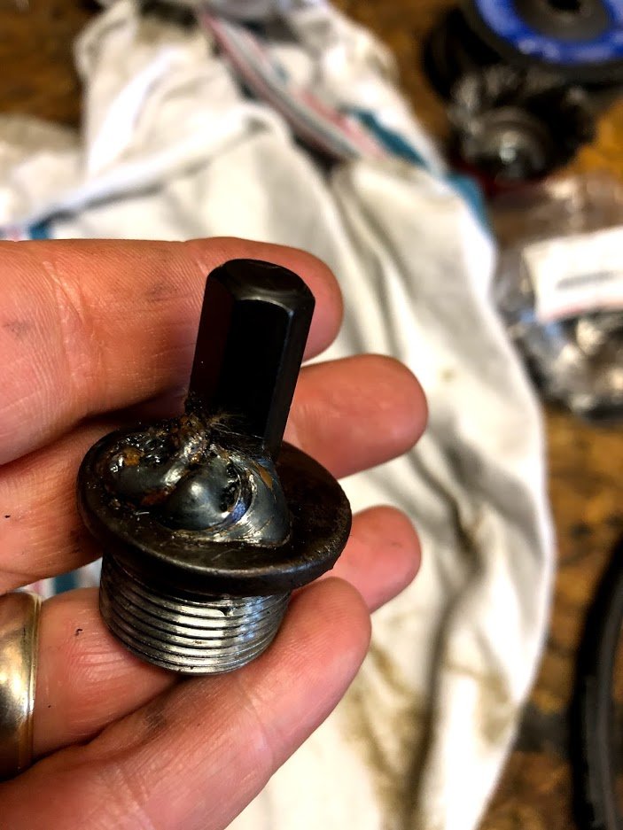

    I need a cart. I had to do this a few weekends ago, and ended up putting the welder on one of those wooden mover thingy's pushing it along the floor while I had the gun and ground clamp wrapped around my neck, holding the bottle B/C I was too lazy to disconnect everything and switch over to flux core.
    u-OQKBSQu4wi6oUk2hrxl1cY0kksZO3Gnwf-o6Uh_a54d4cee8ab7f4811a76db301a5ad10972c53743.jpg
    Don't look too close at the weld on the back side. Someone forgot to tun on the gas...:anonymous:
    That's the Drain plug out of my front diff. She stripped out completely, so I bought a cheapie 10mm allen, cut it down to have maximum engagement in the plug and my socket ( with just enough room for weld )
    less then 10s of welding, and she came right out easy peasy!
    Many Many thanks to the pro's in this thread who share their wisdom and knowledge for FREE! I Disconnected the battery before welding, and felt confident that by doing so my Truck's computer would be just fine. Without this thread, I would have been 2nd guessing my self the entire time.
    :bowdown: I also have a new found appreciation for those who weld on vehicles, what a PITA it was to clean that bolt and the spot for the ground clamp, moving the welder, getting in position, etc....:bowdown:
