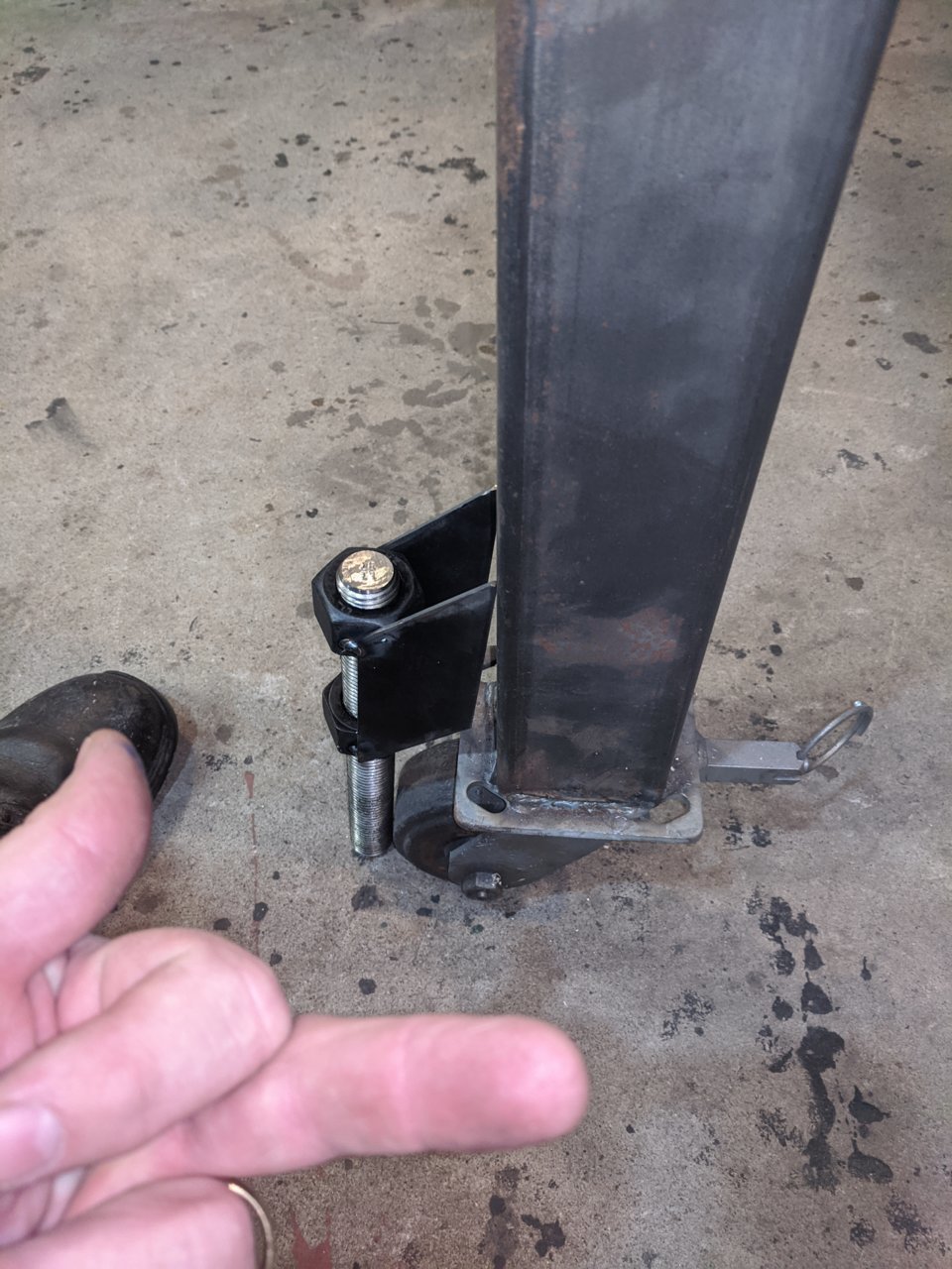

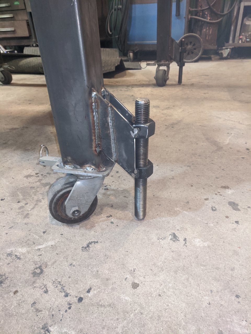

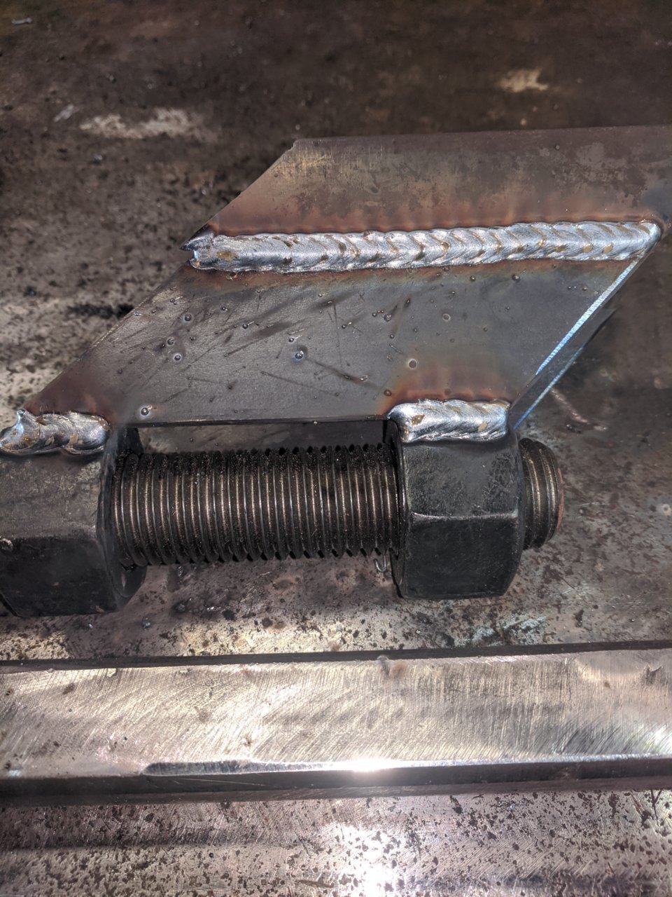

    Made some feet for the plasma table.
    What can I say? Little progress is still progress. Amirite?IMG_20200114_181252.jpg IMG_20200114_183718.jpg IMG_20200114_191210.jpg

    I'll weld a 3/4" nut to the top of the stud. I don't feel like swinging an 1 1/8" end wrench to dial down those bolts.
    I have 4 more if those big nuts to use as jamb nuts.

    Hard to tell from the pictures what weight casters are those ?
    Better to go to big then to small .

    I honestly don't know what their rating is, but we routinely move 3K loads with ease. They are big and heavy and they have a cool pivot lock feature to switch them from swivel to fixed direction.
