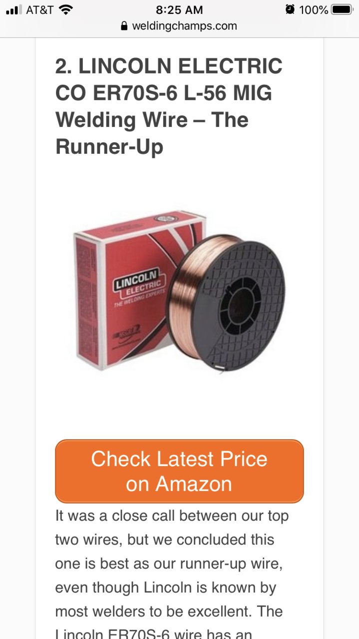

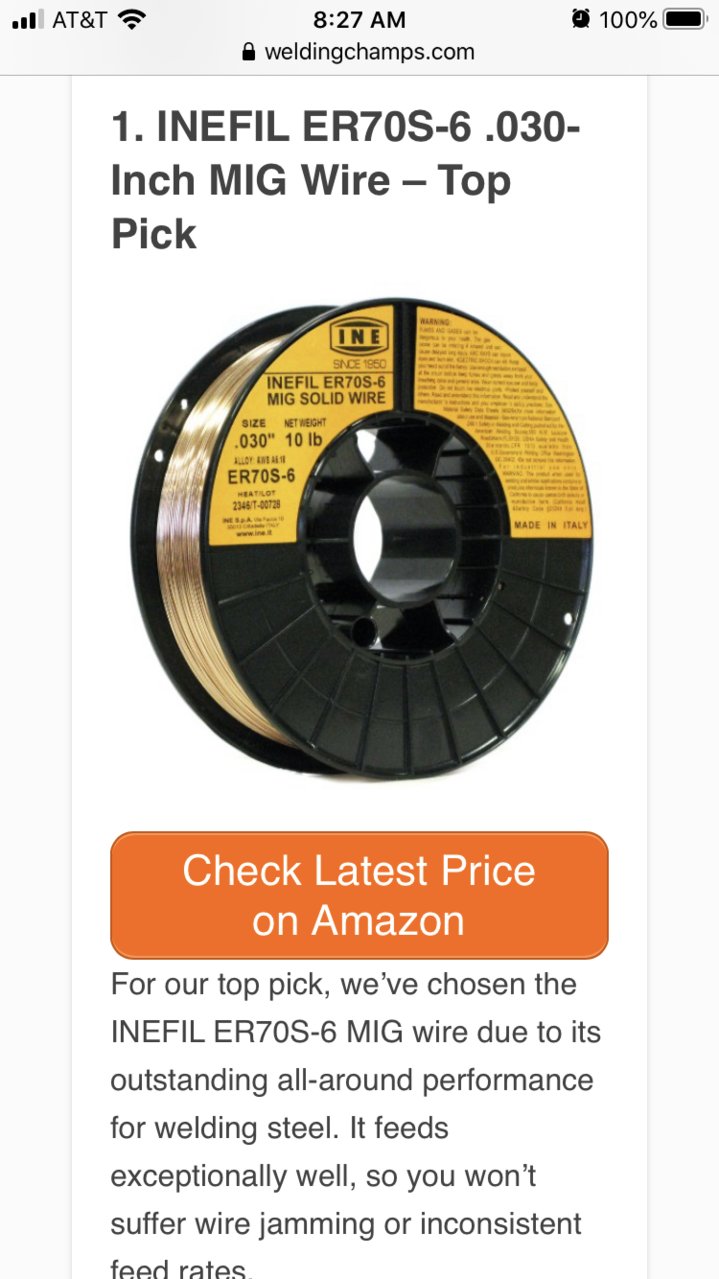

    What’s everyone prefer for their mig wire?
    I’ve always ran the Hobart .030 but I’ve heard that Inefil and Lincoln also both have excellent wire
    7E793E77-FD26-4127-BAA2-72889C07F94C.jpg 0437C047-52CC-49DE-9447-22F1E63B1789.jpg

    I only buy 44 lbs. spools and I only buy whatever comes on a metal cage spool. The metal spools don't break if someone drops the box.
    I only buy from my local welding supply because I can look over the roll of wire before I buy.
    I honestly can't tell a difference between brands. 70S is the same to me no matter what box it came in.
    I have no idea what is in my 2 machines.
    six5crèéd and snowboard704 like this.

    If I need wire I get the House brand of where ever I happen to be I only buy .023 wire.
    I get more then enough other size wire coming back off rental machines people no longer want the wire and just leave it in the machine.
    six5crèéd likes this.

    I run house brand (whatever the welding place has) .035 and have never had any issues. 44 lb spools.
    Truth be told it’s probably all made at the same place and has different labels on it.
    koditten likes this.

    I just finished a 10lb spool of INEFIL in .030 and I’ll be buying it again. I like the way it burns

    Ive used the INEFIL and its worked great. Its what i keep using now. But Ive used the hobart, lincoln, and a few other brands and all have worked just fine.
    snowboard704, D2. and six5crèéd like this.

    I have INEFIL from Amazon, .030
    I like it enough to buy it again when the time comes. Being a weekend warrior, the welding shop is too far away from work for lunch hour trips, and never open on the weekends. so I bought from Amazon.
    no complaints.

    Cool I’ll give the inefil wire a shot. $5 cheaper per spool compared to the Hobart brand brand wire also
