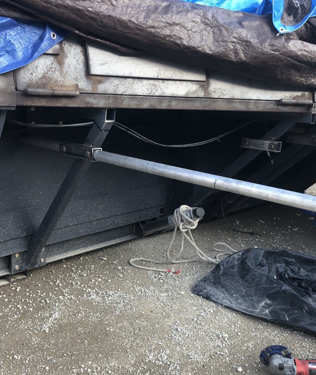

    Welded a bunch of square receivers on a space ship that we are shooting next week so that we can rig off of the frame for cameras and camera platforms.

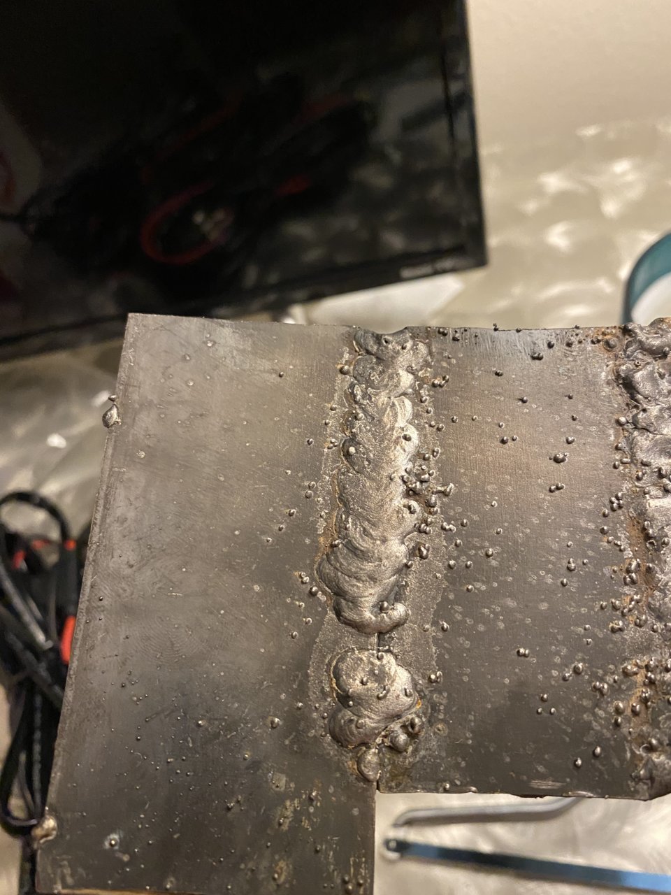

    You should practice one sided Tee joints and break them to check your penetration
    Butt joints are the hardest for a novice to learn on you tend to weld cold to keep from burning through .
    The thing with school you have enough machine to use 1/4" using thinner material gets so frustrating when your first learning to make the puddle dance how you want . Don`t have the time under the hood to read the puddle so you burn through before catching it and weld colder till you have a mostly cold lap which to many looks just fine.

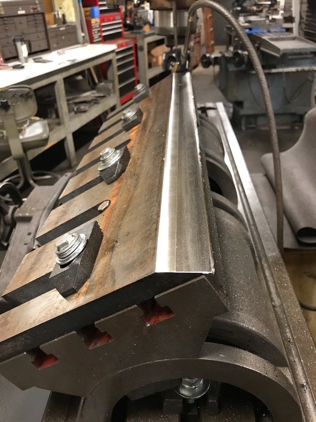

    Not welding related but I been sharpening these blades for a customer. I’m assuming they are some sort of tool steel the way they are eating carbide inserts but look at the rainbow colored chips.

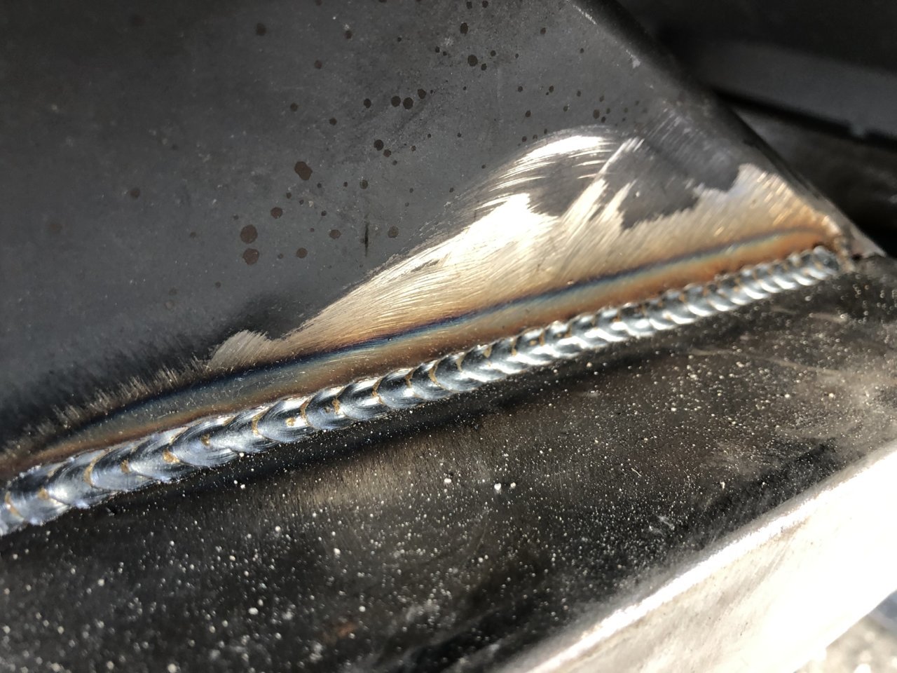

    Boss asked me to weld a couple pieces of aluminum together and I hadn’t used my spool gun in awhile and was a little nervous cuz I wanted it to come out nicely for him. I came home from work tonight and busted out the spool gun and practice on some 1/8” really quick and this was my first pass. I was pretty happy with the results
    So then I had to weld some 1/4” hinges to some 1/4” C channel and then the other side of the hinge to some 3/8” flat bar
    Pretty happy with it after not using the spool gun in months

    i want to see some pics before you wire brush. Only for comparison. Your aluminum spool gun welds look exacty like mine. I like them alot.
