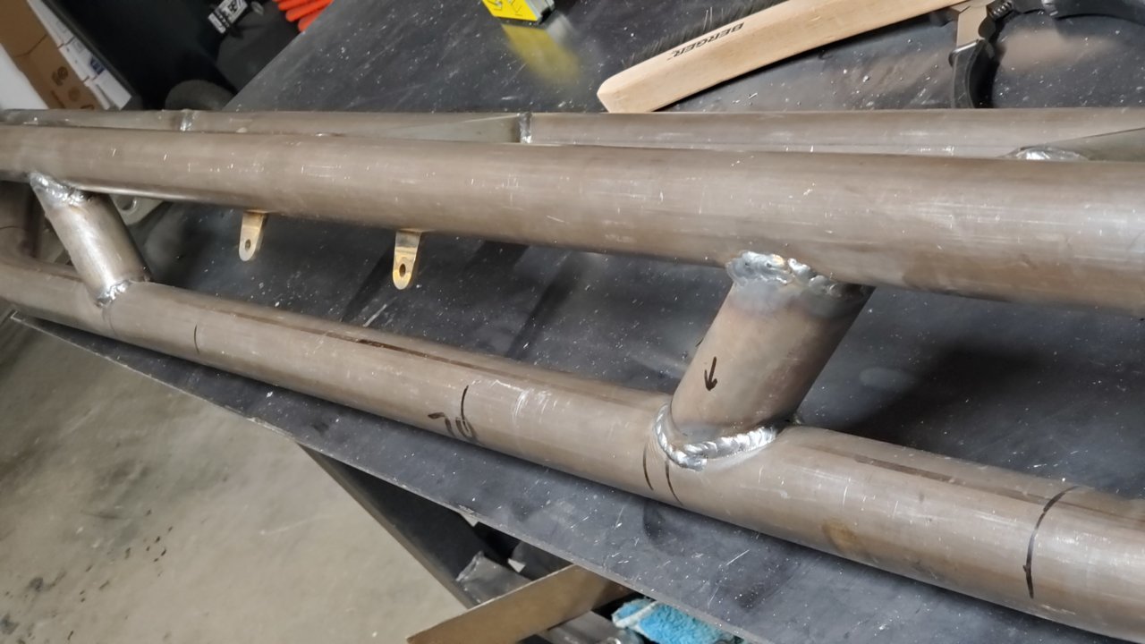

    ashamed it has to be painted...very nice.

    Not my best wrap yet still one of my first.

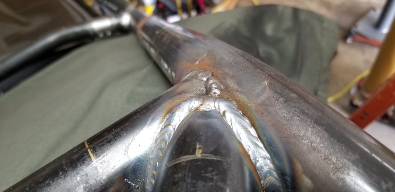

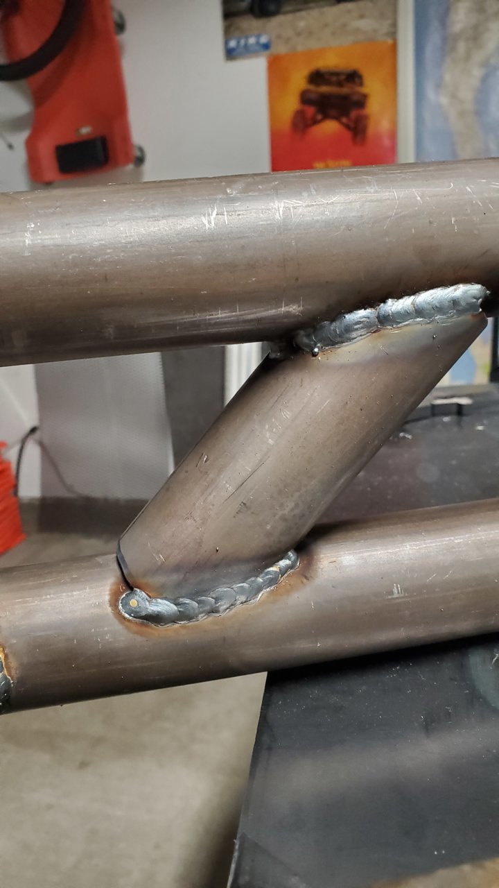

    Those are my arch enemy. I specifically practice those 45's over and over when I have time.

    We call those "production" welds. They make the money, are perfectly strong and very, very few costumers will notice after they go to the paint booth.

    I had a very hard time with those for a while. They were tricky for me. And that's good to know because seems like my whole cage is made with "production welds". :D

    Do you crank it up when doing those inside (tight) sections? Cause that's what I've been doing. I've seen some people smashing the nozzle too.

    I very seldom change my settings. I change my style 1st.
    Something like that, I'm not afraid to do the "extended spot weld" style of welding.
    Carrying a bead saves a lot of time, but with mig welding, you don't gain a huge amount of quality by going that route.
    Think about the TIG welders. Their style is not a lot different that controlled spot welding. TIG welding just looks great, but it takes too long for me.

    I actually leave my settings alone and just slow down in that section (really slow) and kinda widen the puddle/bead a little.

    I definitely ain't no pro but for these I slowed down so the puddle widened like the beginning.

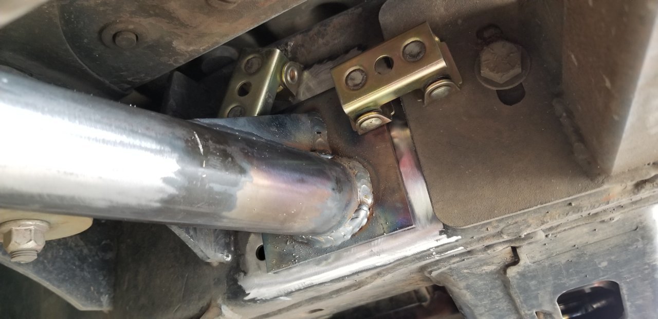

    One more slider leg going to the cage.
