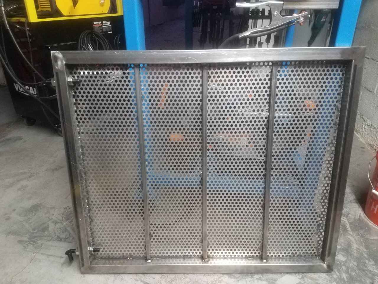

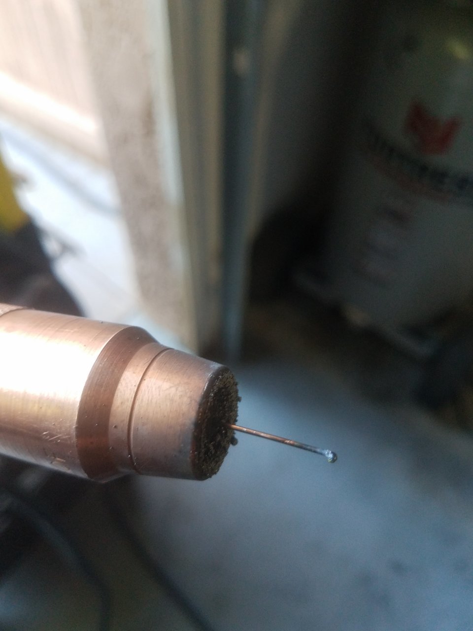

    So I was putting together a small gate for a pony wall to keep my dogs out of the yard when I dont want them there. I pulled up a chair to make myself comfortable while welding some long seams of perforated steel against the main frame of the gate. I had some devil driver blasting in the background so I was in the zone! My wife came home early from work and came into the shop to say hi. Well..... it startled me and I managed to jam burning hot welding wire into my leg lol.

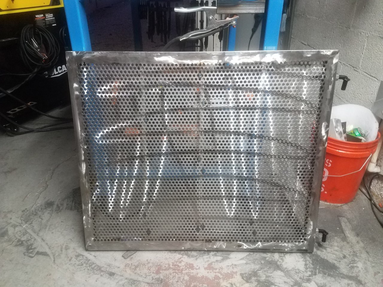

    At least the gate turned out nicely! Little more grinding to do tomorrow.

    That's "metal" on so many levels.
    :headbang:

    I did that once while welding inside a tank, I slipped and the wire went in my leg. Didn’t bleed a drop cause the wire burnt it.

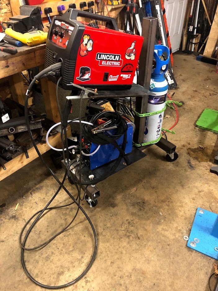

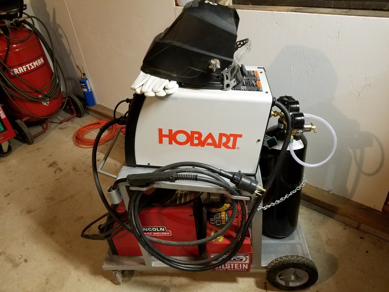

    As promised, here are some pics of the scrap bin welder / Plasma Cart.
    Welder Cart:
    • Made with 2.5" Square Tube ( Was supposed to be 2" square for some sliders, but the supplier messed up when they gave it to me, and I messed up by not checking it for months..)
    • Those are some heavy duty casters that come off those wire shelves you put together. the ones that can take a few hundrerd lbs per shelf.
    • the plate is 1/8" plate, feels sturdy enough.
    • Yes I'll round off the corners.......later...:D
    • I need to figure out something better to keep the bottle on the back, I also made it a bit taller to accommodate a bigger bottle later on. Are all bottles a standard size, meaning I could just google what the next size up would be?
    • I still need to figure out some type of handle, and gun holder. I don't like putting my gun on the bench, it seems to find a way to fall on the floor..
    I7yL59VnIXL2m4N3AFK-6I5QHsqtxAcVgV2x0H2y_a19d1cc335cca5b6d86ab60238e70aa8ac8c558c.jpg rYmv1BVo8EJBkbeNhm_j6qxOvMupv41JyKf21tme_d1a706bf7f5dd613386febf6f73e0486c1c912d8.jpg

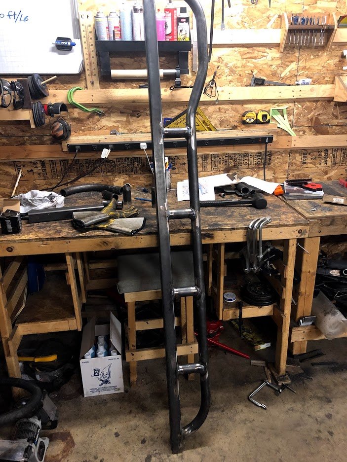

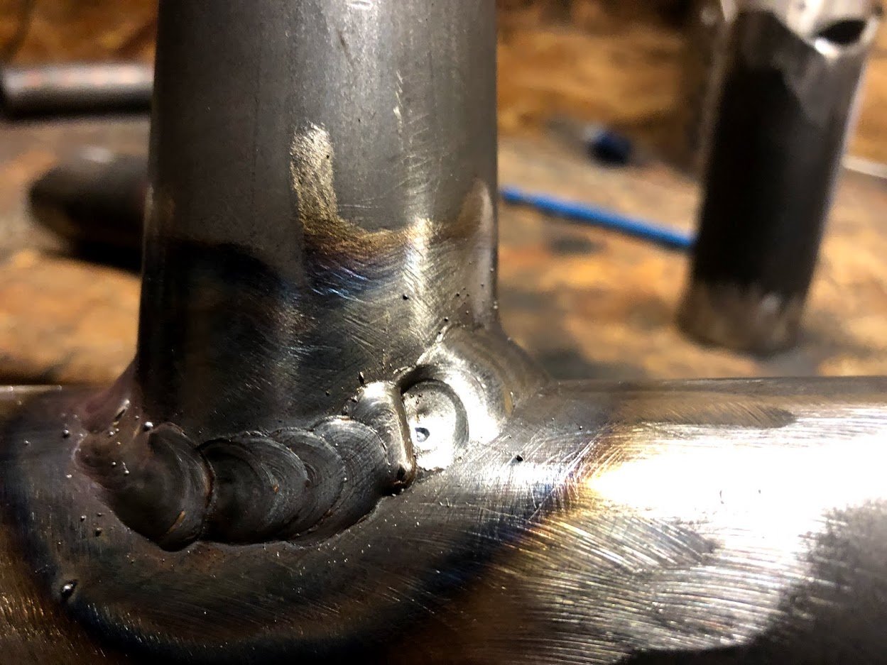

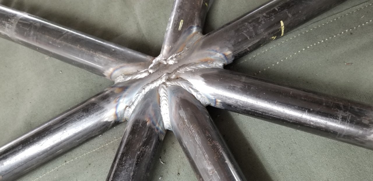

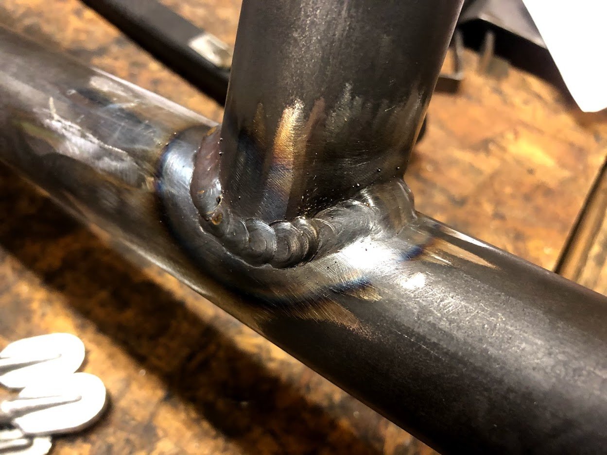

    Next up some welds,
    what do you think? i've never really asked anyone's opinion on my welds, mostly because I only welded "non life threatening" things like carts, or doinkers. But now things are getting serious! I'm getting ever closer to finishing up my first set of sliders and wanted some feed back.
    This one is one of my better welds, and kind of what I've been able to pull off for most of the round tube welds ( man that stuff is a bugger! I thought I was decent until I had to get all out of position to get all the nooks and crannies! lol
    JIshIK8VRO4P7iHylIHouU-b5QL8-x3oSr52OE2N_8eb43bbc41255b8eee54168d3094a4f04d6cbf8f.jpg
    This next one went a bit funny, That indent is where I stopped welding before repositioning. While Welding, it looked / felt like I was on the brink of welding through the upright tube ( admittedly, there was a bit of a gap I was welding up. I wanted to give it another "zap" once cooled, but then was second guessing myself wondering if it was necessary, Thoughs? what would you have done?
    A1mOVte3YuExx31H2BZ8UVZkESTlNjYUmDRG-ifQ_84d513ab0d5eec775e86a4aca936ea573aa4712e.jpg

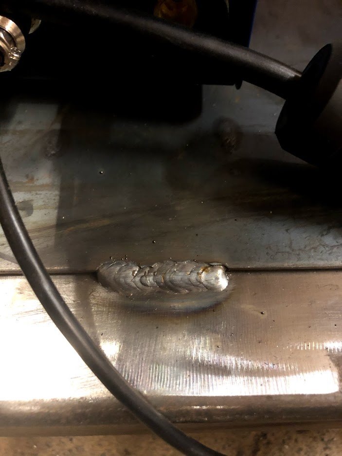

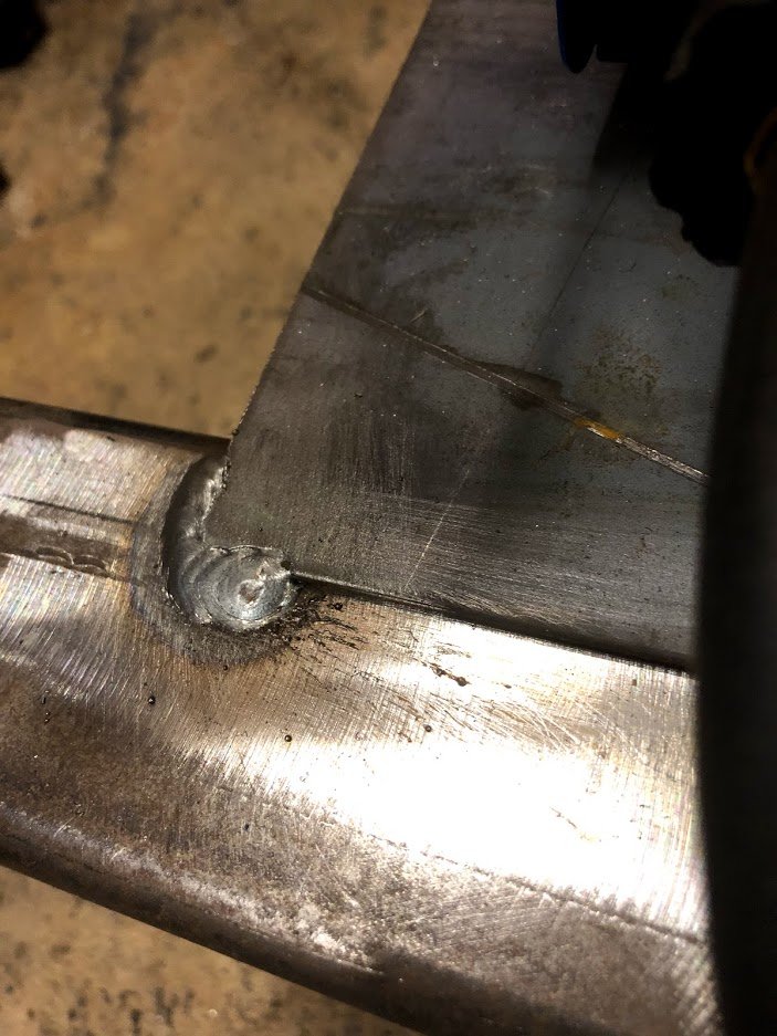

    Here is a few welds on the welding cart. just checking to see if any of you keen eyed guys see anything blatantly wrong with them. They all felt good for what its worth.
    8TbC7YYDd1BNuM4gZqTLLiux8ueB2MvtTDeIOzrV_2136437f9f48cf1451fd90bc09a0d7729dd11547.jpg zhJIBB7f70pFh3W305SjOZVhDj8RLI5gktXIJQOQ_e707bd33f13f5d2e91cabec19cfb56b1af80416d.jpg
    Well, maybe that last one isn't soo good.... looks like I was day dreaming in the middle, lol!
