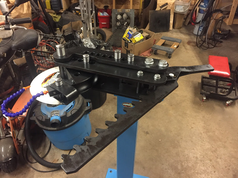

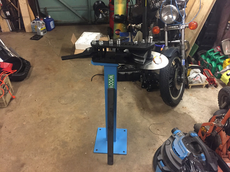

    it most certainly is!
    Bolted to the floor. Bought from Summit Racing.
    Bends 1 3/4" .120 wall DOM real nice. Just requires a cheater and some muscle :muscleflexing::curls:

    I like it. I will say this,
    the die may be 120 degrees, but at most ( and with a lot of effort, like a lot ) the most bend I acheived was approx 110, on DOM tube.
    but 90 degrees? all day every day, no problem.

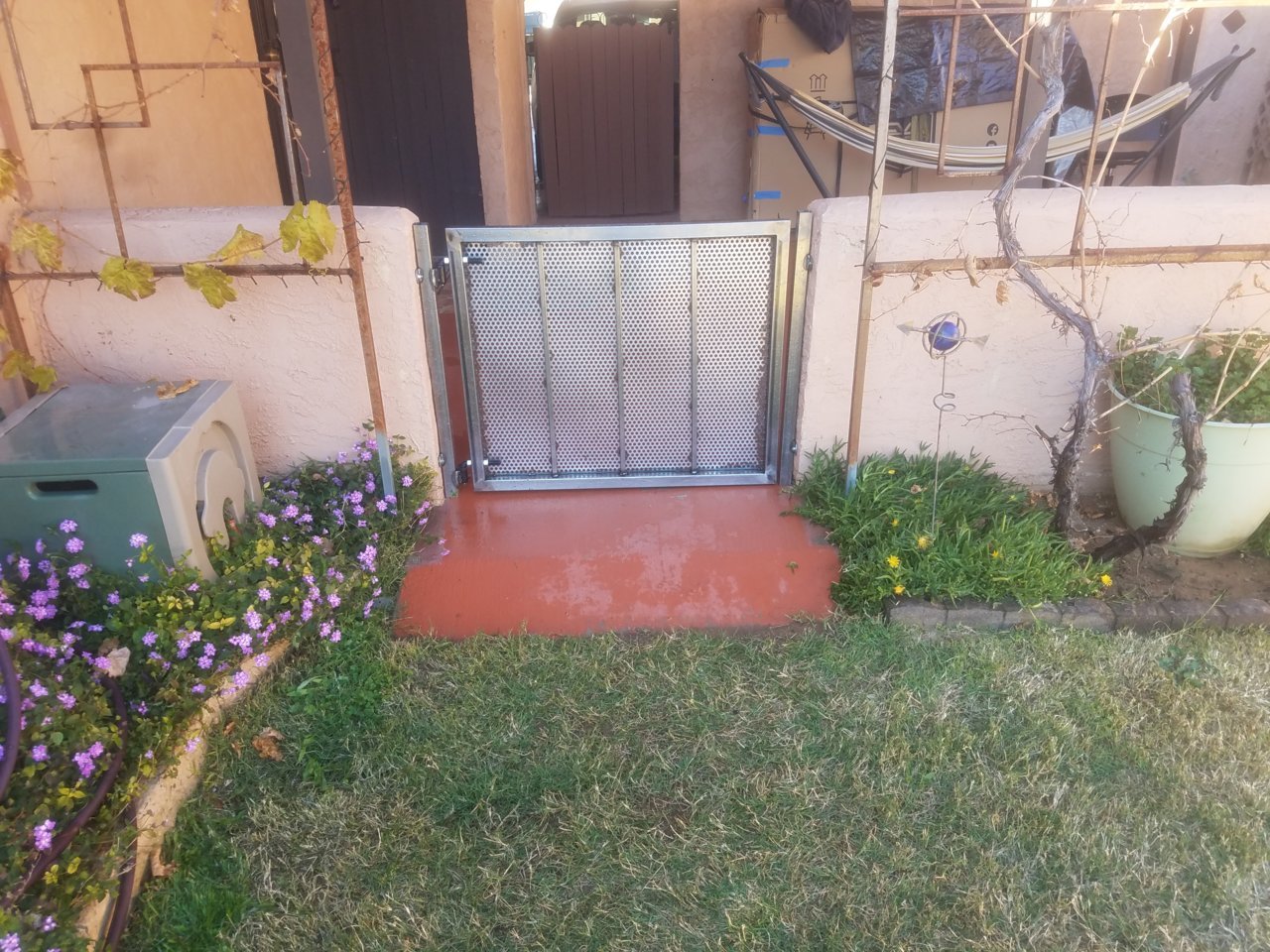

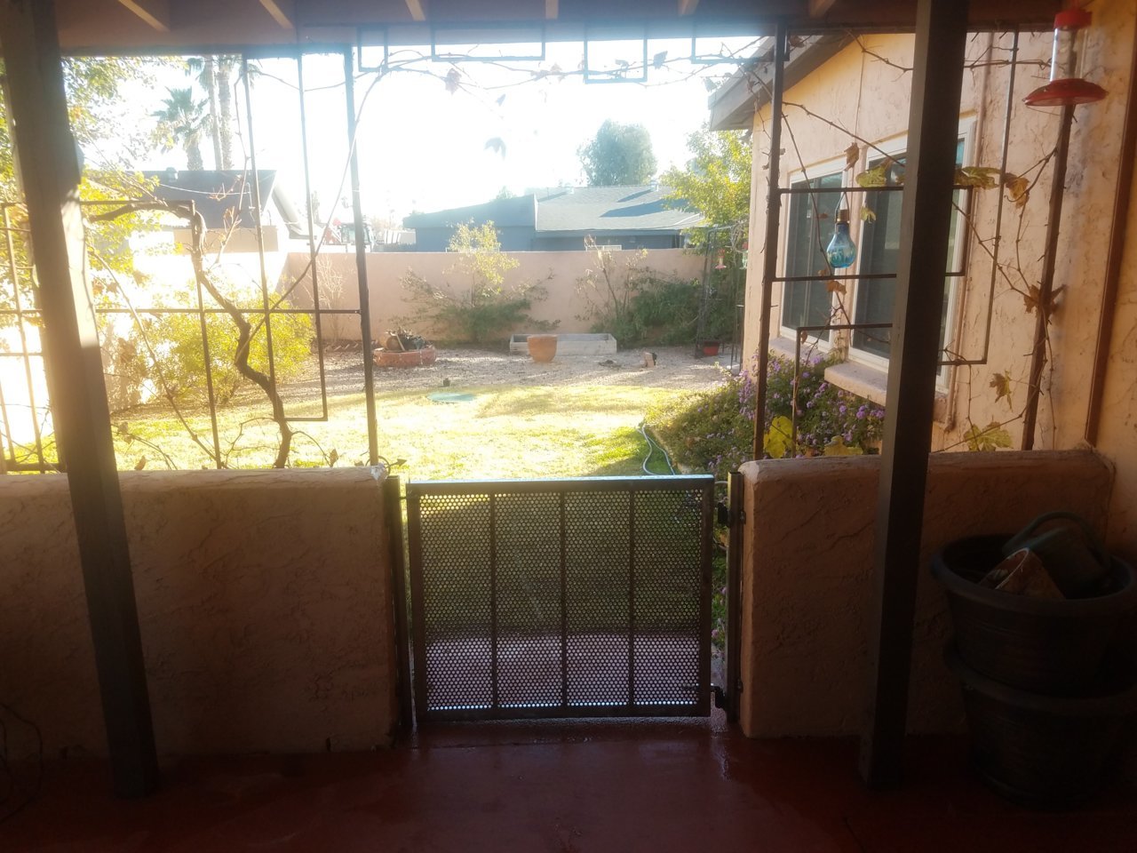

    I finished that gate, just needs some weathering patina now. Also, my leg is doing fine and I didn't manage to further injure myself so that's a plus:anonymous:

    There's a hot rod trick to get an even patina without being a crusty, rotten mess: wipe it down with some diesel fuel and give it a good soak, then come back wipe over the whole thing with boiled linseed oil. The linseed oil should dry similar to a clear coat, but it will still allow the steel to patina without getting super rusty. Of course there's the chemical patinas and stuff if you want to get DIY-channel fancy.

    I'll look into that one. I was going to try the hydrogen peroxide, vinegar and salt spray with a clear coat. In Phoenix it literally takes years to get that rusty look naturally. I put that grape trellis thats next to the gate up last last year and parts of it still look like unfinished steel lol.
