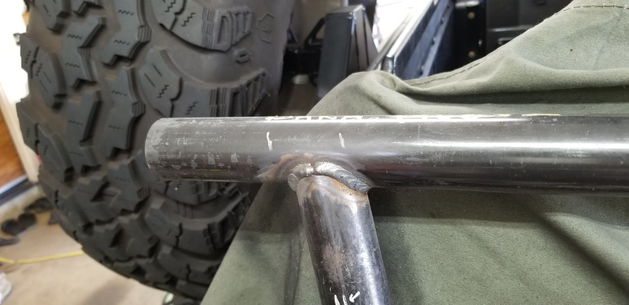

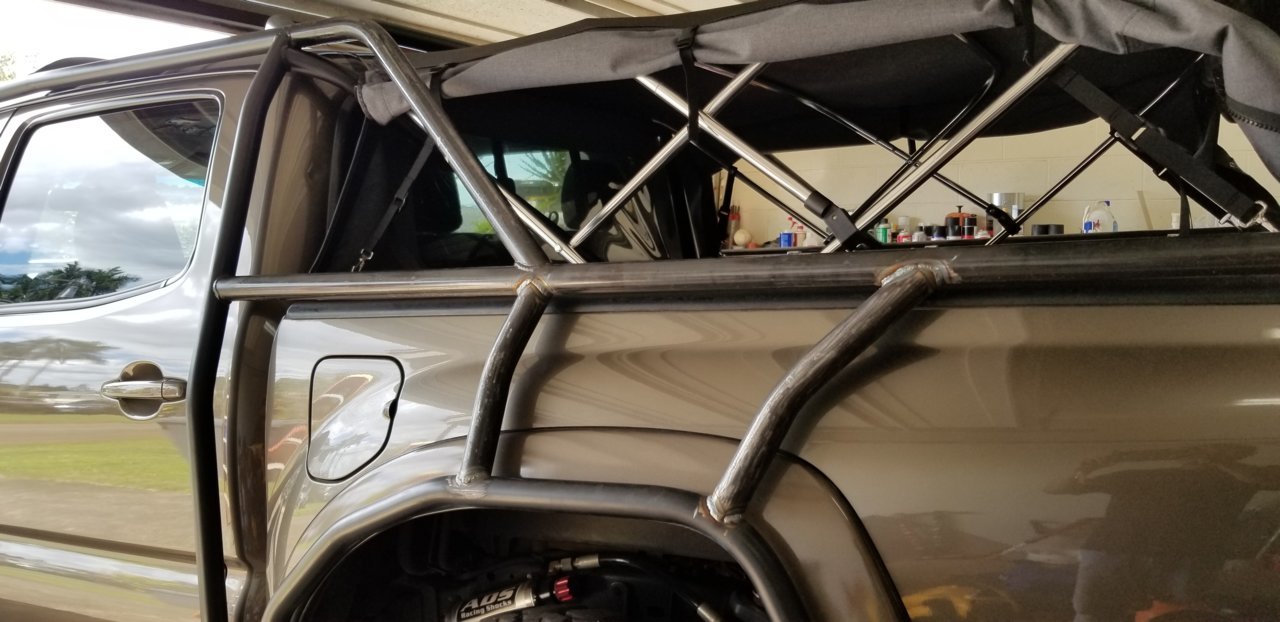

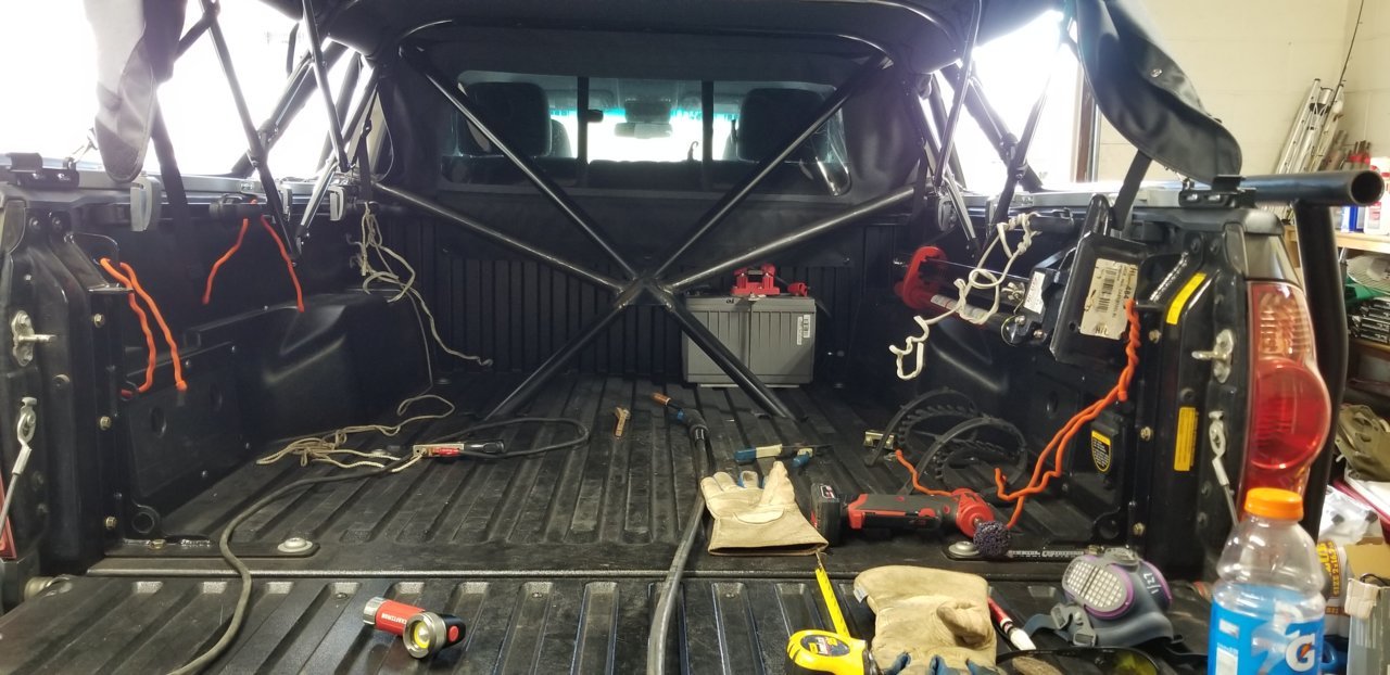

    Cool design, dont know if this is meant to protect you in a roll over or just keep rocks and trees off the body, but I would continue that angled tube behind the cable down to the bar running over the wheels. If you flopped it onto the roof, that bed bar will bend and possibly cause evreything eldr to bend a crush the cab a bit, kindnof defeating the purpose. If they are just glorified run rails then party on!

    Yes, more braces are already in the bed portion and it still has the two angled braces from the top of the cab through the bed that you cant see.

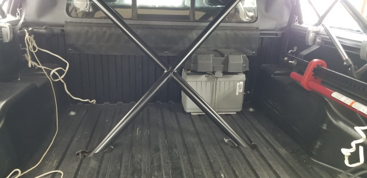

    Here's what it looks like now. Still have a bunch to go. Thanks for the heads up.

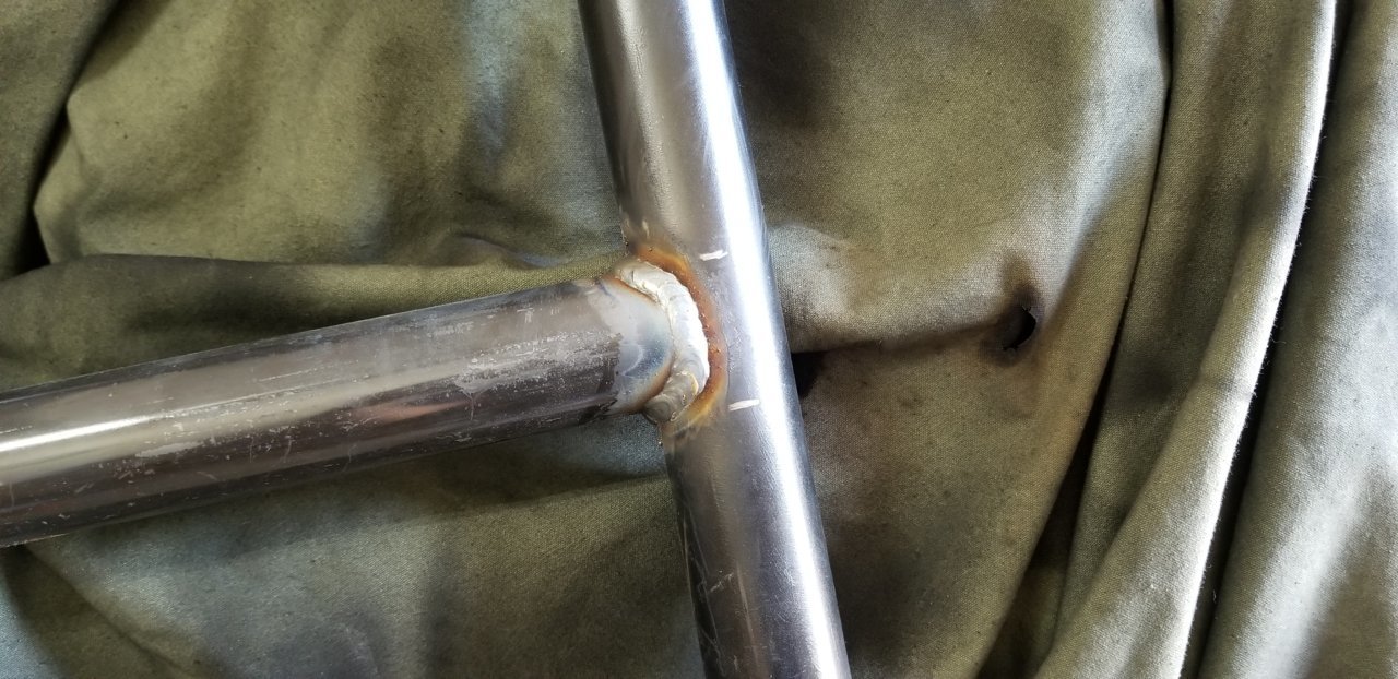

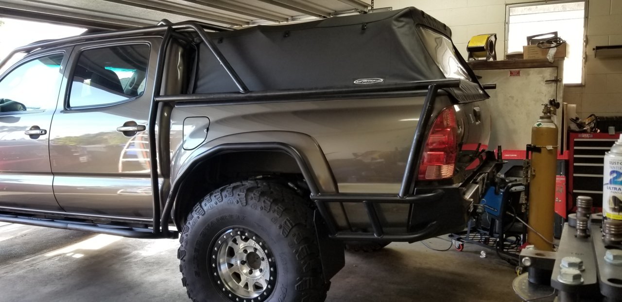

    Added a few more braces for the main hoop. Hopefully the truck never flops, but if it does, I feel pretty confident that the main hoop will hold up.

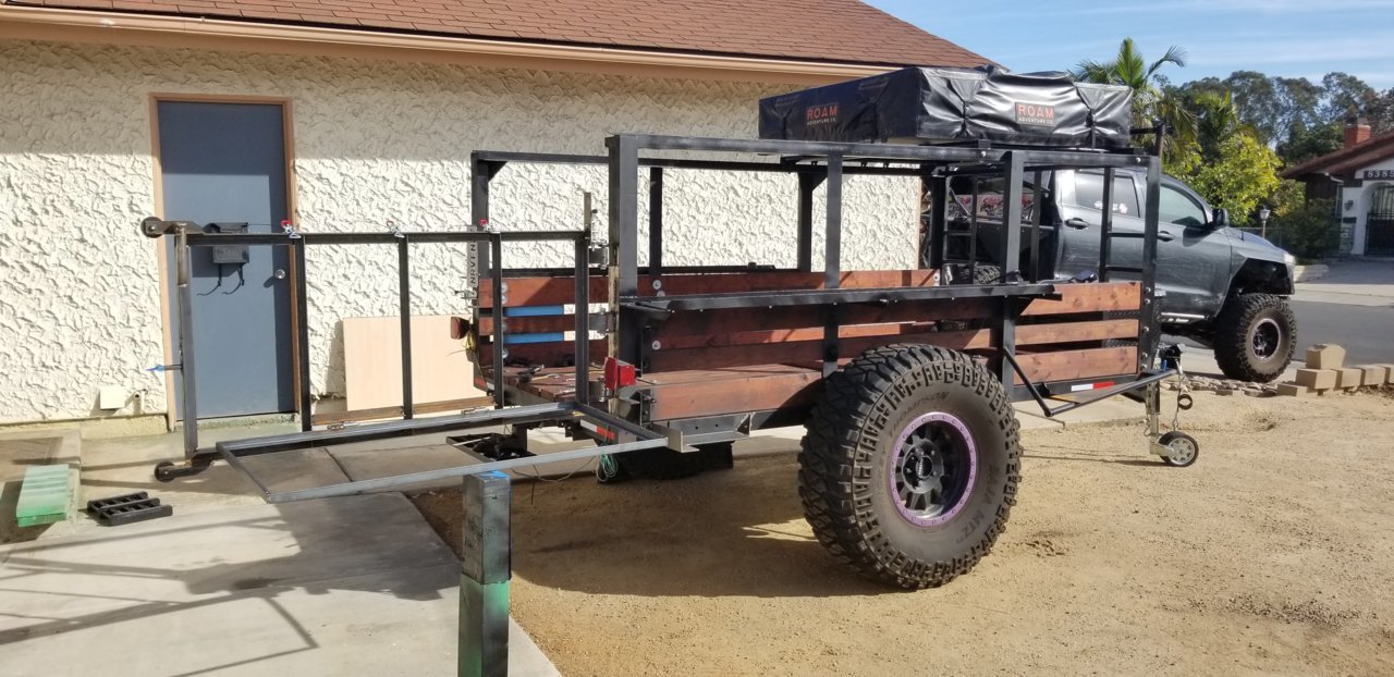

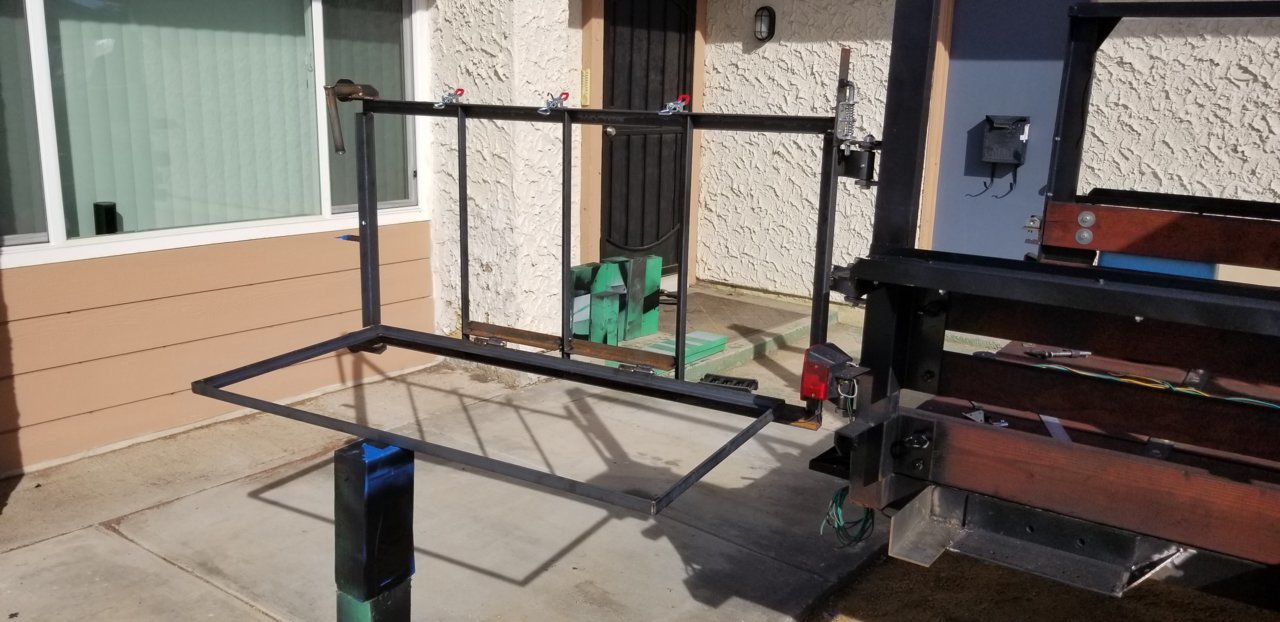

    This "home base hauler trailer camp setup overland luxury" setup is turning pretty alright.. tacked together the drop down 2x4' table today that is attached to the swing out door..

    I think that should hold up just fine for sure. Awesome progress. I usually hate exo's but this is still damn clean.

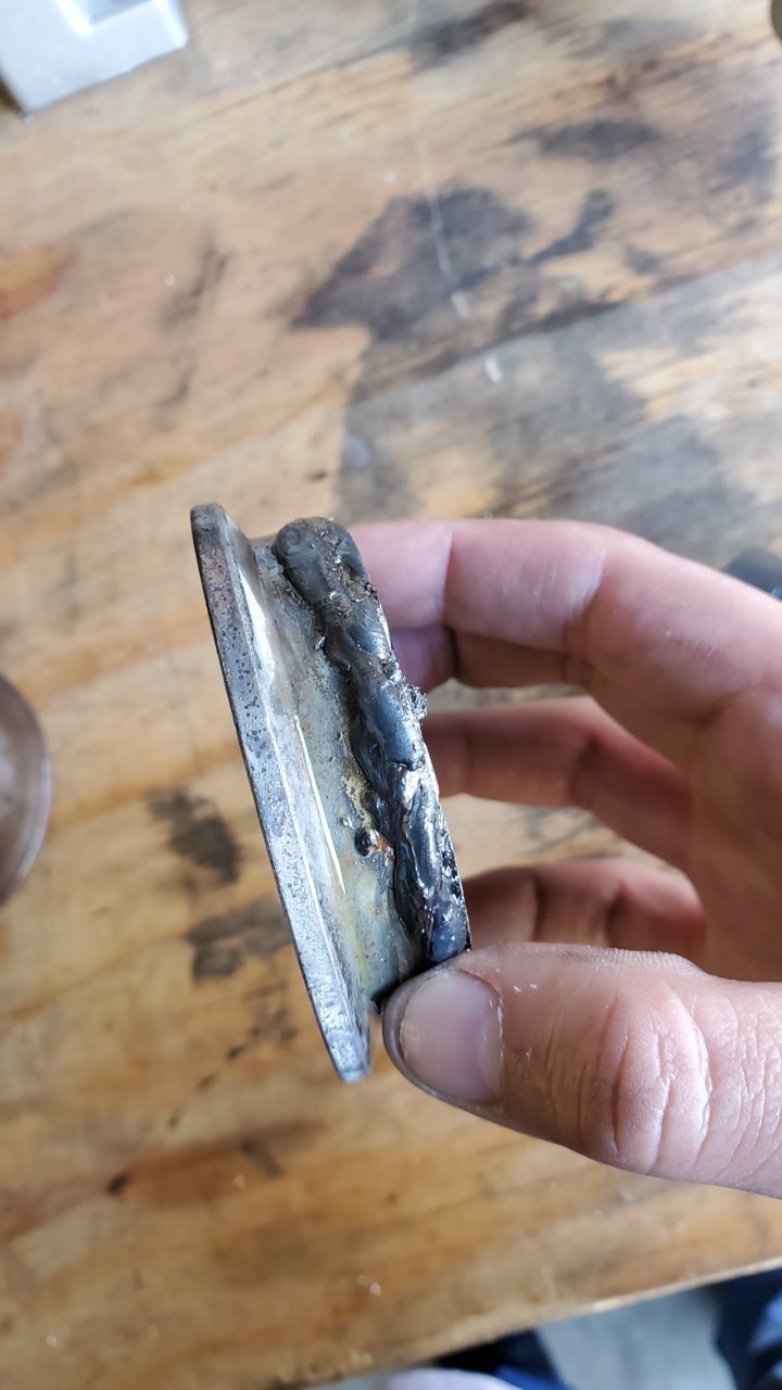

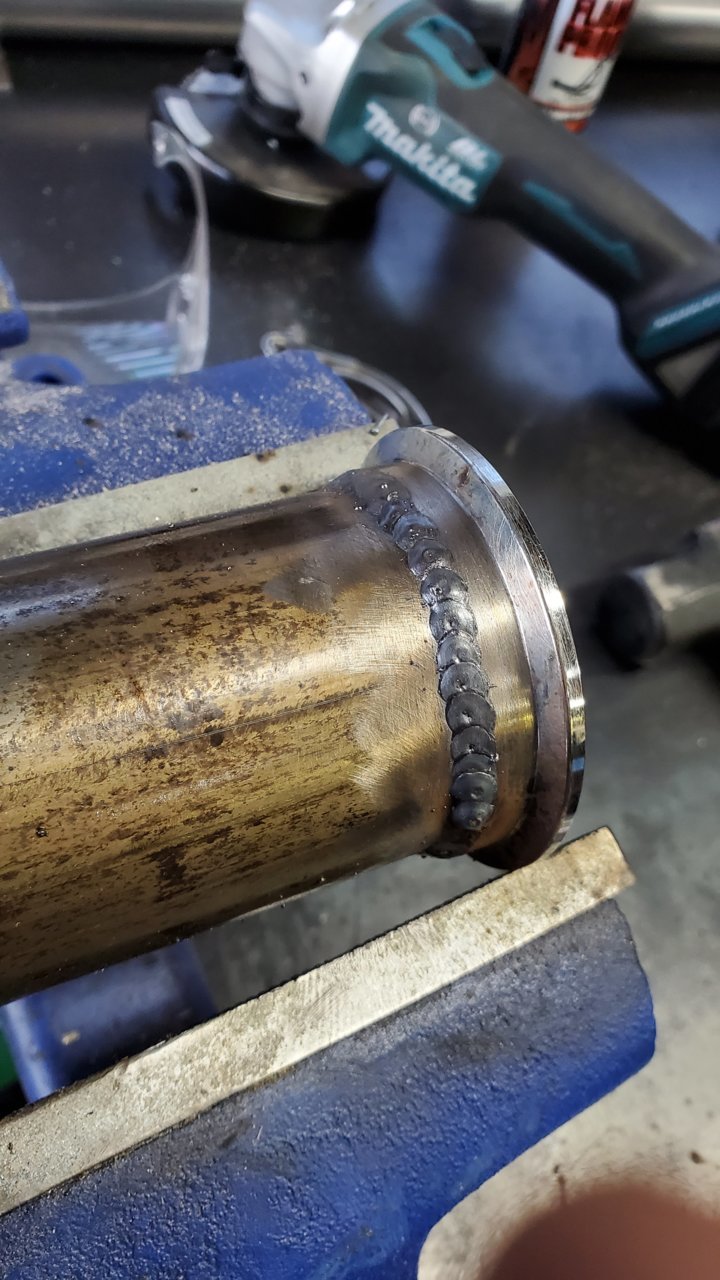

    Welded a new vband flange onto a header I traded to my friend.
    The old one was pretty bad lol yes I did the old one too back when I first started welding lol

    Looks great! It's amazing what a little time and experience will do.

    Thanks man! And definitely! I dont get to practice as often as I'd like to but I've definitely progressed.

    doing the on/off with mig is well... eh.. isnt that stainless? you really should be tig welding it..

    If I had a tig I would lol. Did I use the best methods/processes? No but it will hold and it will be coated so not worried about rust. Also its mild steel.

    it will hold yes - for how long is the question.. doing that on/off shit with a mig causes the previous "mig spot" to become more brittle on an already weak weld.. im not being a dick and you can defend it all ya want.. just being informative and helpful to pressure you to learn to run a weld :)

    I'll post up when it breaks lol

    It's not gonna break there.
