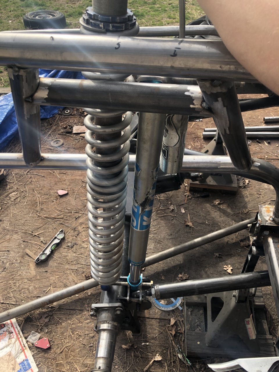

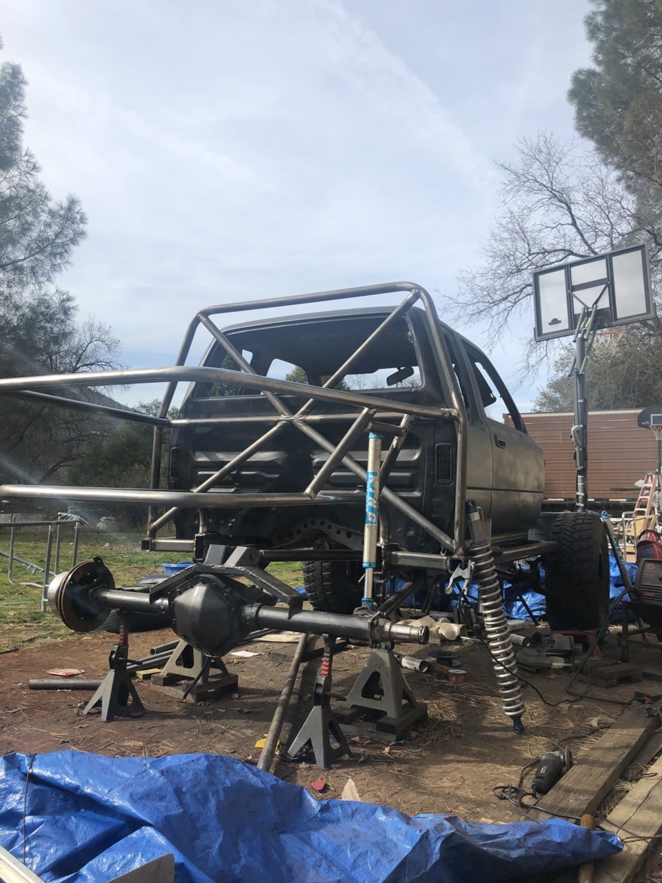

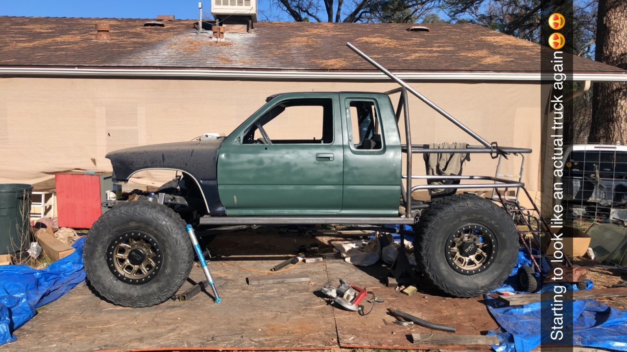

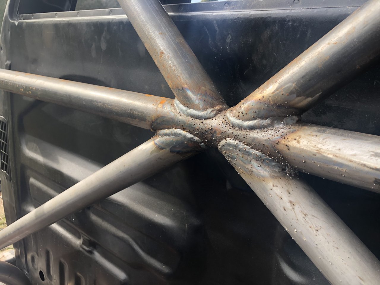

    Couple pics to update you on my ghetto built wanna be ultra 4 truck B3B772EB-1371-4676-86D1-CB5270FCA9B0.jpg06E5AAEE-5A32-4B39-BB01-EB6EC992D090.jpgeventually will be set up for a coil over and triple bypass whenever I hit the lottery. 22EB3E39-0161-4C10-86AE-851469F438E5.jpgSince it’s a welding thread here’s for decent welds for yaF4DEAC93-E144-41FD-BF76-F4A1B75D3D45.jpg

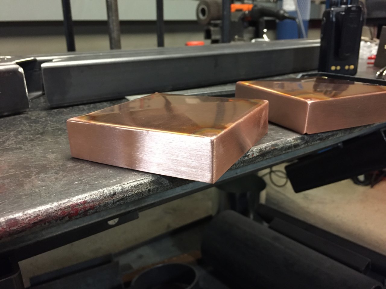

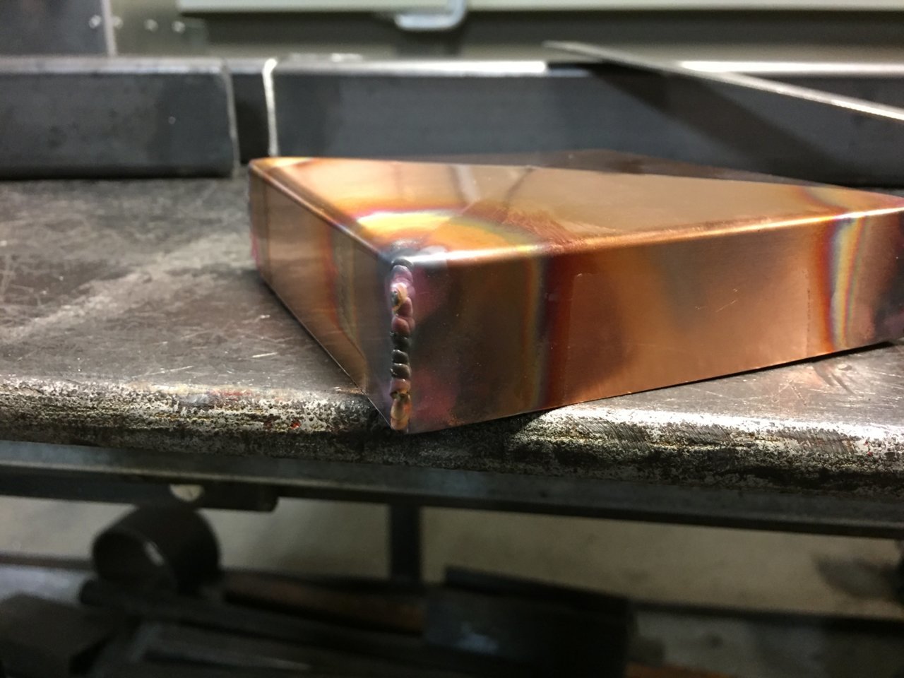

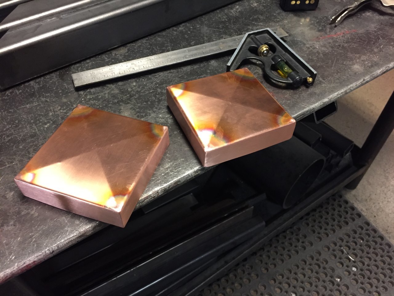

    Custom Fence post caps lol.
    First time welding copper. Its .020” thick and I could only cut the fill rod strips so thin so welds looks like shit (only took a pic of the best one of course) oh well, just had to shine her up a bit!

    No it’s gas. Just no anti spatter spray :facepalm:

    I'm having a hard time buying that.

    That’s it’s gas or sarcasm about the no anti spatter spray?

    Somethings not right, I get less spatter than that using flux core.

    That it's not flux core.

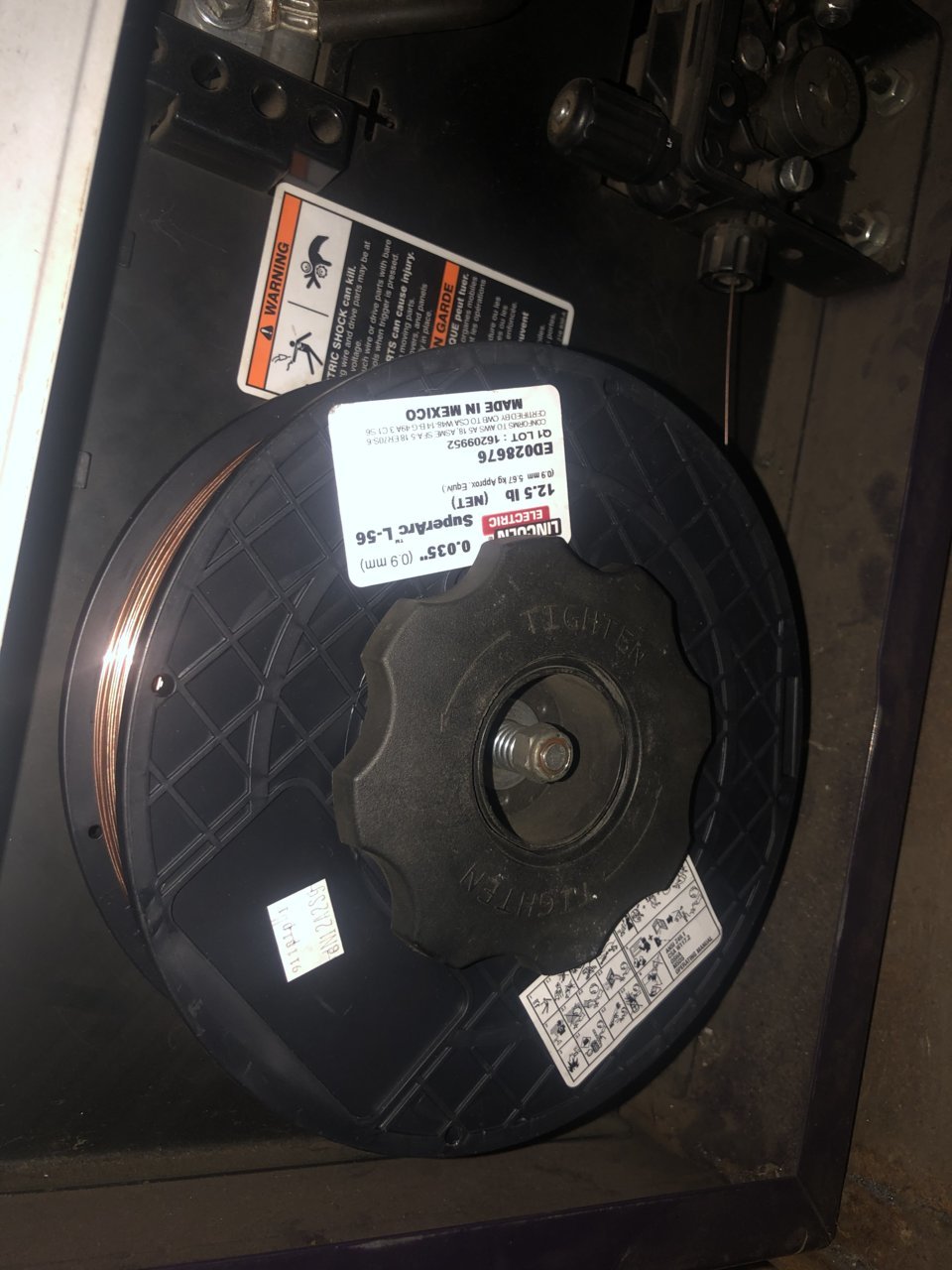

    Here’s the wire I’ve been using. And a bottle of 75/25 on a Hobart 180. I know there’s something wrong with the welder bc anytime I crack the bottle you can hear/feel the gas flowing. This was an abnormal amount of spatter but it was also a windy day welding outside

    Your polarity is backwards. Flip em and watch.
