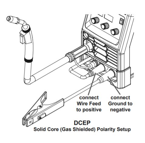

    Positive to the gun and negative to the clamp. That’s how it should be right?
  8. Feb 1, 2020 at 9:45 AM
    weldertaco
    weldertaco Mr.13%bodyfat
    Dec 16, 2014
    #144371
    13,299
    texas
    TrailRunner
    4wd to 2wd conversion
    Wrong. Flip em and try it.
    It’s a 70/30 split. Positive means 70% of the heat is flowing through your wire and 30% is going through the base metal. The wire can’t handle that. Flip it and try and see how less of spatter there is.

    https://www.millerwelds.com/resources/article-library/flux-cored-welding-the-basics-for-mild-steel
    Equipment preparation
    Check your cables. Before striking an arc, check your welding equipment to make sure all of the cable connections are tight and free of fraying or other damage.
    Select electrode polarity. Flux-cored welding requires DC electrode negative, or straight polarity. The polarity connections are usually found on the inside of the machine near the drive rolls.

    He's not using flux core, so therefore his polarity would be correct.
  11. Feb 1, 2020 at 10:05 AM
    weldertaco
    Dec 16, 2014
    #144371
    13,299
    texas
    TrailRunner
    I thought I read that he was using flux core? I’ve never seen a mig or flux core that spattered that much ever.

    Oh no it’s gas. I welded it awhile back if I recall correctly I think I forgot to turn the gas back on for a tack weld. Might be from that?
  13. Feb 1, 2020 at 10:22 AM
    EatSleepTacos
    Mar 24, 2015
    #151688
    59,838
    Randy
    West Valley, AZ
    2017 4Runner
    No gas would cause porosity in welds, not so much the spatter. It’s weird because the welds look good, just a whole lotta spatter. Maybe too much stick out as you’re welding or something, I dunno.
    slander and weldertaco like this.

    Stick out was gonna be my next thing. ORRRRRR the angle of the gun can cause a ton of spatter while making good welds still if it’s too much of an angle.

    If I have the gun too steep in the push/pull angle, it’ll spatter like crazy. That could be it.
