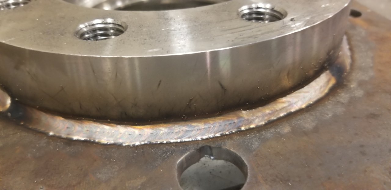

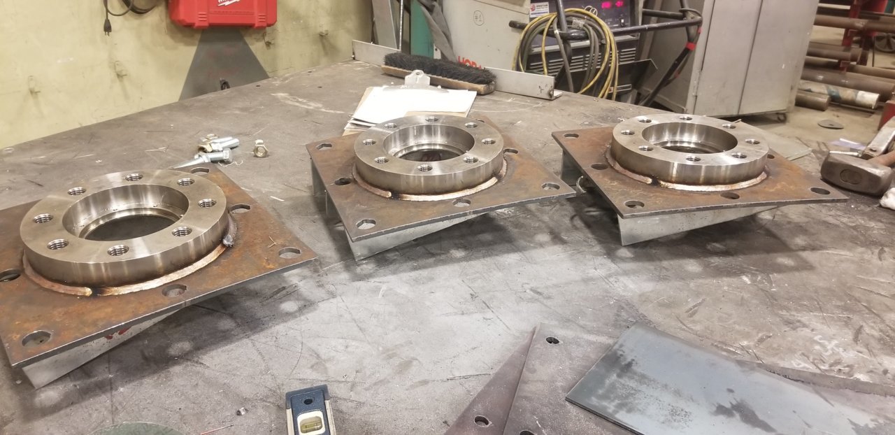

    This particular job actually holds a scoreboard up. The length is the critical part and there's also a piece that slides up and down inside it so the I.D. has to stay true, the pipe was bored, the new piece has threads in one end and turned down to slide into the pipe and I welded it. It should be good :thumbsup:

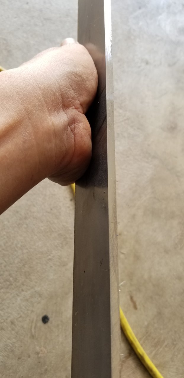

    Some work welding. 316 stainless to mild steel.

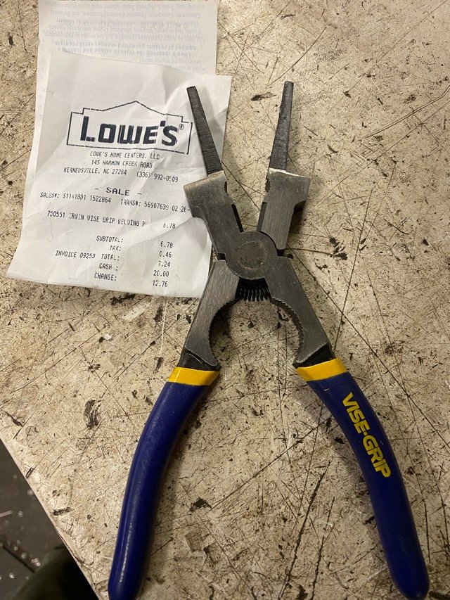

    Saw these welding pliers a few weeks ago and they were around $15, guess Lowe’s is closing them out cause I just got this pair for $6.78, $7.24 out the door.

    Does it say where those were made?

    It doesn't have it on the pliers and this is the only set they had and there was no package. I had to show it to them on the Lowe's app with the part#
