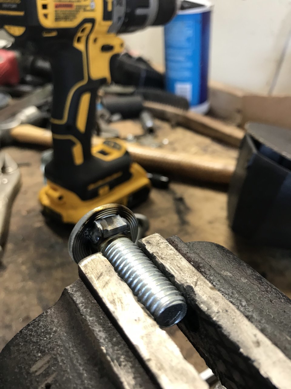

    No, they’re just some zinc coated carriage bolts. Cut the round part off and welded it to my mount. Regarding your stainless steel question, I’ve done it before on other stuff. Does that make it right? No idea but so far it’s held.

    Ah, okay. I might try it. At least the stud that the wingnuts attaches to will still be "stainless". I'll see what happens.

    Yes you can weld stainless to mild steel I do it all the time either use 309L wire or electrodes .
    My jobs were usually more involved then just a few bolts
    Some people say they do it with regular mild steel hard wire

    I'll just experiment and try it with normal hardwire. It is only a couple tacks to hold a hidden bolt head, so a knob or wingnut can be threaded on the other side without having to hold the bolt head. If it doesn't work, I'll go ahead and look for some 309 SS wire.

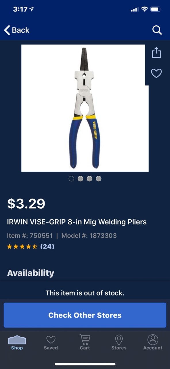

    Those pliers I bought yesterday have been marked down again.
    Drainbung and Bigdaddy4760 like this.
  20. Feb 29, 2020 at 12:27 PM
    koditten
    koditten Well-Known Member
    Sep 8, 2013
    #112077
    19,758
    Kirk
    Central Michigan
    04 trd x-cab 4 x 4 3.4l
    Reserected from the dead.
    I think I paid $15, 20 years ago.
