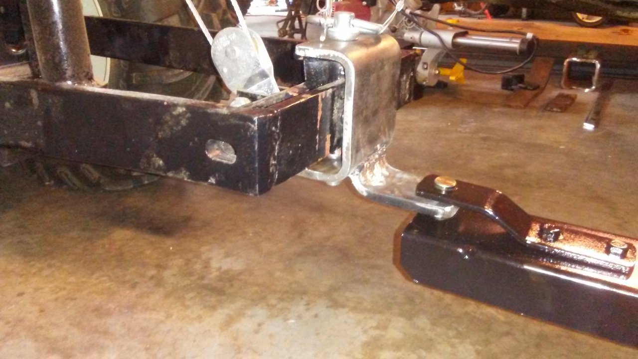

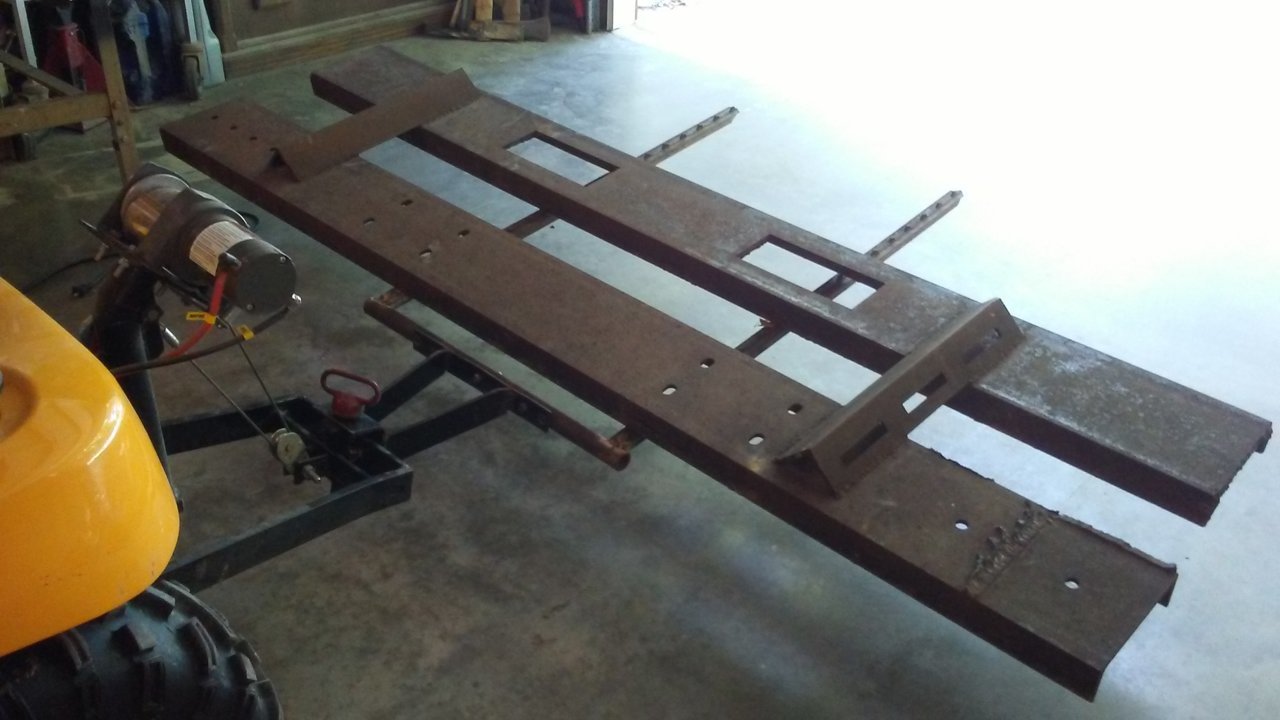

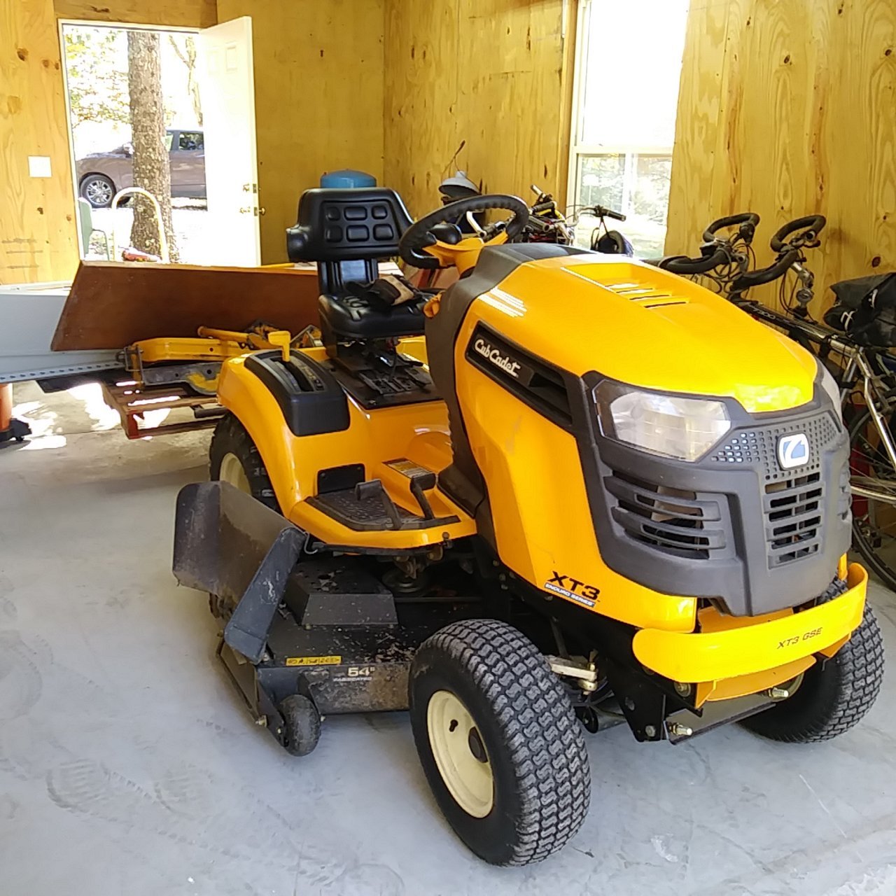

    OK, finally getting around to posting one of my other garden tractor welding projects. This was the first welding I had done in 7 years after changing careers. Was learning flux core in a new Miller 135 110V after MIG welding for 20yrs. Forgive some of the not so pretty welds.
    Garden tractors (GTs) are heavy duty mowers designed to plow and pull heavy stuff. The one here is 1000lbs and shaft drive so quite a bit heavier duty than a 500-600lb lawn tractor. GTs use a 1-pt sleeve hitch vs a 3-pt hitch on a tractor. The other GT with the loader I posted has hydraulics, this one does not have an auxiliary hydraulic circuit so implements have to be electric.
    Goal was to have ability to use the GT in 4 ways: 2" Receiver hitch mount, tongue mount, winch, and sleeve hitch, all easily broken down with clevis pins.
    Most of the iron is salvaged from a pickup bumper hitch.
    First thing I did was build a receiver hitch mount out of an ATV receiver hitch. Flipped it upside down, drilled and tapped a 5/8" hole in the bottom, cut the head off a bolt and screwed it in, then plug welded it in so it was flush inside the hitch. The flat bar mount is the license plate mount from the truck hitch I cut in the middle and welded back together to fit the width of the GT rear frame.

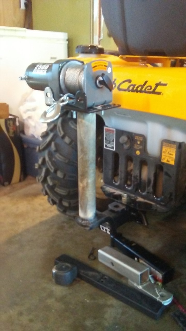

    Next was the winch mount. I flipped a 2" drop receiver hitch upside down, welded heavy wall galvanized fence post to it and welded a winch mount on top of it. Initially it was straight but I didn't like the angle of pull on the winch cable so I sliced the pipe, pulled it down at a 45deg angle, and welded in a wedge to angle it down. Gusseted stress areas.
    Next was the lift arms. They are the 5/8" thick crossbody of the hitch I salvaged the iron from. Perfectly bent for this project lol. Sleeve hitches use a single 5/8" pin for mounting the implements so I welded and gusseted in a piece of 5/8" ID pipe. The bolts keep the implement from moving side to side and jam into the hitch. Included sleeve hitch to pin mount adapter(I cut them out of 4" square tubing) so you can see what the implement hitch looks like.
    First the receiver hitch goes on with the bolt thru the GT hitch, (1) 1/2" bolt on either side of the GT frame, and (2) 1/2" clevis pins which the hitch will pivot on. The receiver hitch will fit any truck hitch and the tongue sticking out will allow any tow pin stuff to pull like a garden dump trailer.
    Next up, the winch just slides in the reciever hitch and can be used w/o the lift arms if so desired. Winch is a $50 HF ATV winch with remote control (keyring)
    Last, the lift arms which will lift any standard GT sleeve hitch implements.
    https://youtu.be/sOCywqEQxrg
    What do I do with it you might ask? I pull a box blade to grade my driveway, plow, use it as a forklift with a sleeve hitch fork set I built of of barb wire T-posts and scrap pipe, pull my cart etc. It will lift ~400lbs before the front of the tractor is bouncing--need some front weights lol.

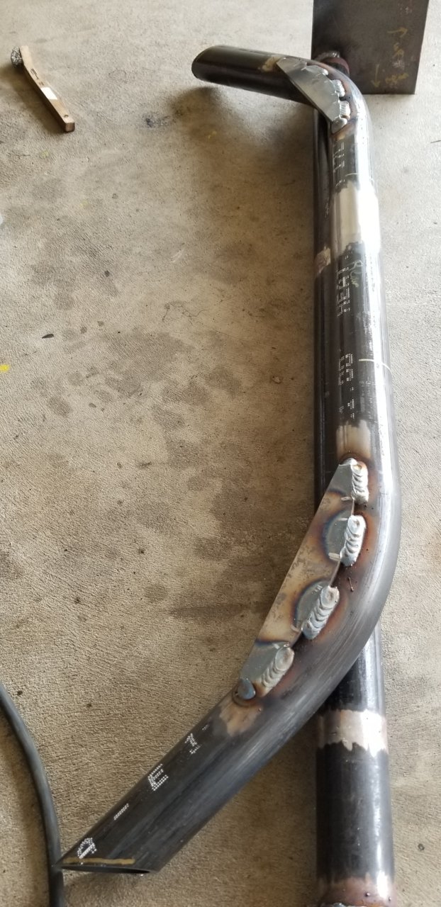

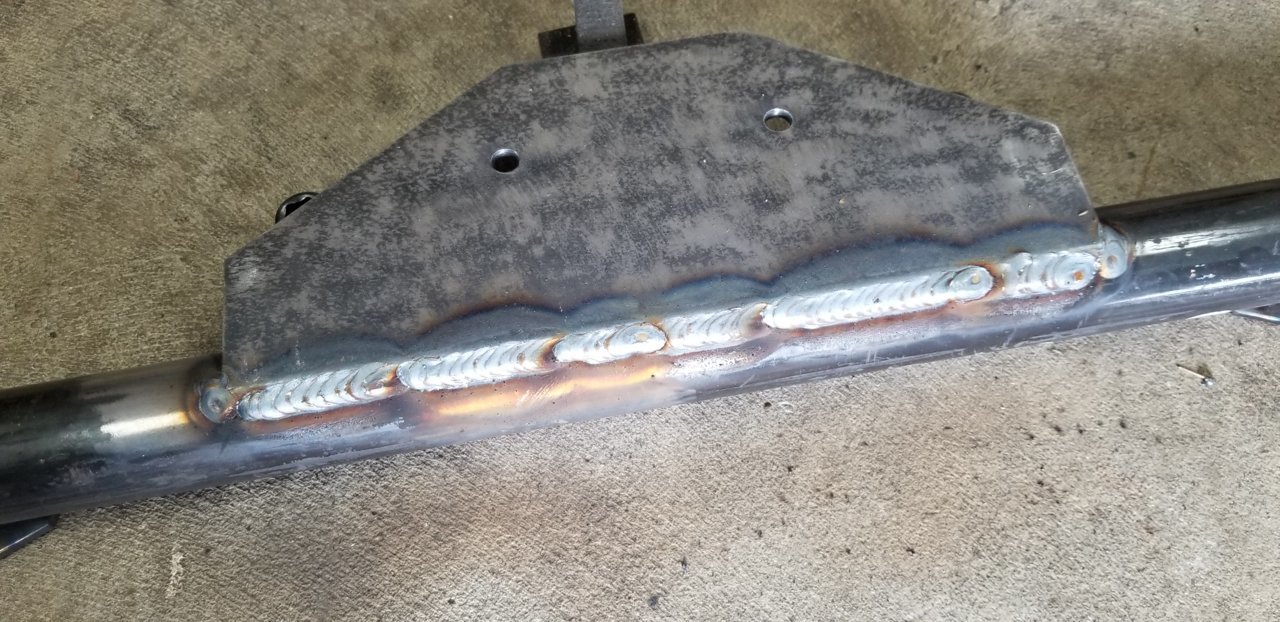

    Here's a few welds from today. 3/16" plate. I figured I would stitch weld it and take my time so the piece doesn't warp.

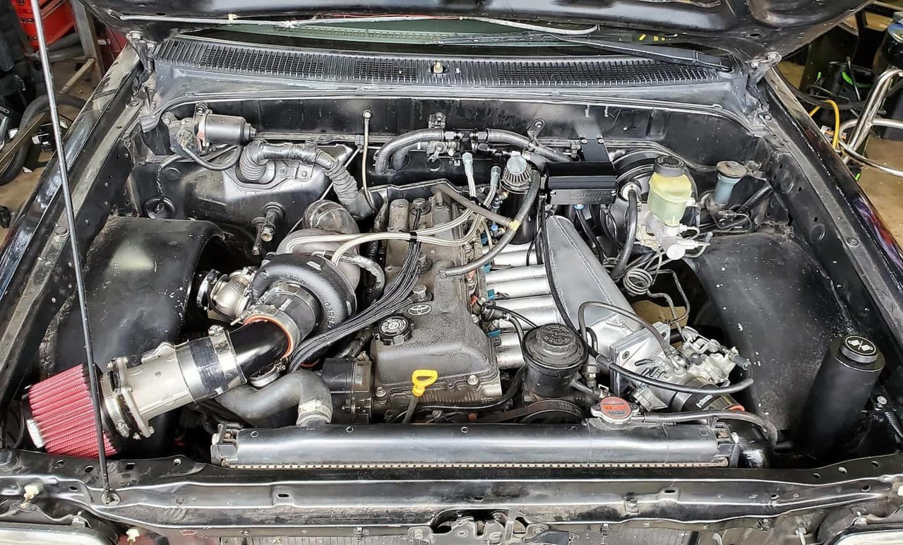

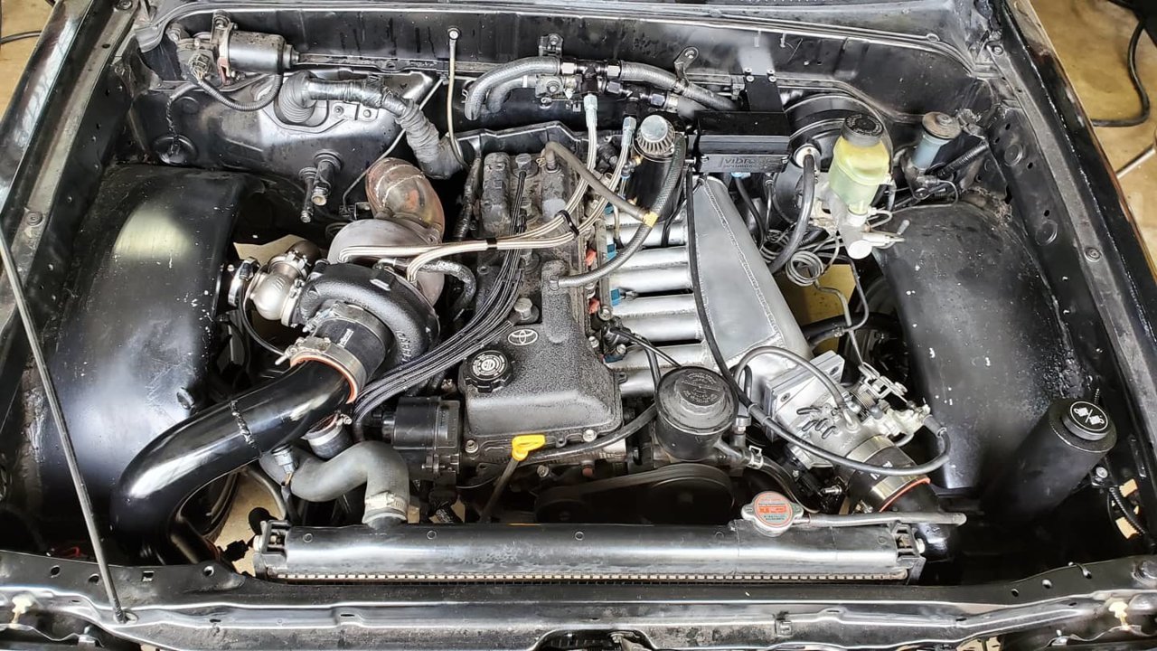

    Forgot to take pics before I painted it. But modified the intake tubing for the front of my turbo. The filter will go down into the wheel well now.
    Old setup

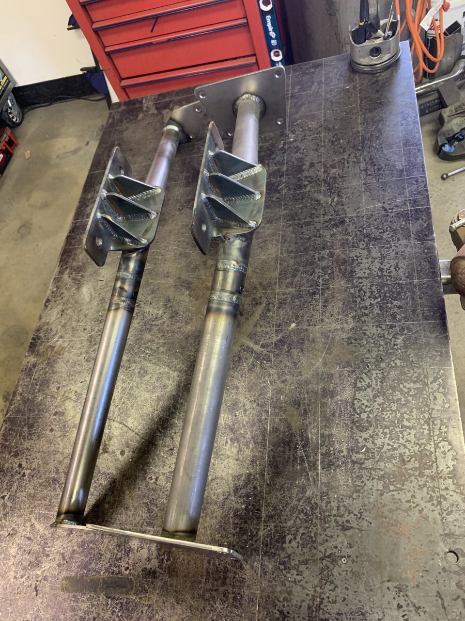

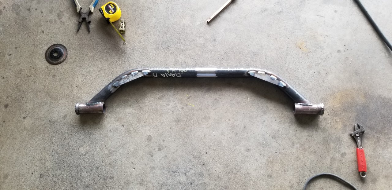

    Started on a different brace for someone's BAMF shackle hangars. I actually marked where to start and stop the stitch welds so it looks more uniformed. Lol
  19. Mar 14, 2020 at 10:25 AM
    glorifiedwelder
    glorifiedwelder IG= @Liquid_Torch
    Feb 14, 2015
    #148647
    3,658
    jason
    Santa Clarita, ca
    double cab trd sport
    That looks awesome. You may want to consider adding a tube clamp onto it. Depending on how new their hangers are they most likely have 1 or 4 protruding threaded inserts on each hanger it makes removal and installation a pain once the hangers have been torqued and suspension installed. The first ones I made didn’t have them and it required a rather large pry bar to install and remove. I use camburg tube adapters. I also mount them as close to center as possible so the crossbars can fit in a smaller box for shipping.

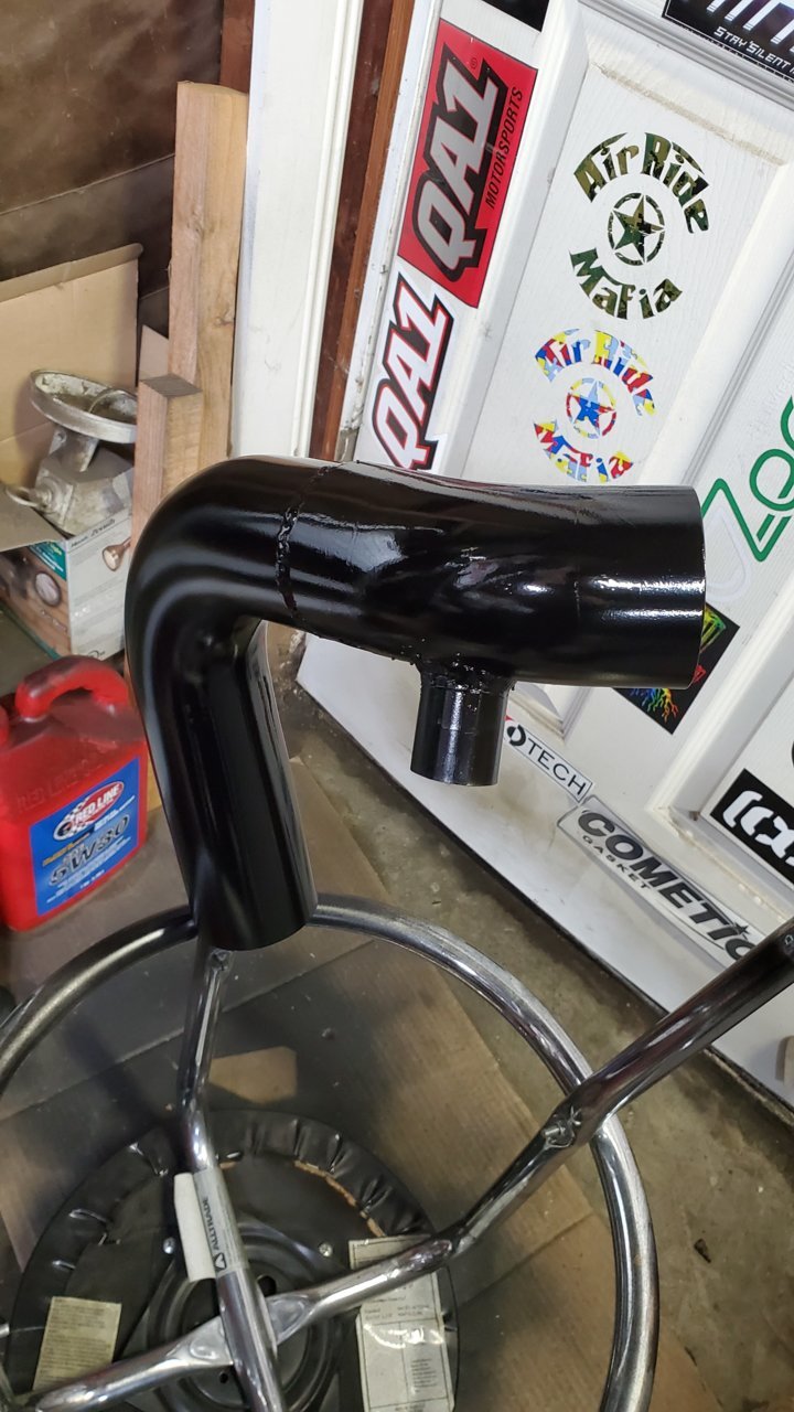

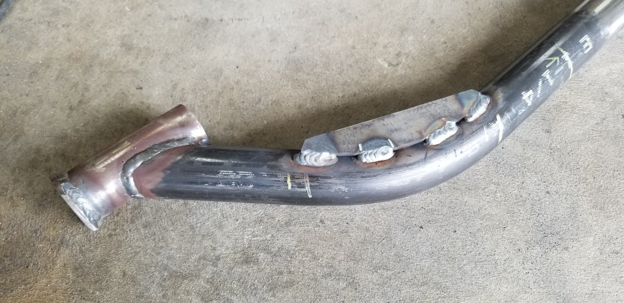

    Installed the new pipe.
    After
    Before
