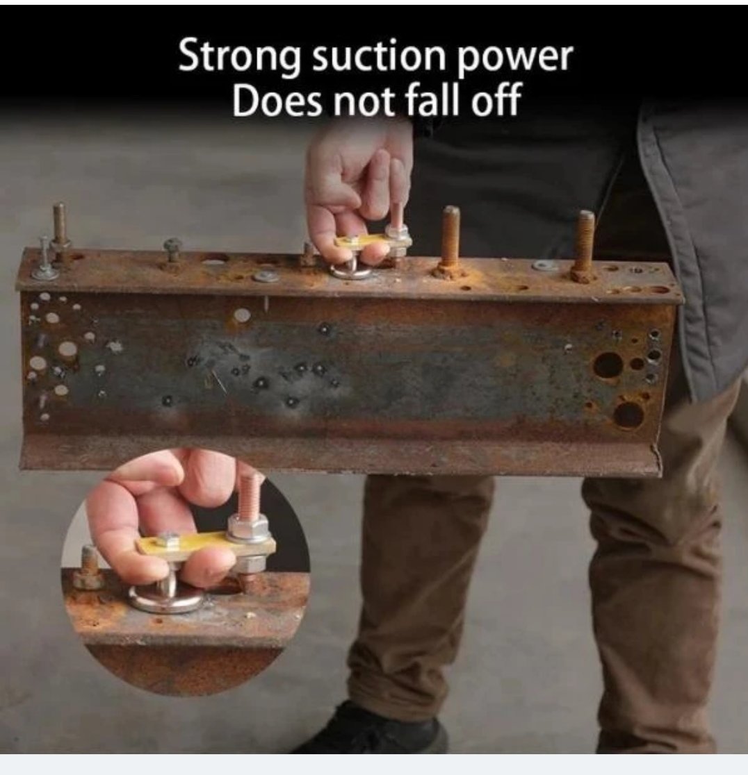

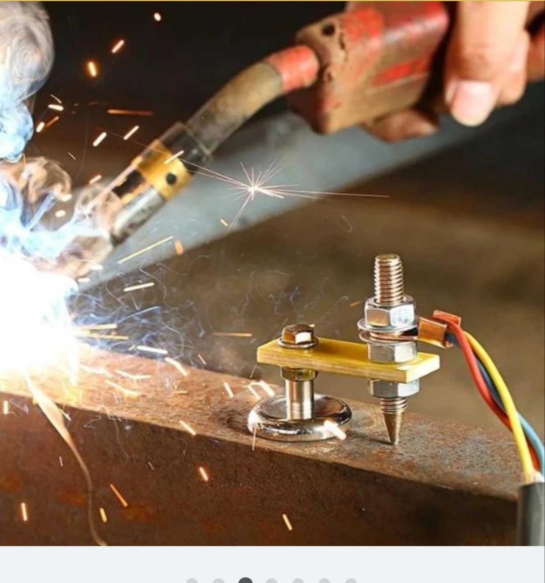

    Thoughts on this?

    So much is wrong with that pic.
    Gauge of wires, lug is not crimped, it looks too light that the weld cable will Pull it off your workpiece

    I call BS.
    I like the idea but it’s built too small. It needs more surface area to conduct current

    I tried that for a while. It works good for flat surfaces. I had to switch back to a clamp to weld pipe. I never put the magnet back on.
    It more designed to stick to fab table that is always grounded.
    I would rather do all my welding on the table, but that really only happens part of the time.

    Yeah that pic is stupid. Still I need something like this, ideas?

    What is it that your having issue with?
    An issue with magnetic mounts is they collect a lot of metal shavings. It becomes a hassle to have to stop and clean often

    Just what are you trying to do?
    You want to have a magnetic work clamp but don`t want to pay for a real one.
    Sadly a few went in the last load of scrap.
    This is more a hype to push on hobby type welders as the best thing to improve your welding.
    How would you even get a good connection on all that rust ? The magnet seems tiny to hold any sort of pressure on the connection with the work piece .
    Then maybe that is not the real work connection for the picture ??

    I don't like magnets anywhere around where I'm welding. As soon as you start grinding anything the sparks/metal all find the magnet and you can't get them off.

    This hangs under our welding table, need to throw it away. Used it three times I think over the past 10 years.

    That's the beauty of the Magswitch tools. Turn the handle and all the shit falls off. They are expensive but you get what you pay for.

    You can clean all that off with compressed air, BTW.

    That's what I do if I need it, I always forget about it and it just hangs out under the table :thumbsup:
